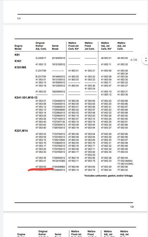

GreenMntRanger 38 #1 Posted November 17, 2019 (edited) Need a source for a carb kit. Any help appreciated Only identifying marks are 470536 with the last number being either 3/8/9 Edited November 17, 2019 by GreenMntRanger Share this post Link to post Share on other sites

GreenMntRanger 38 #3 Posted November 17, 2019 1 hour ago, gwest_ca said: Have the engine model and spec number? See 3 different ones used on the 414-8. Garry Garry, these are the numbers I can get off the carburetor itself 470536 with the last number being 3 (best guess) So 4705363 seems to coincide with this: See attached, red underline Share this post Link to post Share on other sites
gwest_ca-(File Mod) 12,371 #4 Posted November 18, 2019 Looks like the carb kit is 2575701 on page 3.5 of the Kohler carb manual. Notice this manual calls a complete carb a "carb kit". What you want they call a "repair kit". Kohler and Cub Cadet no longer available but others seem to have it https://www.partstree.com/search/?type=part&term=2575701 This number at Napa or a Stens dealer should also be able to supply This is a Stens dealer in Canada https://www.bantasaw.com/catalog/viewproduct.asp?i=&p=1696 Another online source https://www.rcpw.com/search/?quest=2575701 Garry Share this post Link to post Share on other sites
