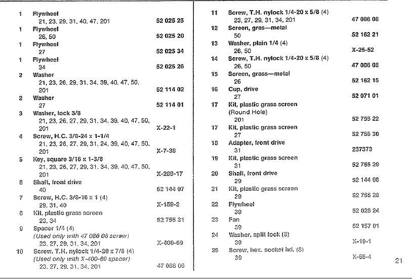

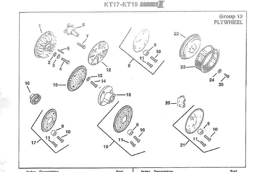

pfrederi 20,538 #2 Posted November 17, 2019 Part numbers for series I and Series II flywheels are different so they are probably not interchangeable. There are no part munbers for magnets they do not seem to be available separately. Looks like you have to find a series 2 wheel. Check the engine spec numbers of yours and the donor. There are 4 different flywheel on Series II. Share this post Link to post Share on other sites

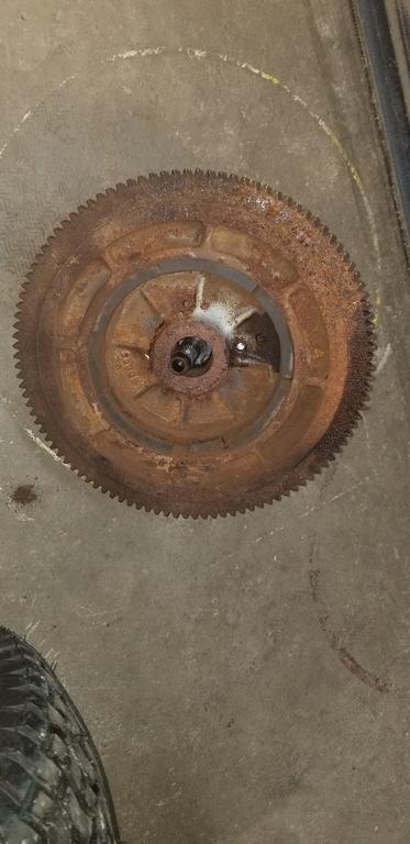

BrianX128 115 #7 Posted November 20, 2019 Well I got the series 1 flywheel today, doesn't fit. The hole isn't big enough to slide onto the shaft far enough. Not even close really. My friend at work got me my old K341 flywheel back, and it has the same hole in the center but different sized magnets that look like they'd be too far from the stator, and the back side of the flywheel has a giant lip that makes it impossible to slide on far enough for the starter to engage and it rubs the cooling fins anyways. So I melted the glue on the series 1 flywheel and pryed those off, only broke 1 but I only needed one of both types so I have some spares. I spaced them good after wire wheeling and cleaning things off good on the mating surfaces of the magnets and the flywheel itself, and jb welded them in place. After it set I realized I used the "quik" jb weld instead of the regular which is only good to 300* supposedly. I know the regular version would have been better to use, but it's too late now and I'd like to think that since the exhaust is no where near the magnets and there should be plenty of air moving around that side of the engine from the fan that it won't end up melting and stuff, but at this point who knows. Then of course 10 minutes later I find the regular jb weld in a different drawer. I guess I'll let it cure until tomorrow and throw everything back together and see what happens. Share this post Link to post Share on other sites

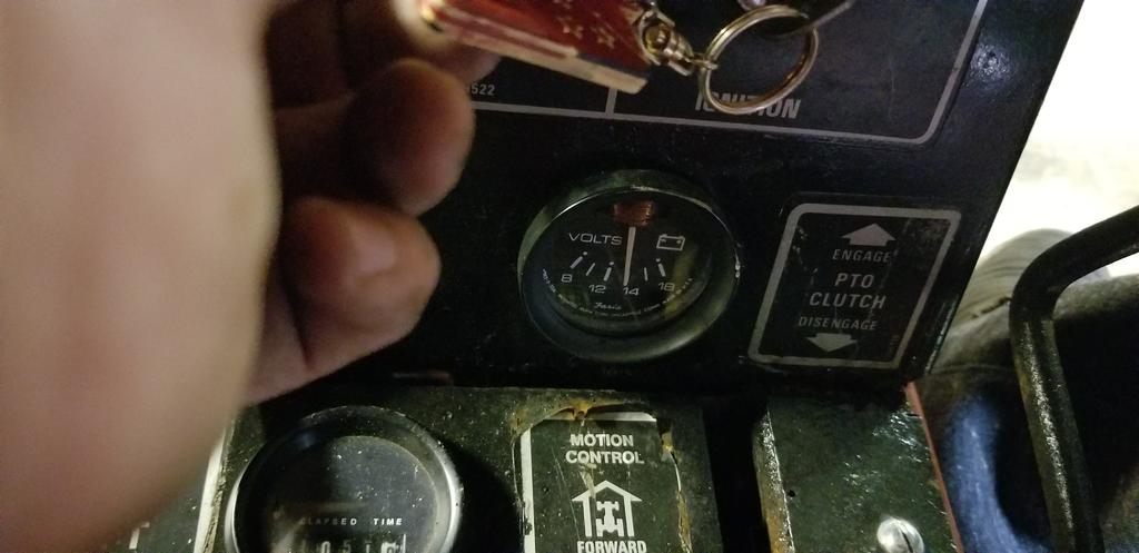

BrianX128 115 #8 Posted November 22, 2019 Unbelievably... Its alive again. Hopefully it stays that way. Drops to 12 volts with the lights on but I got some 9 watt leds to swap out coming from amazon tomorrow so that should help. Share this post Link to post Share on other sites
