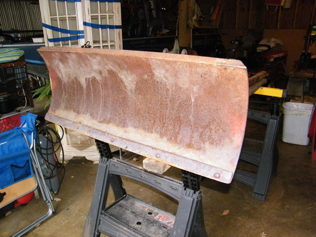

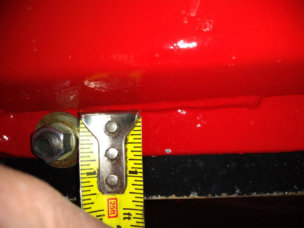

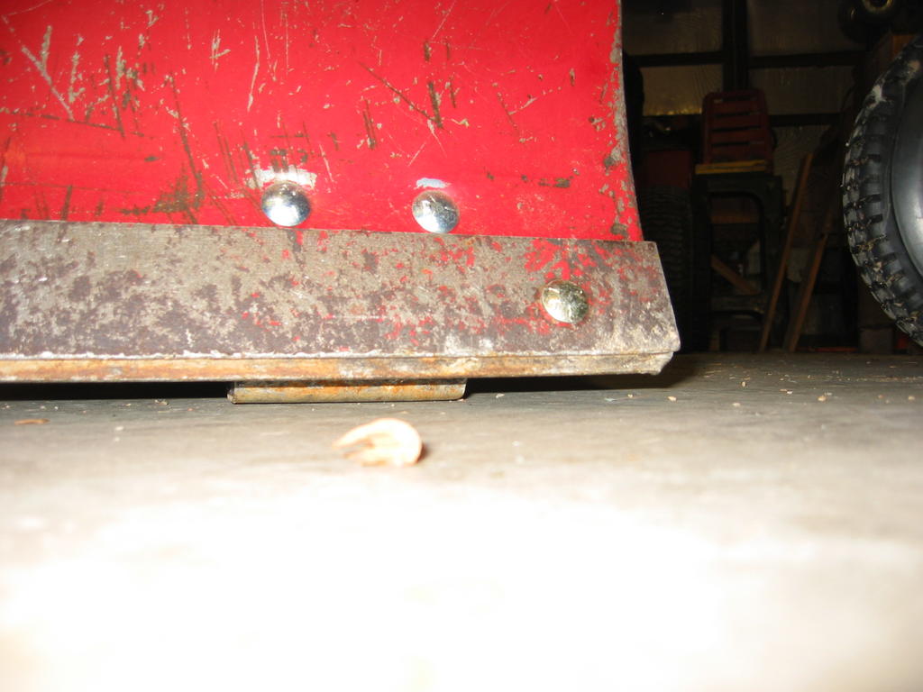

cpete1 332 #1 Posted November 16, 2019 I managed to get a snow blade that had the front edge wore down to halfway through the holes that would normally be the bolt holes for the cutting edge. I'm figuring on cutting the steel of the blade a couple inches up on the blade and putting in new steel. Does anybody have a close-up picture of the bottom edge of the plow. I'm trying to get an idea of how far below the steel channel, the plow steel protrudes. I did a quick fix last year but the temp edge I put on folded back a bit under the blade. 2 Share this post Link to post Share on other sites
ebinmaine 79,524 #2 Posted November 17, 2019 I can get a couple for you tomorrow if no one else pops in before then 1 Share this post Link to post Share on other sites
Achto 32,035 #3 Posted November 17, 2019 3 hours ago, cpete1 said: Does anybody have a close-up picture of the bottom edge of the plow. Mine might have some wear from a PO's neglect but I came up with 3/4". 3 2 Share this post Link to post Share on other sites
cpete1 332 #4 Posted November 17, 2019 Thank you so much Gentlemen, Its been a while since I've posted anything, 'Things Happen" in life . There was so little material left on the bottom edge of my blade , it made it hard to figure what was there originally. And the "fix" that I did didn't really work all that well, at least when I hit the occasional "frozen embedded rock". So-o-o Now I got something to shoot for. Thank You again. I always said this was and still is one of the lousiest, rotten, mean, nasty forums that I ever got involved with and can't imagine how people can be that mean!!!! Thank You Chris 2 2 Share this post Link to post Share on other sites

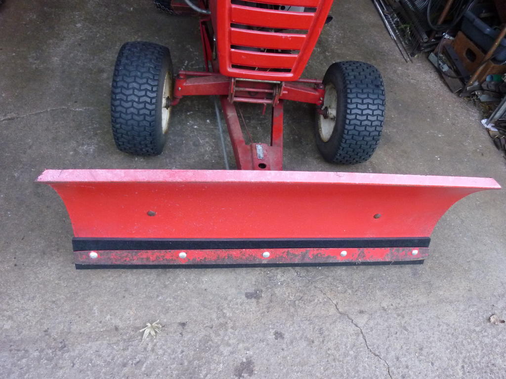

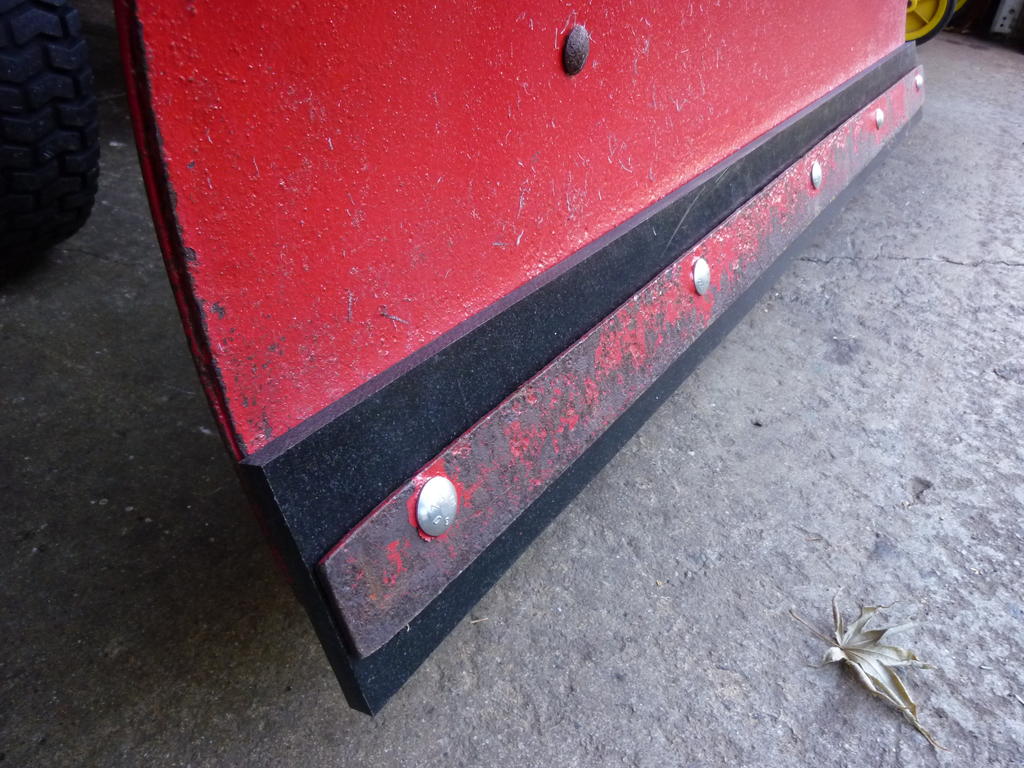

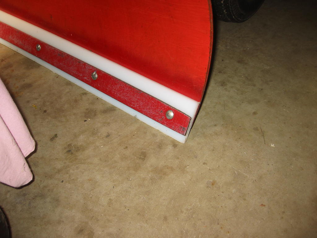

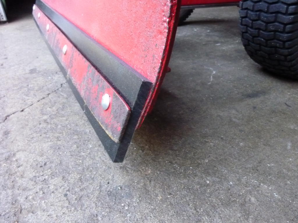

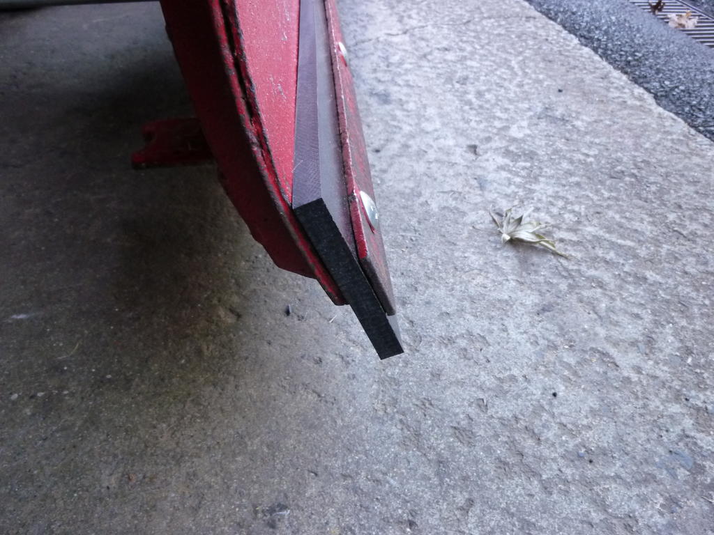

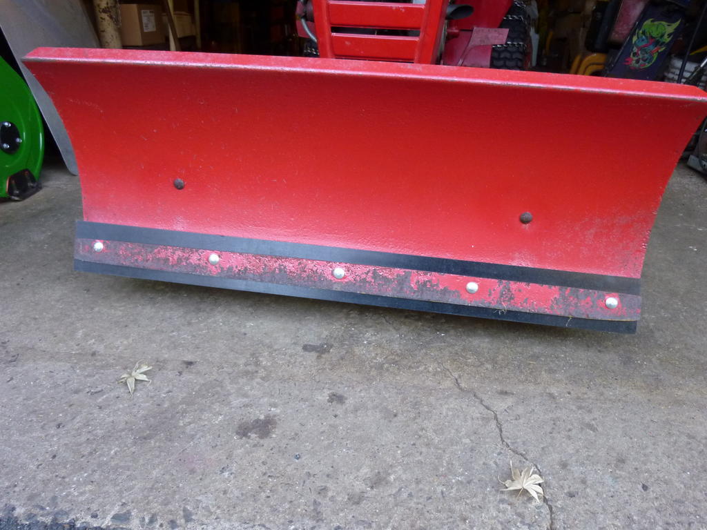

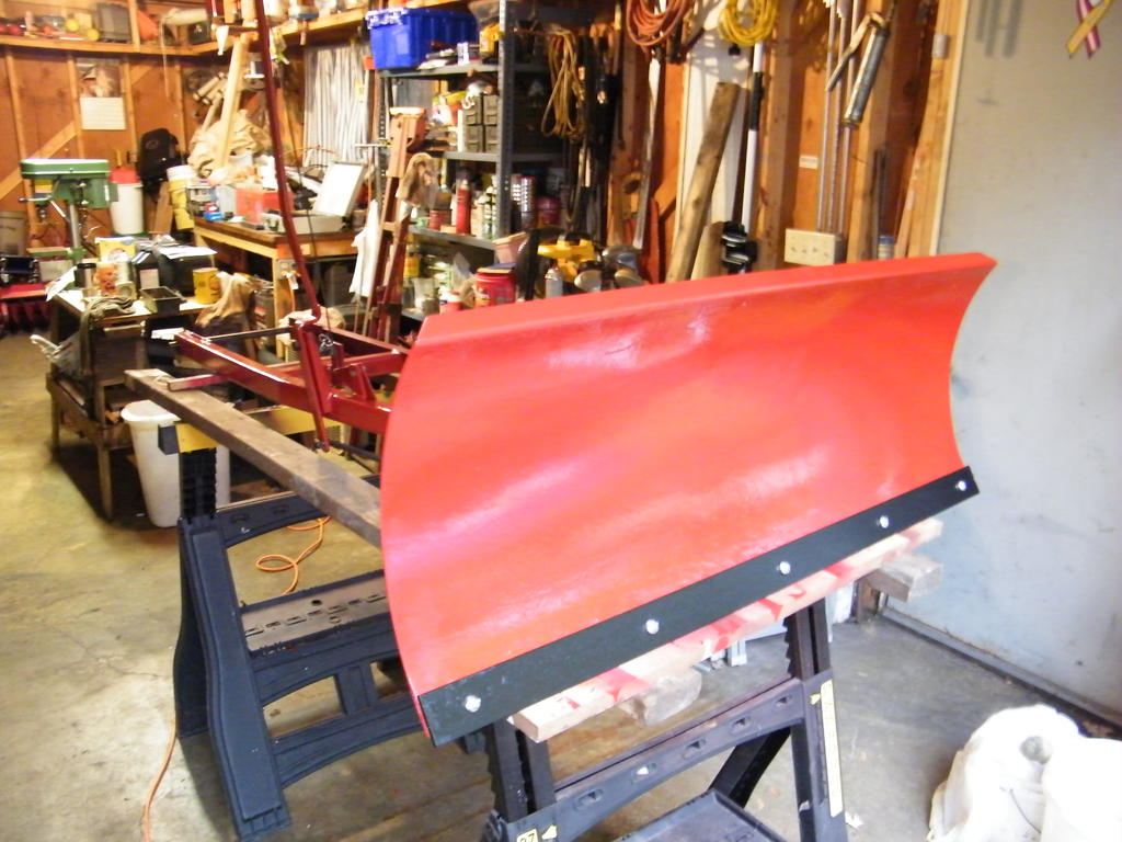

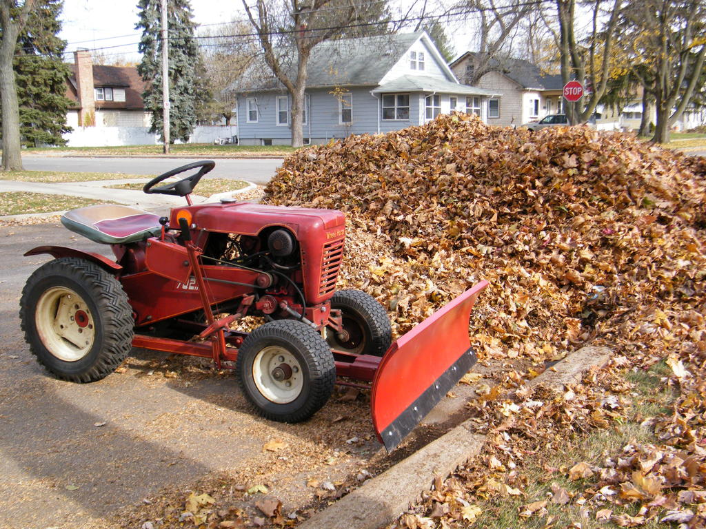

Rob R 989 #8 Posted November 17, 2019 Went Poly on mine and love it. Drilling holes a cinch and works great, can be rotated once, used the existing worn out blade as a guide and brace...... 7 4 1 Share this post Link to post Share on other sites
pfrederi 20,828 #9 Posted November 17, 2019 Did that for a plastic edge and a replacement steel one. i use the old edge that has the square holes you need to anchor the carriage bolts. Easier than trying to make square holes. 3 1 1 Share this post Link to post Share on other sites

cpete1 332 #13 Posted November 17, 2019 Wallfish, Last year I welded a piece of steel onto what was left of the plow. As you say, it was mild steel from the local Ace Hrdware stor. It was 1-1/4 " high. Then I bolted another piece of steel (2") to it as a cutting edge but using skids on the plow. Wasn't exactly the prettiest job but it worked, at least for a while. Your concerns (2 cents worth) are spot on. I'm thinking the 1-1/4 stuff actually acted like lever and folded the whole edge back. I just took everything apart and am rewelding the scabbed on piece. Then the thought is to cut the bottom off so its more inline with the picture Achto posted. I was going to go with another piece of mild steel (like stevasaurus) but now am inclined to look for something a tad thicker, taller and harder. The skids are supposed to save the edge and yes, I already added some meat to the bottom of them. When I first worked on the plow, I wasn't sure it would work all that well. I couldn't get over how much snow it could move so now I gotta pretty it up some. Like I said, Smart people here and I appreciate the insight. But I can't say that in public. It gives me Hives... Thanks, Chris 1 1 Share this post Link to post Share on other sites

Rob R 989 #15 Posted November 18, 2019 (edited) If you look carefully on my 3rd picture I made Skids for this set-up (ps to make them last I well used mower blades welded to the bottom) the blade you see is on it's third year and I have a 100 foot driveway. So no issues Edited November 18, 2019 by Rob R 1 Share this post Link to post Share on other sites
cpete1 332 #16 Posted November 20, 2019 Very Nice Rob, Didn't notice the first time through. Chris 1 Share this post Link to post Share on other sites

Tach-a-matic 357 #18 Posted November 29, 2019 RobR: Where is the black poly piece being sourced from. It looks snazzy! Share this post Link to post Share on other sites
Rob R 989 #19 Posted November 29, 2019 4 hours ago, Tach-a-matic said: RobR: Where is the black poly piece being sourced from. It looks snazzy! Got a 4 foot piece off of e-bay. Share this post Link to post Share on other sites
