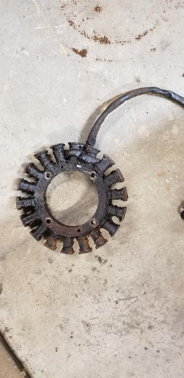

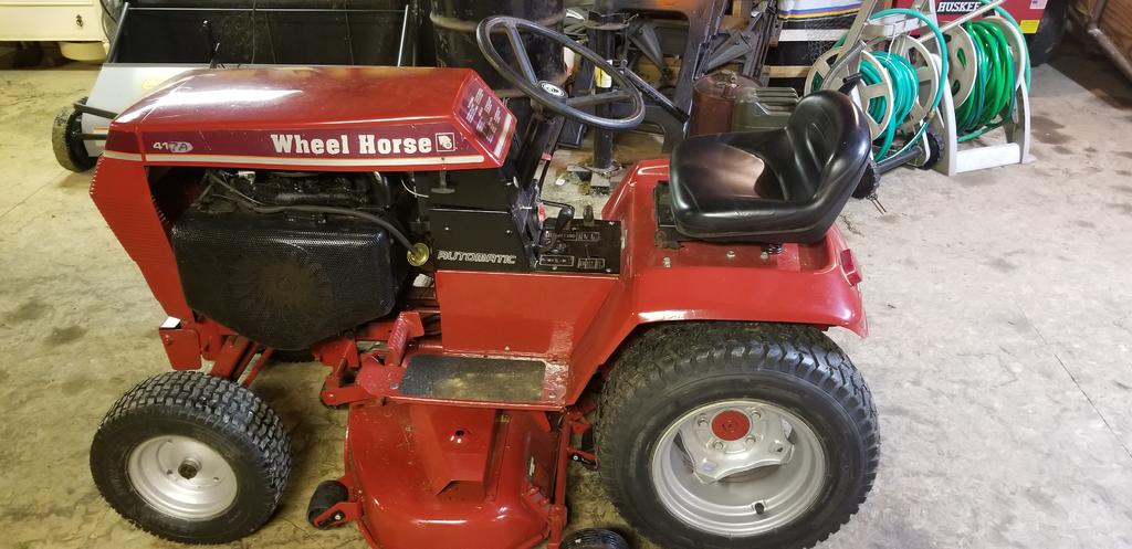

BrianX128 115 #1 Posted November 14, 2019 I've got a KT17 Series 2 in a 417A that isn't charging, stator is bad and I'm going to replace the regulator just so I know everything is new, I have a flywheel puller but I was wondering what all tricks I may need to know to get the flywheel off. I'm guessing I remove the grass gaurd, maybe the metal directly behind it and then the main nut for the flywheel and use a puller and I'll be where I need to go? Just wondering if there's any special procedure to getting the main nut on the flywheel loose or any tips before I break stuff. Share this post Link to post Share on other sites

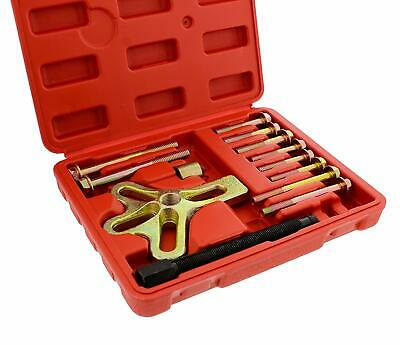

pacer 3,180 #4 Posted November 14, 2019 Yep, impact is definitely the best bet - and yesey on the leftey.. This is the puller type you'll need. More often than not they can be stubborn to 'pop' off. When youve got a lot of force on it an it still wont turn loose, whack the end of the puller with a hammer - the shock will usually do it. 2 Share this post Link to post Share on other sites
BrianX128 115 #5 Posted November 14, 2019 Ok sounds good, I think that's actually the one I have or close to it. Mine just has a left side with more screws. 1 Share this post Link to post Share on other sites

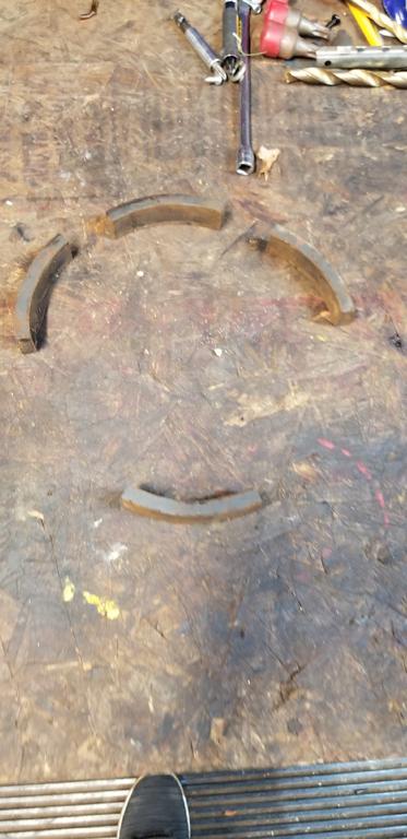

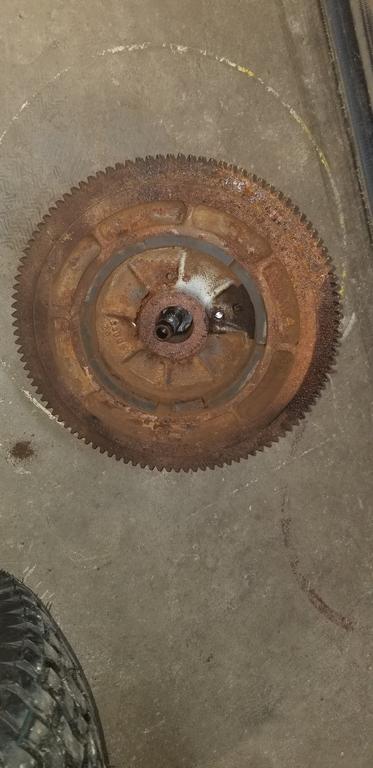

BrianX128 115 #10 Posted November 15, 2019 Well everything still tested as garbage so I ripped in tonight. Things came apart pretty easy. Flywheel popped off with a good smack of a hammer and the puller, but unfortunately for me my magnets weren't where they are in this picture, they were all sticking to the stator and one of them is chipped and cracked pretty good. The stator looked like junk too. I just replaced it while I was in there. I got the new one on and now I can't remember if it sits flush around the metal base or if it stuck out 1/16 of an inch from the metal your sliding it back on to. Anyways, are the magnets for this flywheel supposed to be glued to the medal or are they just held there magnetically and it's supposed to pull stronger to the flywheel than the stator or use centripical force to stay on the flywheel and not get pulled to the stator? I just don't really know whether to order another flywheel from somewhere online (ebay etc) or if that 1 magnet being broke is a death sentence for this flywheel.. I'm cool with buying another one if it is, I'm learning some as I go and got to clean the inside of the sheet metal out real nice which as you can tell it needed it. Thanks in advance. Share this post Link to post Share on other sites
pfrederi 20,892 #11 Posted November 16, 2019 Magnets are glued to the fly wheel and have to be spaced and oriented (magnets have poles) correctly. There may be a posting on here about the orientation of the magnet poles. will have to look . Share this post Link to post Share on other sites
BrianX128 115 #12 Posted November 16, 2019 1 minute ago, pfrederi said: Magnets are glued to the fly wheel and have to be spaced and oriented (magnets have poles) correctly. There may be a posting on here about the orientation of the magnet poles. will have to look . I just found that about the north south north and south north south I have 2 of each that are still good, just need one more of each and I could jb weld them back on I believe. Share this post Link to post Share on other sites
pfrederi 20,892 #13 Posted November 16, 2019 JB weld would work. Share this post Link to post Share on other sites
BrianX128 115 #14 Posted November 16, 2019 Now the fun of finding one more of each type. Worst part is I gave an old dead k series 14 horse engine that probably had the right magnets in it and I know he hasn't done anything with it but I don't want to ask for it back to steal the magnets so off to ebay I suppose. Share this post Link to post Share on other sites
