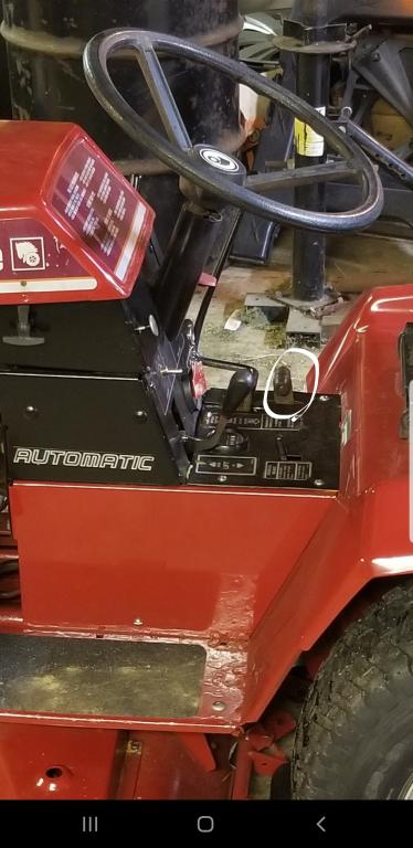

BrianX128 115 #51 Posted November 24, 2019 Yep, thanks though I appreciate it. As long as these magnets stay jb welded in place I'm good to go. Put new led headlights in it as well. The only issue I now have with this thing is this circles part vibrates like crazy metal on metal when the tractor is at wide open throttle. I need to get something around the side of it because I keep thinking I'm hearing an engine noise until I hold that thing and it goes away. 1 Share this post Link to post Share on other sites
Ed Kennell 46,174 #52 Posted November 24, 2019 Yeah, that lever rattle is a common problem. I wrap mine with rubber. Share this post Link to post Share on other sites
953 nut 66,439 #53 Posted November 24, 2019 4 hours ago, BrianX128 said: this thing is this circles part vibrates like crazy metal on metal when the tractor is at wide open throttle The right side foot rest may have been bumped in causing the belt cover to be in contact with the belt tensioner pulley. I ran into this (pun intended) once. Having just bumped a power pole when the problem started I figured it out promptly. 1 Share this post Link to post Share on other sites
