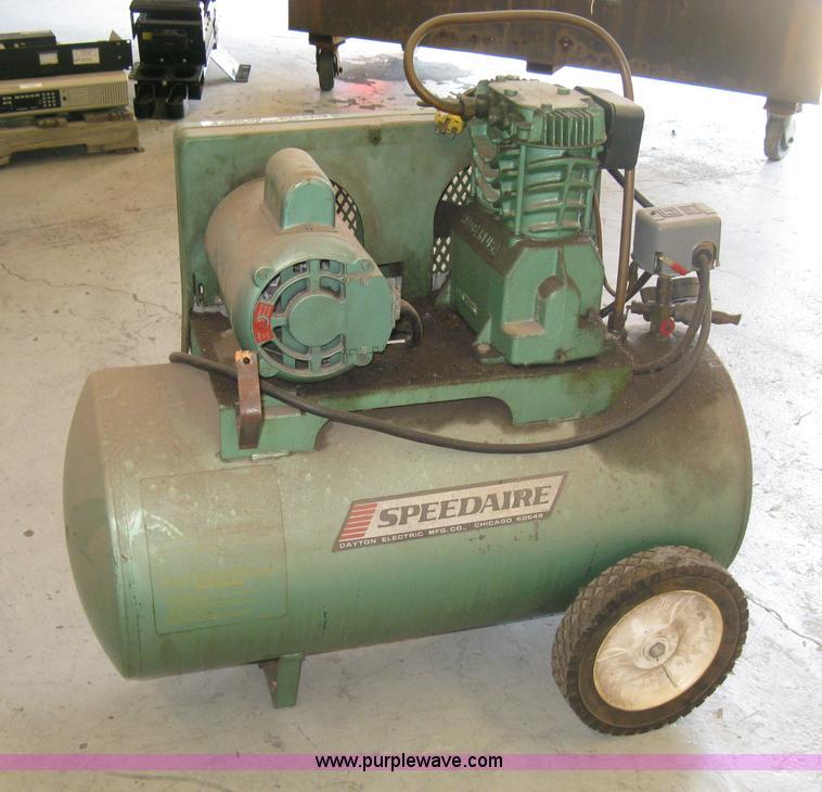

tom2p 2,394 #8 Posted November 12, 2019 have an old speed speedaire compressor - similar to that compressor (similar to pic below) I think mine has 30 gallon tank have not used it for years - but still at my parents house ran a number of air tools with it - primarily body tools and a spray gun the compressor could also be wired for 110 or 220 - but it too often tripped circuit breaker when wired for 110 - so my dad installed a 220 line and changed the compressor (can't recall what he did) never an issue after that ( he preferred 220 regardless ) Share this post Link to post Share on other sites
roadapples 6,985 #9 Posted November 12, 2019 59 minutes ago, tom2p said: have an old speed speedaire compressor - similar to that compressor (similar to pic below) I think mine has 30 gallon tank have not used it for years - but still at my parents house ran a number of air tools with it - primarily body tools and a spray gun the compressor could also be wired for 110 or 220 - but it too often tripped circuit breaker when wired for 110 - so my dad installed a 220 line and changed the compressor (can't recall what he did) never an issue after that ( he preferred 220 regardless ) Looks like my Sears compressor from the 70's Share this post Link to post Share on other sites
