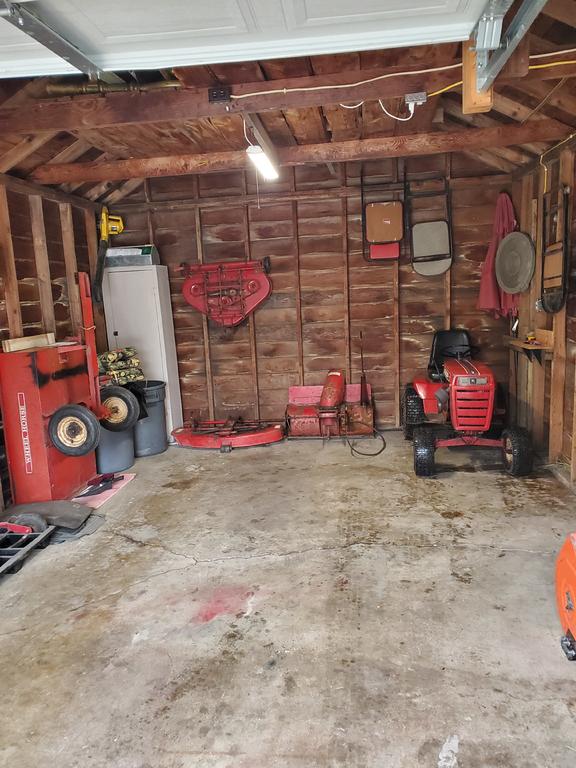

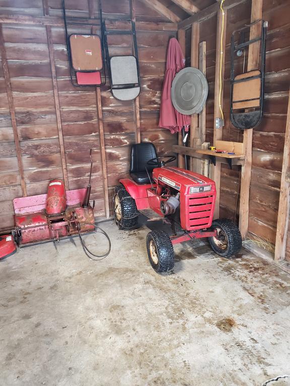

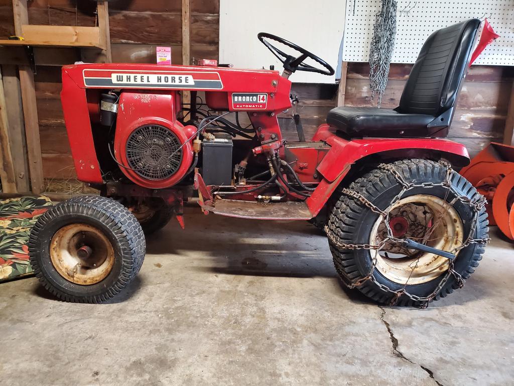

12Horse Paladin 1,038 #14 Posted November 22, 2019 7 hours ago, paxz71usa said: Hi Paladin, Have you gotten your tractor yet and had a chance to look over the PTO issue. I'd like to hear how your making out with it. Pictures are always nice too! Gary I did😊 Havent gotten to the PTO, yet...my skills n workspace are limited, so i e been tackling smaller stuff first, and gathering info; just trying to straighten out PO's 'fixes'; posted a few threads on that with pics. But since you asked, here isa few more.😊 I know they arent a tion shots; just a man's Horse at rest... but he needs a good going over; gonna take me a bit to get it all done/sorted. But i intend to 😊 Have a great day! 3 2 Share this post Link to post Share on other sites
tom2p 2,396 #15 Posted November 22, 2019 workspace limited ? sheesh I can barely dream about a spacious area like that ! 3 Share this post Link to post Share on other sites
JCM 11,451 #16 Posted November 22, 2019 @12Horse Paladin Congrats on your new to you WH tractor, hope you get things sorted out, take your time and ask questions on here, many talented members here. On another note, enjoy your awesome Garage space because in time there may not be enough room for possibly more Tractors, attachments and accessories. 1 1 Share this post Link to post Share on other sites
Pullstart 71,520 #17 Posted November 22, 2019 That is a pretty cool work shop! I love the warmness of the wood! 1 Share this post Link to post Share on other sites
12Horse Paladin 1,038 #18 Posted November 22, 2019 (edited) Lol... Wait...you guys dont understand... Thats not my workshop...thats my garage, lol. Once i park my jeep cherokee in there... Well, space is limited, trust me...🤣 I live on a pretty good sized lot tho, so by spring hope to have the $$$ saved to add another building/leanto, or...something... Edited November 22, 2019 by 12Horse Paladin 1 1 Share this post Link to post Share on other sites
paxz71usa 173 #19 Posted November 22, 2019 (edited) Keep the Horse in and the Jeep out!!! Looks Good! Gary Edited November 22, 2019 by paxz71usa 2 Share this post Link to post Share on other sites
