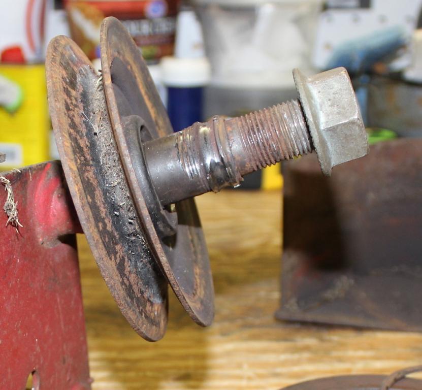

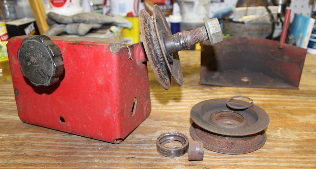

Mr Magoo 226 #178 Posted January 3, 2020 So here are a couple of pictures of the mule drive. I'm hoping there is a chance that it did not eat into the shaft. I can't get the inner race off yet. Soaking it in some PB Blaster and tomorrow I will put some heat on it. It looks like it is pretty close. Hopefully it just ate into the race and the spacer. The flat pulley does have some uneven wear to one side, but do you think it would still be usable? Had a heck of a time getting the outer race and snap ring out. It had eaten into both. Share this post Link to post Share on other sites
ZXT 2,402 #179 Posted January 3, 2020 1 hour ago, Mr Magoo said: So I piddled around on my “good” C-120 today. Took the front wheels off to put new bearings in and figured out that I only ordered half as many bearings as I need. One question I have concerning that is that my front wheels are held on to the spindle by a cotter pin. I thought that it would have a bolt threaded into the end of the spindle. The other great thing I found today is that my mule drive may be trashed. The bearing in the flat pulley was destroyed and seriously messed up the shaft. I pulled the mule drive off of my other C-120 and it seems to be okay other than the fact that the belt has eaten into the cover pretty good for some reason. Unfortunately due to the issues that both of the drives have, neither one of the belts are as good as I had hoped and I will need to find a new one. I still need to figure out the correct length. I measured it kind of quickly and got around 103.75”. That was around the flat side of the belt. A 42" SD deck should use a 92-6991 belt. Share this post Link to post Share on other sites
ZXT 2,402 #180 Posted January 3, 2020 (edited) 15 minutes ago, Mr Magoo said: So here are a couple of pictures of the mule drive. I'm hoping there is a chance that it did not eat into the shaft. I can't get the inner race off yet. Soaking it in some PB Blaster and tomorrow I will put some heat on it. It looks like it is pretty close. Hopefully it just ate into the race and the spacer. The flat pulley does have some uneven wear to one side, but do you think it would still be usable? Had a heck of a time getting the outer race and snap ring out. It had eaten into both. - You might get lucky and there be no damage, but if there is, don't fret.. Mule drives are cheap - I'm sure someone on here could set you up. Edited January 3, 2020 by ZXT 1 Share this post Link to post Share on other sites

Mr Magoo 226 #185 Posted January 3, 2020 Can someone point me to where I can find a parts drawing of the mule drive? I thought I had found all this stuff, but that isn't in any of the exploded parts break downs I have. Share this post Link to post Share on other sites
gwest_ca-(File Mod) 12,535 #186 Posted January 3, 2020 Front idler assemblies are illustrated in the mower deck parts lists Garry 1 Share this post Link to post Share on other sites

Mr Magoo 226 #189 Posted January 3, 2020 4 hours ago, gwest_ca said: Front idler assemblies are illustrated in the mower deck parts lists Garry Thank you Garry. Now I know where to look. So, the mule drive I have differs from this one in that the pulleys have the replaceable bearings with the snap ring. This is what is shown in the 1975 info. I will have to search and see if those parts are available. I am guessing that I can just put the newer style pulleys on this. One thing I will definitely need are new spacers. Both of mine are chewed up. Here is what mine looks like. Share this post Link to post Share on other sites
Mr Magoo 226 #190 Posted January 3, 2020 More good news today. Decided to work on my front wheels. I noticed that when I took them off that the inside bearings just fell out. Sure enough, both rims are badly wallowed out from the PO using it with bad bearings. So, looks like I will also be on the hunt for a couple of new wheels. I did get the inner bearing race off of the mule drive and the shaft has a few nicks in it. One of them will be covered by the spacer and the other will have a bit under the bearing. It is about 1/4" long and about 3/32" wide. I don't think it would hurt the bearing, but I may just TIG fill them in with my TIG welder. Share this post Link to post Share on other sites
