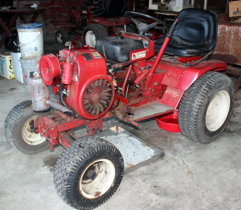

Mr Magoo 226 #126 Posted December 28, 2019 Success! I finally got it running today. Yesterday I pulled off the shroud, found the timing marks, wire brushed them, and marked them with a yellow paint marker. I also installed a new set of points and a condenser. I would have tried to fire it up, but had no battery with me. Today I got back at it. I pulled the deck out from under it and removed the hood. Those two things make it a lot easier to work on it. Dropped the battery in it and it fired right up. For the first start in at least 10 years it ran great I think. Not smoking at all. I have a few sputters every now and then. Not sure why. I still need to replace the spark plug wire for sure and I would also like to replace both batter cables as well as the one leading from the solenoid to starter. After letting it get hot I changed the oil twice. Even though the tires are pretty sketchy, I had to drop it in drive to check out the hydro. It worked great. Forwards and back no problem. I did not have the throttle all the way open and it shocked me just how quick it would move. I do wonder about the engine RPM's. I opened it up almost all the way and it sounded like it was really screaming. I would love to find a way to check the RPM's to make sure it is not running too fast. Looking into that. I will be back to work in a couple of weeks and hopefully I can get some tires then. I do noticed that there is play in the front wheels where they attach on to the spindles. I'm guessing that maybe the wheel bearings need replaced. Thanks for all the help everyone! 5 2 1 Share this post Link to post Share on other sites
The Tuul Crib 7,354 #127 Posted December 28, 2019 Ain't nothing like hearing an old Kohler fire up! Good satisfaction isn't it! 3 Share this post Link to post Share on other sites
ZXT 2,402 #128 Posted December 28, 2019 EXCELLENT! I missed that you wound up with all three of them.. I wish there was a way to make the site notify you when someone replies to a topic, even if they don't quote you. I forget about threads I comment on all of the time. Glad that you got one of them running and that there is no smoke. Hopefully the other two behave the same way! What's so sketchy about the tires? If they hold air, they're fine. If they don't, put tubes in them. It's not like you're running down the highway.. You're moving <7 MPH. One of mine still has its original tires from 1970. I assume you got a good deal on them, since you only intended to buy one? That's awesome! 1 Share this post Link to post Share on other sites

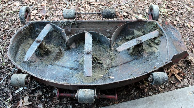

Mr Magoo 226 #130 Posted December 28, 2019 (edited) Here is the underside of the deck. I'm assuming this is a 42". Center to center on the outside spindles is 27". All three of the blades are 13.75" long. I found some old ones in the barn the same length. They have a single round hole in them. Does that sound right? Edited December 28, 2019 by Mr Magoo 2 Share this post Link to post Share on other sites

gwest_ca-(File Mod) 12,535 #138 Posted December 28, 2019 16 minutes ago, Mr Magoo said: Where on the mower deck would some sort of I.D. # be? I did not see anything, but I need to clean it better. The ID moved around over the years. Many had a plate secured by a bolt that mounted the hardware on the rear of the deck. Here is a list of all the decks in the order they were produced. The single 3/4" blade center hole helps unless an earlier deck was upgraded to a newer design spindle assembly. Mower DNA 1966-1967 model RL-426 replaced by 1968 model 5-1421 1969 model 5-1422 1970 model 5-1423 1971 model 5-1000 1971-1972 model 5-1001 1973-1974 model 5-1010 1975 model 5-1011 1975 model 5-1012 1976 model 65-42MS01 1976 model 65-42MS02 1977 model 75-42MS01 - These 42" side discharge decks all use blades with 5/8" x 3/4" double-D center hole unless the spindles have been upgraded (Do not have operator manual) -------------------------------------------------------------------------------------------------------------------------------------------------------------------------------------------------------- These decks all use blades with a 3/4" center hole. 1977 model 75-42MS02 replaced by (Do not have operator manual) 1978 model 85-42MS01 (Do not have operator manual) 1979 model 95-42MS00 (Do not have operator manual) 1979 model 95-42MS01 (Do not have operator manual) 1980 model 05-42MS01 (Have operator manual) 1981-1983 model 05-42MS02 1984 model 05-42MS03 - Last year for bearings with 3/4" ID 1985 model 05-42MS04 - First year for bearings with 17mm ID unless older spindles were updated. 1986-1988 model 05-42MS05 1989 model 15-42SC01 1990 model 15-42SC02 1990-1992 model 15-42SC03 1993-2007 and 2009-2012 model 78345 - These decks all use blades with a 3/4" center hole. Note - 17mm is .669" Garry 1 Share this post Link to post Share on other sites
Mr Magoo 226 #139 Posted December 28, 2019 What I found in the Toro chart showed the 1976 model 65-42MS01, but not the 1976 model 65-42MS02. The 1976 model 65-42MS01 calls out a 100200 blade kit which has the 3 hole pattern with the obround hole in the center. I will have to try and get a blade off to see what is on there. So possibly the spindles were changed out to use the single hole blades instead of the obround. Share this post Link to post Share on other sites

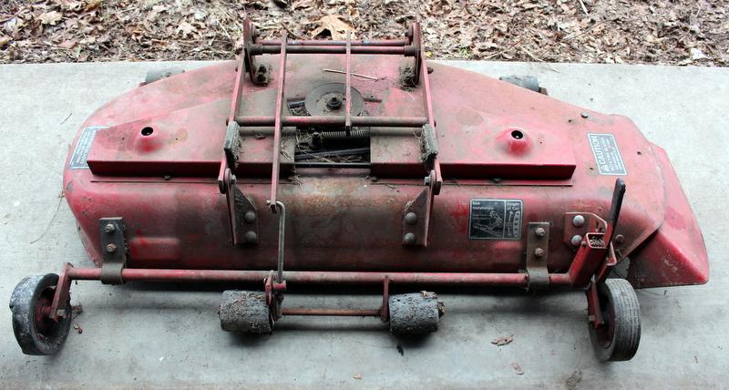

Mr Magoo 226 #140 Posted December 29, 2019 This is the top side of my deck. I am still not sure what model it is. I did not find any markings or tags on the deck. I do not see any pictures of one with a chute like this one has. The pictures of the 65-42MS01 show a much different style chute. I welcome your input. I did find a number on the spindle drive belt. It is a Wheel Horse belt #6738 and it looks like it is in good condition. It looks like that belt was used starting in 1965 and for quite a few years after on other 42" decks. I could not read a number on the mule drive belt. I could barely make out a Made in Mexico and that was about it. It really looks to be in good condition and I will leave it alone. The blades are really in great shape. It looks like they must have been put on right before it was parked. The spindles also feel nice and tight and should be good to go. 1 Share this post Link to post Share on other sites
tom2p 2,396 #141 Posted December 29, 2019 42 minutes ago, Mr Magoo said: This is the top side of my deck. I am still not sure what model it is. I did not find any markings or tags on the deck. I do not see any pictures of one with a chute like this one has. The pictures of the 65-42MS01 show a much different style chute. I welcome your input. I did find a number on the spindle drive belt. It is a Wheel Horse belt #6738 and it looks like it is in good condition. It looks like that belt was used starting in 1965 and for quite a few years after on other 42" decks. I could not read a number on the mule drive belt. I could barely make out a Made in Mexico and that was about it. It really looks to be in good condition and I will leave it alone. The blades are really in great shape. It looks like they must have been put on right before it was parked. The spindles also feel nice and tight and should be good to go. looks a lot like a more recent deck maybe model 78345 (listed above by Garry) 1 Share this post Link to post Share on other sites
gwest_ca-(File Mod) 12,535 #142 Posted December 29, 2019 Many parts lists are shared by the 42" and 48" decks, The illustrations are usually of the 48" deck with the reinforcement plate so the 42" is not illustrated. Most decals have their part number on them. Takes a lot of looking but they will narrow down the possibilities. Large blade nut is used with 3/4" hole in blade. The L-shaped adjustment bolt at the rear went from 3/8" to 1/2" at some point. Garry 1 Share this post Link to post Share on other sites
