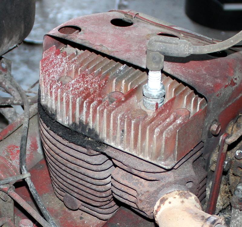

Mr Magoo 226 #123 Posted December 22, 2019 Looking over some pictures today and it sure looks like my #2 may have a bad head gasket. 1 Share this post Link to post Share on other sites
ebinmaine 79,688 #124 Posted December 22, 2019 41 minutes ago, Mr Magoo said: bad head gasket. I'd agree with that. Luckily it's an easy fix. Take off stuff.. Use sandpaper to straighten head. Reinstall stuff.. Done. 1 Share this post Link to post Share on other sites
