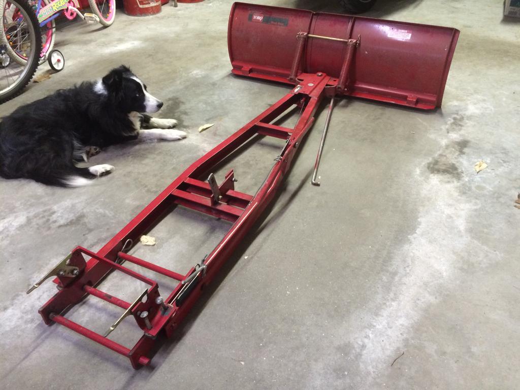

Ben Frenette 1 #5 Posted November 11, 2019 I have this one that I would trade to have one that fits on my 1999 lxi. 1 Share this post Link to post Share on other sites
boss427@live.com 9 #6 Posted December 23, 2022 not like it sets it will need a idler arm or sabilizer that fits in the pully box mounting front braket and the angle plow ajusting arm will hit the foot board 1 Share this post Link to post Share on other sites
