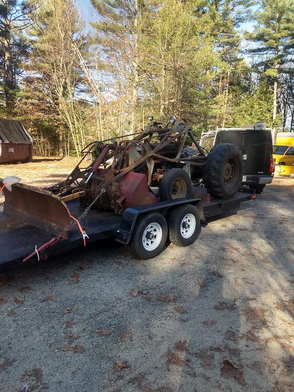

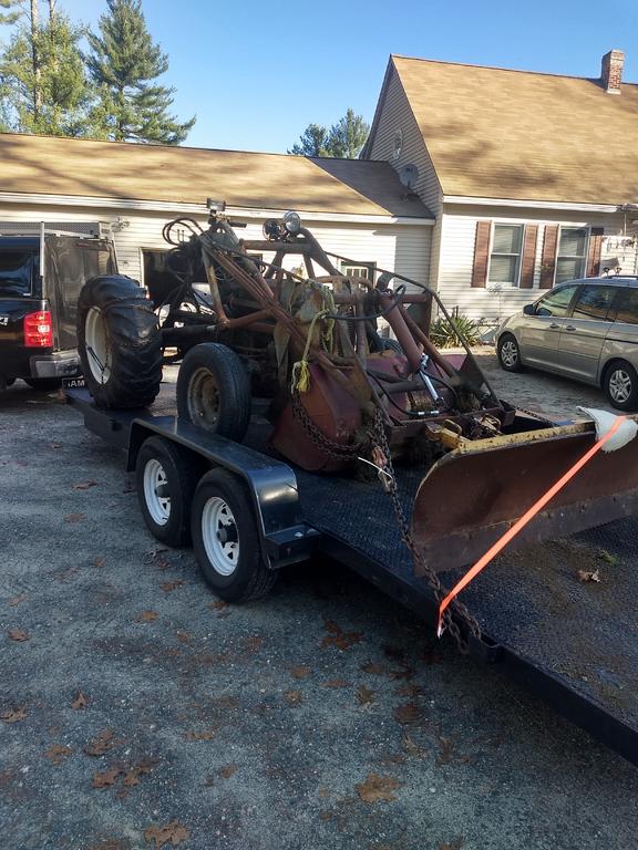

ebinmaine 80,477 #1 Posted November 10, 2019 (edited) Well the Ferguson is home. Runs. Drives. Lifts. Lowers. And it's ROUGH. Like 24 grit sandpaper rough. It's all good though. I bought it from my parents specifically because they've helped me out ALOT over the years and it's my way of paying them back a little now that I'm in a better place in life. It has a 6.5' plow and 2 buckets. It's been updated to 12v. The front tires have been changed to 16" rims from the original 19" knife edge. Great for steering with the loader. The bucket/ plow has had an additional hydraulic circuit added so it's power up/down. Not a trip style. Before winter: There's a few loose wires I need to move, remove, or recrimp. Likely an oil change. But it'll get Trina/BBT after it when spring comes... That tractor will never know what hit it. Edited November 10, 2019 by ebinmaine 11 6 1 Share this post Link to post Share on other sites

ZXT 2,402 #4 Posted November 10, 2019 (edited) 2 hours ago, ebinmaine said: It has a 6.5" plow and 2 buckets. That's one tiny plow! What kind of shape is it in mechanically? Engine and the hydraulics solid? Edited November 10, 2019 by ZXT Share this post Link to post Share on other sites
ebinmaine 80,477 #5 Posted November 10, 2019 9 minutes ago, ZXT said: That's one tiny plow! What kind of shape is it in mechanically? Engine and the hydraulics solid? Maybe I put the wrong size for the plow. Edited that. Thanks... As far as the engine and transmission it is mechanically excellent. The engine doesn't even let out so much as a wisp of smoke. Cold starts go quite well. Transmission gears are in good shape but the shifting mechanism is a little loose. The hydraulic system is good and strong and works perfectly fine but there are some seals that need attention. 3 Share this post Link to post Share on other sites

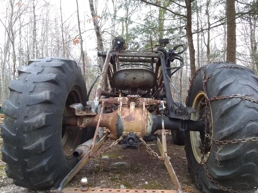

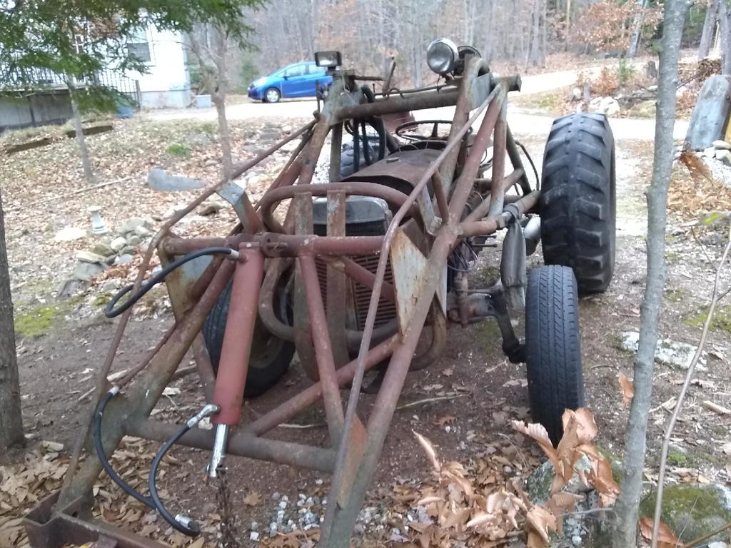

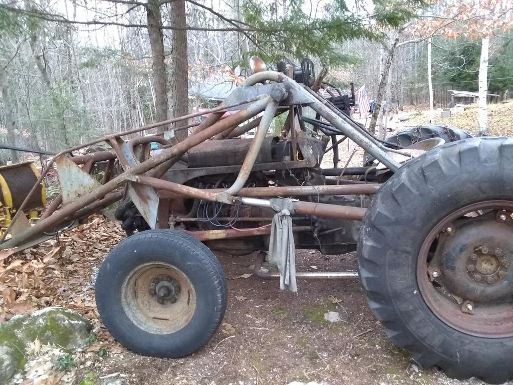

ebinmaine 80,477 #15 Posted November 11, 2019 On 11/10/2019 at 1:50 PM, Lee1977 said: We want some better pictures when Trina can get to it. Here ya go Lee 3 Share this post Link to post Share on other sites
Lee1977 7,756 #16 Posted November 12, 2019 Never seen a loader like that, looks well made with plenty of bracing. Check out all the cylinder connections and the loader pivots for ware. Old equipment gets real dangerous when they hang up with a load. 1 Share this post Link to post Share on other sites

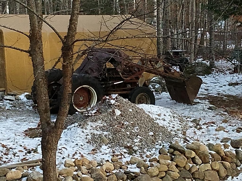

ebinmaine 80,477 #19 Posted November 17, 2019 Spent a few minutes today changing the zillion year old fuel line and filter. Then moved the larger bucket off the driveway and go the original smaller one on the loader. 3 Share this post Link to post Share on other sites

ebinmaine 80,477 #22 Posted November 19, 2019 This weekend the next task will be to unbolt and move the left rear wheel to the outer position so we can mount the chains. Then appropriate ignition wires. Share this post Link to post Share on other sites
bc.gold 3,406 #23 Posted November 19, 2019 (edited) 8 hours ago, ebinmaine said: This weekend the next task will be to unbolt and move the left rear wheel to the outer position so we can mount the chains. Then appropriate ignition wires. If those rear tires differ in size this is going to raise hell on the spider gears. Edited November 19, 2019 by bcgold Share this post Link to post Share on other sites
ebinmaine 80,477 #24 Posted November 19, 2019 1 minute ago, bcgold said: If those rears tire differ in size this is going to raise hell on the spider gears. No posi on this one so it should be fine. I haven't literally measured them but they are the same size on the side wall at least. It will be getting 4 new sneakers come spring. 1 Share this post Link to post Share on other sites
