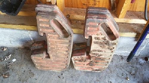

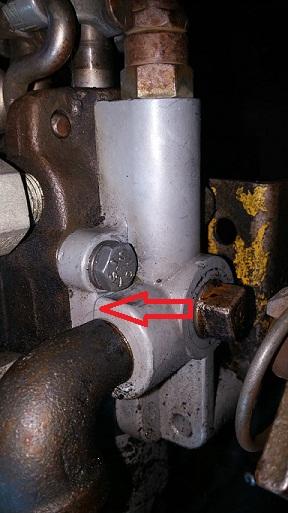

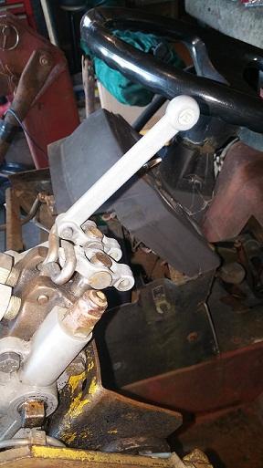

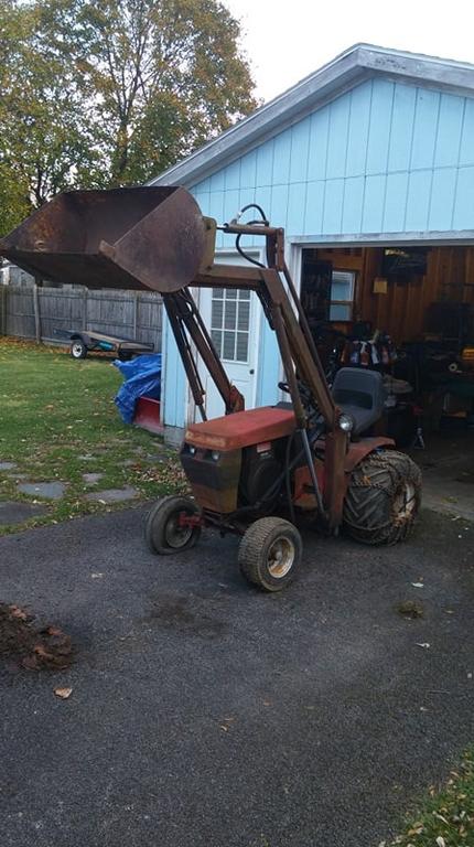

twintornados 28 #1 Posted November 9, 2019 (edited) So, after two years of poking around, I finally found a Wheel Horse tractor with a front end loader that will fit on my C-125 (at least, it should fit) But, the gentleman I bought it from didn't have any documents and I cannot tell if it is an ARK loader or another type made for Wheel Horse. I also need to fix the seal on one of the bucket rams and also the control valve has a crack in one of the end plates that leaks (red arrow pointing to crack). Also would like to find a handle for the "up/down" control as it looks like someone was trying to get off the machine and foot sweep kicked it. I have the broken piece, but not sure it can be repaired. Has four rear weight plates that are like 50 lbs each...man they are heavy. Also, the rear tires are not original, the wheels were widened and those big tires added. Edited November 9, 2019 by twintornados 3 Share this post Link to post Share on other sites
gwest_ca-(File Mod) 12,454 #2 Posted November 10, 2019 Looks like the same loader you see on Sears tractors but don't know who supplied them 1 Share this post Link to post Share on other sites
wildman 205 #3 Posted November 10, 2019 That would be a Kwik Way loader 2 Share this post Link to post Share on other sites

953 nut 68,519 #5 Posted November 10, 2019 12 hours ago, twintornados said: need to fix the seal on one of the bucket rams Best bet would be to remove the cylinder that needs a seal and take it to a good hydraulics shop. they should have a variety of seals in stock. They may also be able to replace the cracked fitting or sell you a replacement spool valve. 1 1 Share this post Link to post Share on other sites

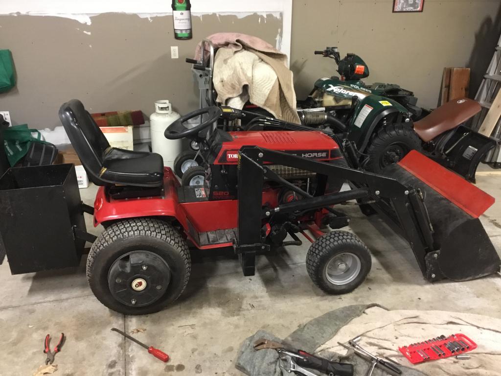

RJC1965 173 #8 Posted November 23, 2019 (edited) Here is a pic of my kwik way Edited November 24, 2019 by RJC1965 Share this post Link to post Share on other sites
