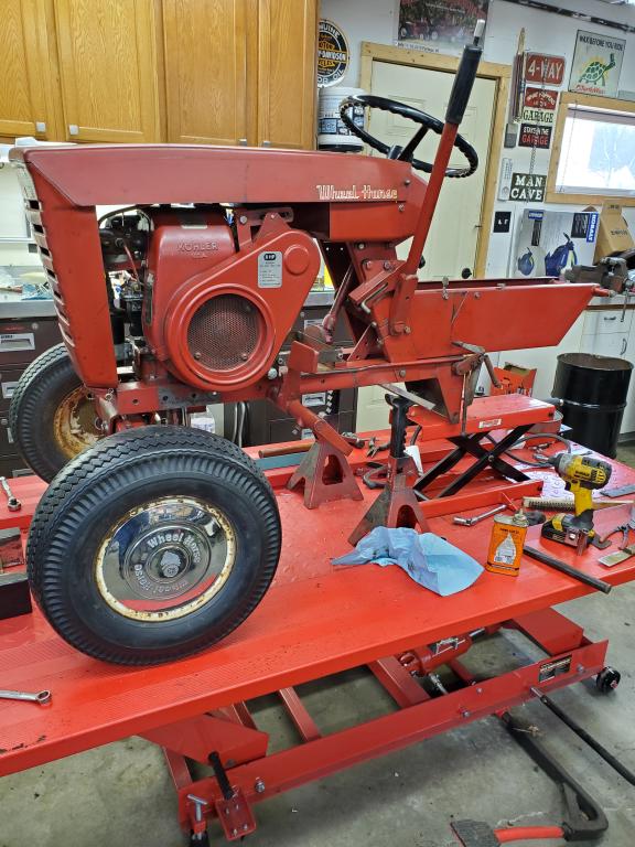

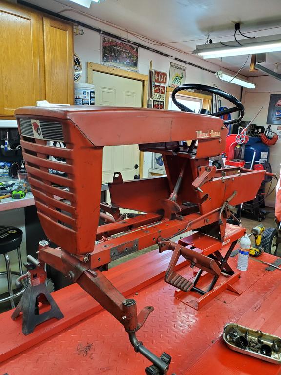

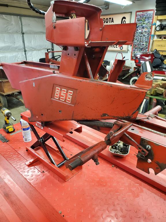

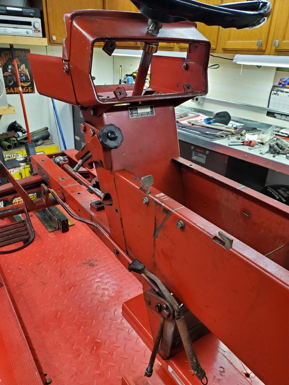

prondzy 3,891 #28 Posted November 14, 2019 Well I have decided to wetsand and im happy with the color a little before and after I installed a brass flange bushing in the dash for the steering shaft, I am pleased with how tight the steering is now, next step will be ordering a new set of tie rods from WH parts and more. Here is a couple pics of where I am at so far. 3 10 Share this post Link to post Share on other sites
CasualObserver 3,417 #29 Posted November 14, 2019 Nice job Mike, really giving that new life without overdoing it. 1 Share this post Link to post Share on other sites

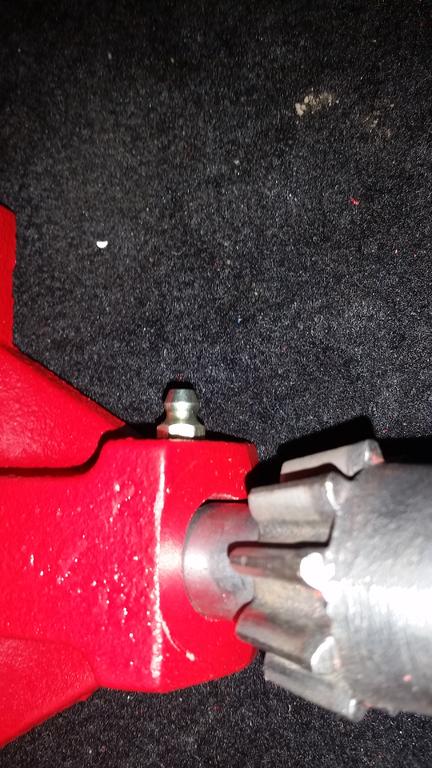

WHX?? 58,327 #30 Posted November 14, 2019 (edited) 20 minutes ago, CasualObserver said: new life without overdoing it. Not only that these projects go much faster when there is no painting process. Most of the battle is cleaning years of caked grease off. 10 hours ago, prondzy said: pleased with how tight the steering is now I was always thinking a way to spring load the fan gear shaft up against the pinion shaft to keep the fan gear tight meshed tight with the pinion instead of shims on the back end. I also did some bushing work in that area to try and tighten things up more. Also added a zerk to the bottom fan gear pivot. Looks like that lift is working really nice for ya. Edited November 14, 2019 by WHX24 2 Share this post Link to post Share on other sites

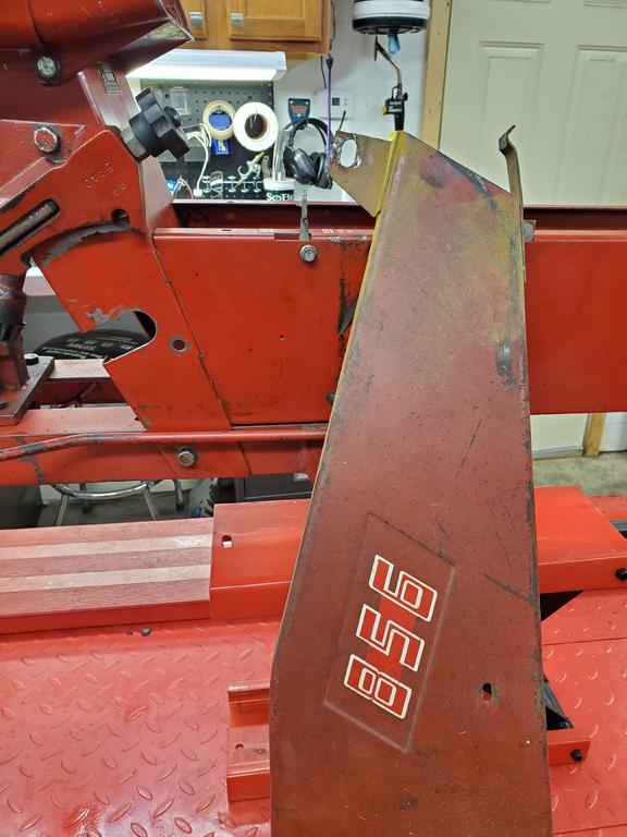

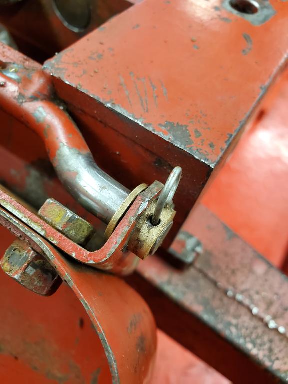

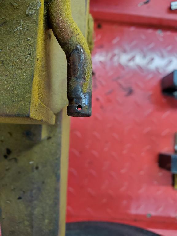

prondzy 3,891 #34 Posted November 16, 2019 So this week after work I just did some wet sanding on the belt guard and hood I also figured out my hood bushings. I left the hood mount alone as far as filling in the wear point I sanded them down a little to accept a 3/8id 1/2od flange bushing and cut them down to fit the current mount I also had to open the hood mount holes up to 1/2in. As you can see I also drilled out the pin hole so the bushing stays in place and he hood wears on the bushing instead So this is where I have gotten so far Hoping to clean up the engine or tear apart the trans this weekend or next week. 1 8 Share this post Link to post Share on other sites

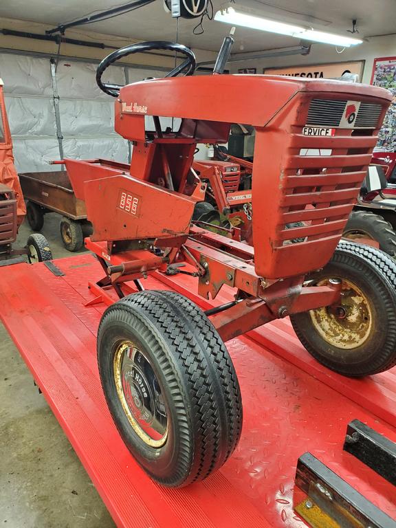

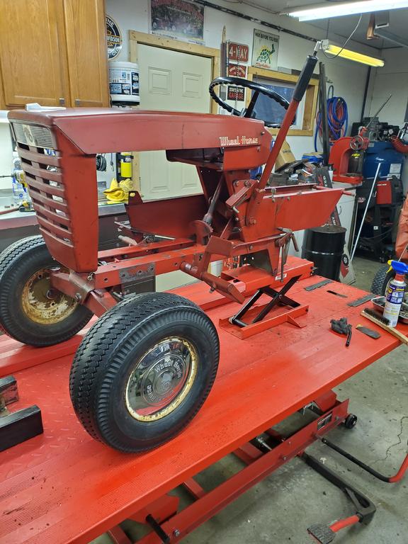

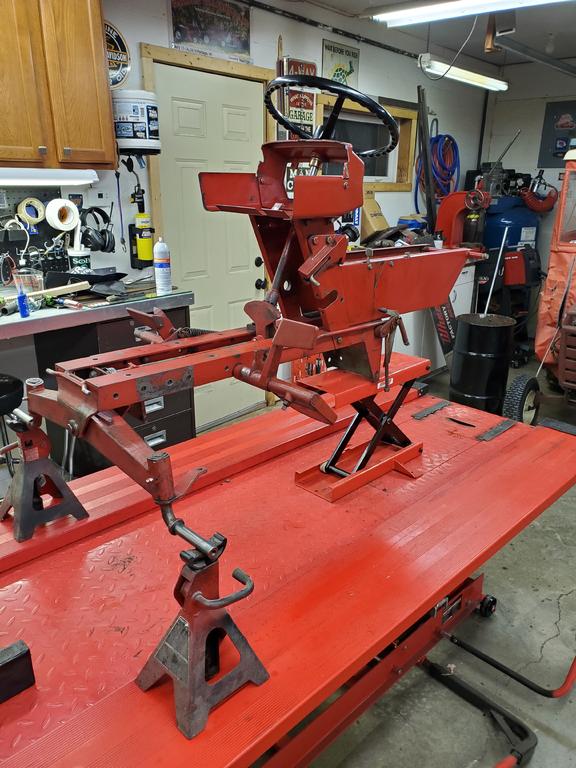

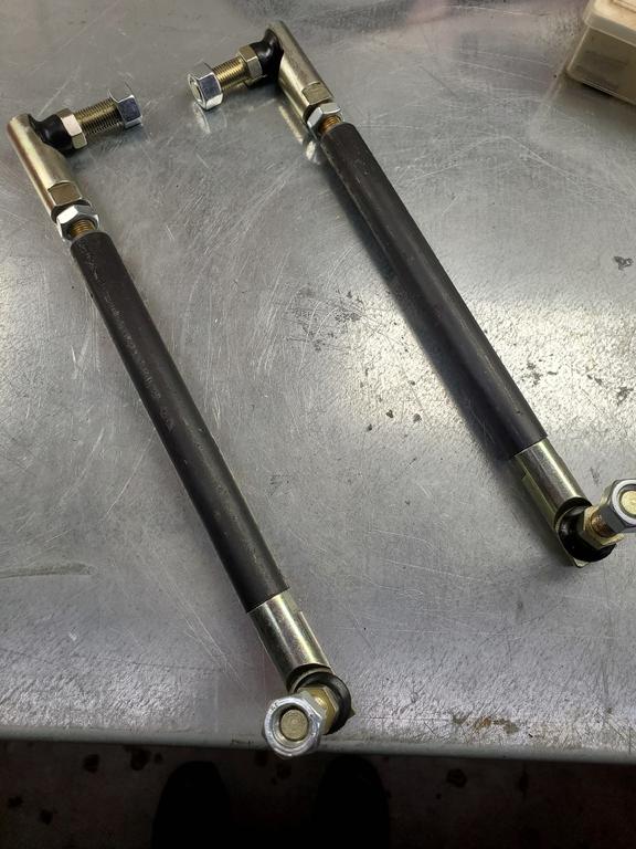

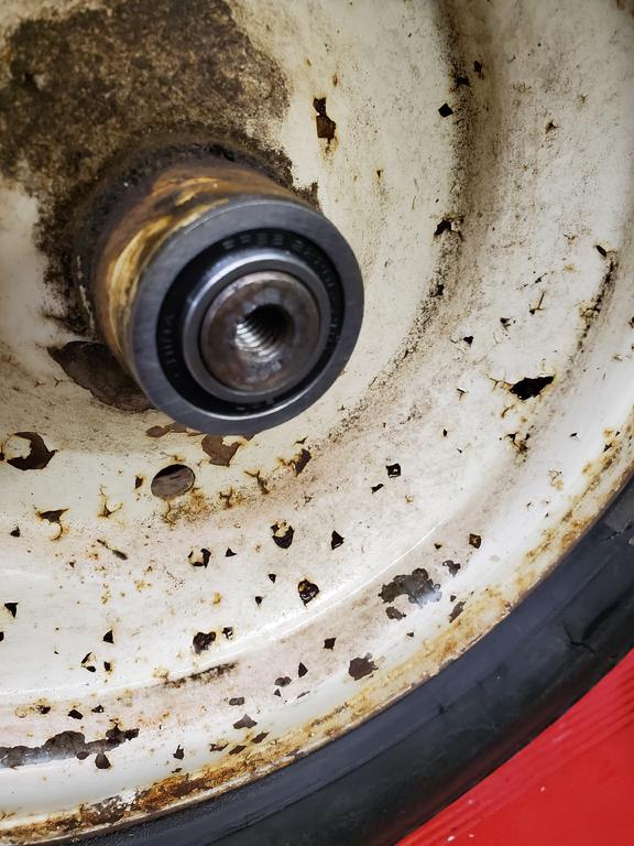

prondzy 3,891 #35 Posted November 17, 2019 (edited) Well I did get the engine cleaned up and replaced both crankshaft seal because they were leaking. No pics yet I need to get a new starter/generator belt first. I did get a few more pieces wet sanded, and even got out to see @wheelhorseman and pick up some adjustable tierods New wheel bearings And now shes back on her front feet again. hopefully I will get the trans done soon do i can put her back on all 4. My progress as of tonight: Edited November 17, 2019 by prondzy 4 9 Share this post Link to post Share on other sites

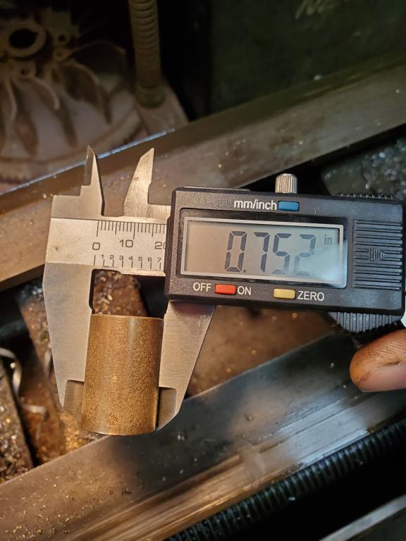

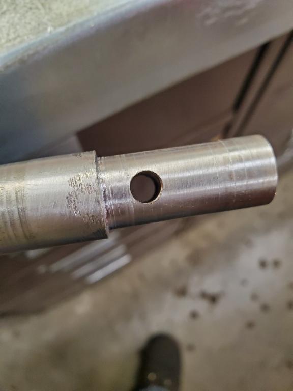

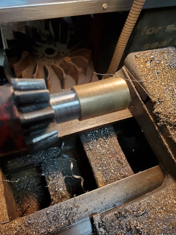

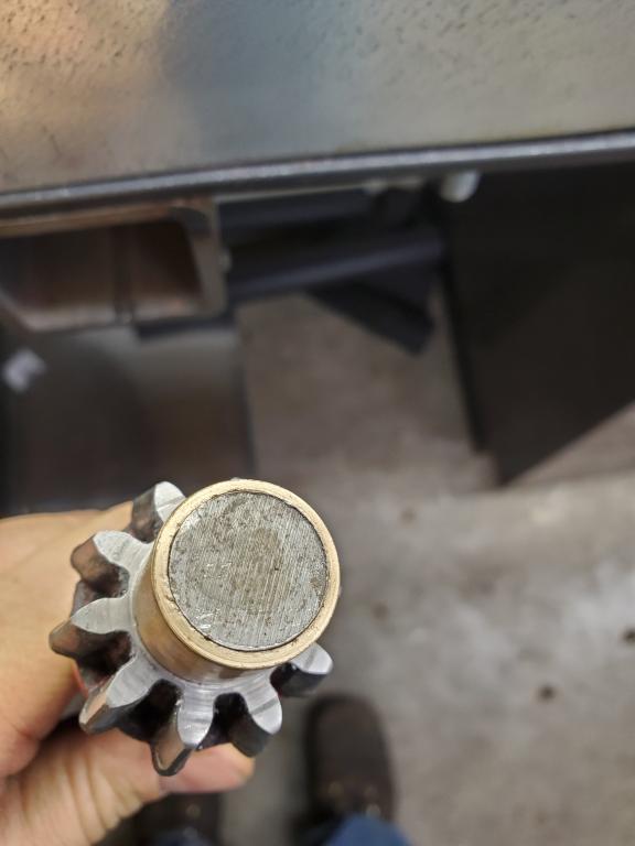

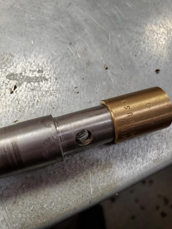

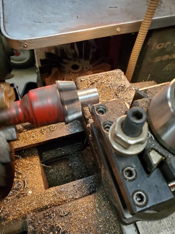

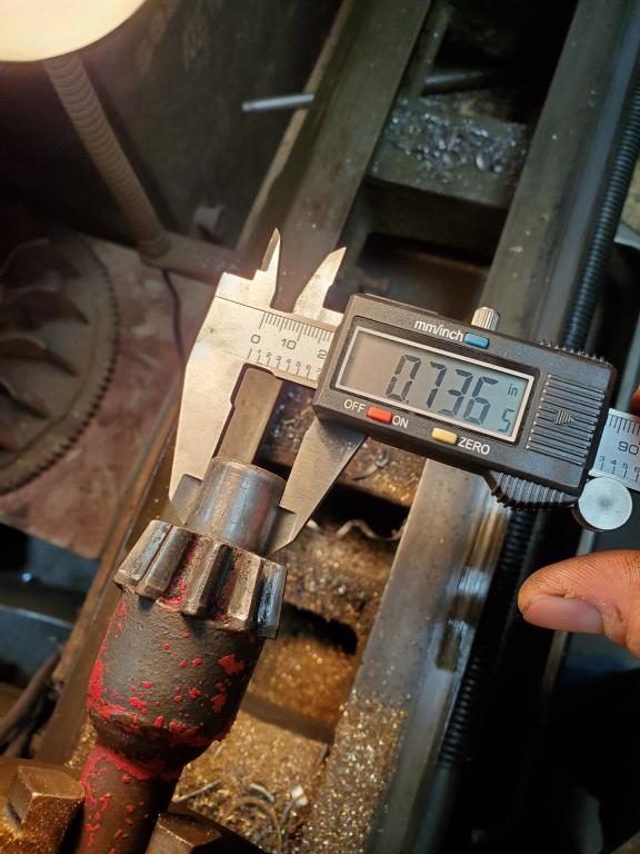

prondzy 3,891 #39 Posted November 23, 2019 I havent been liking the amount of slop in the steering shaft to block assembly. Thanks @WHX24 for the idea.Here is why The steering shaft was worn more that the block so i decided to turn down the shaft and press on a bronze bushing Super tight now! i also decided to do the same in the steering wheel end this way they cannot rust together again! Fun pic Max (4) decided he wanted to clean in the garage so he started maintenance on the mower deck 3 10 1 Share this post Link to post Share on other sites
Pullstart 71,482 #40 Posted November 24, 2019 So cool! Good idea of the steering wheel bushing too... what a way to one up Uncle Jim! 1 1 3 Share this post Link to post Share on other sites

jebbear 386 #42 Posted November 24, 2019 15 hours ago, prondzy said: The steering shaft was worn more that the block so i decided to turn down the shaft and press on a bronze bushing I like that idea , looks like you may be on to something here. When I re-bushed mine, I did the bearing in the block assembly, but had some difficulty installing for a good & tight fit. When I do mine again next time (more likely the guy that comes along after me), I would adopt your idea. 3 Share this post Link to post Share on other sites

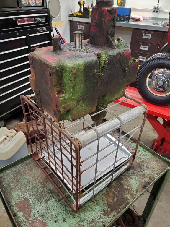

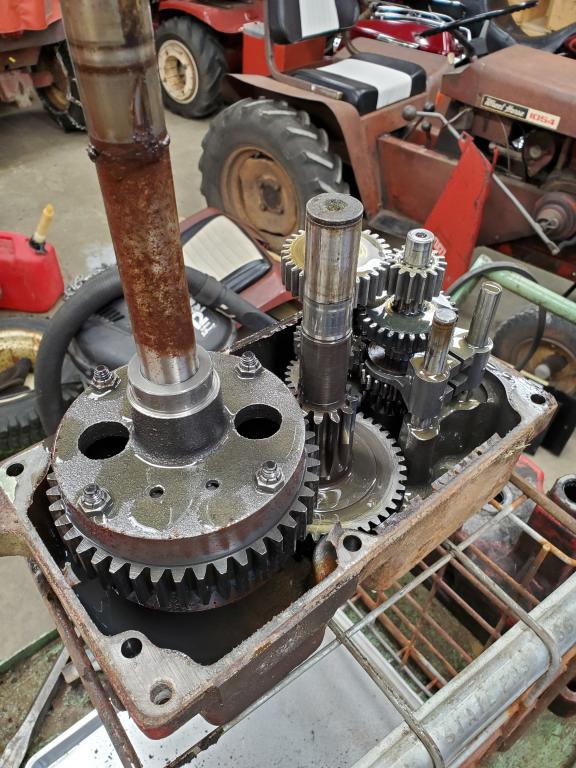

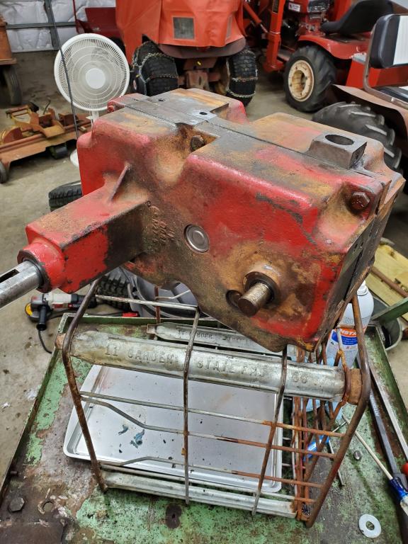

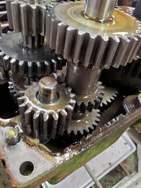

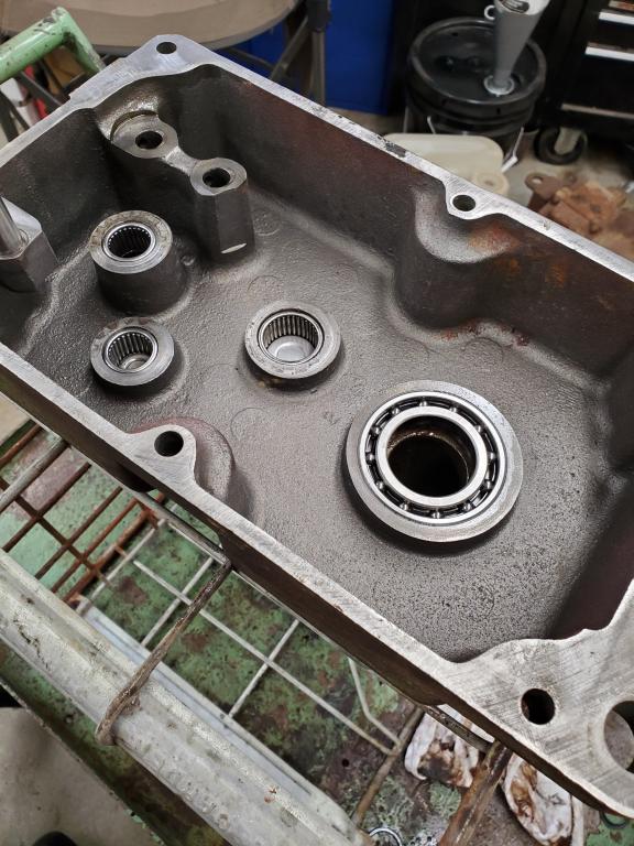

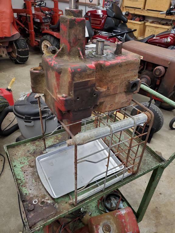

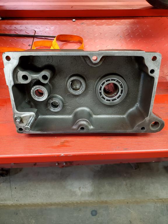

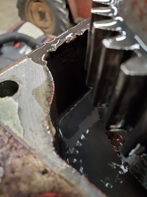

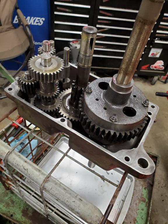

prondzy 3,891 #47 Posted December 1, 2019 Today i decided to tear down the transmission figuring i would find 53 years of dirt and carnage. So after i persuaded the hitch pin out with my air hammer i split open the case and boy was i surprised! This has to be the cleanest transmission I have ever taken apart. It still had the original gasket. The capped bearing on the 11/44 gear was the only bad bearing i found so i replaced it along with the two outer axle bearings and all the case seals as well as wash the case halves Here is everything going back together And all buttoned up ready to bolt back on tomorrow i will get some gear lube. 4 5 Share this post Link to post Share on other sites

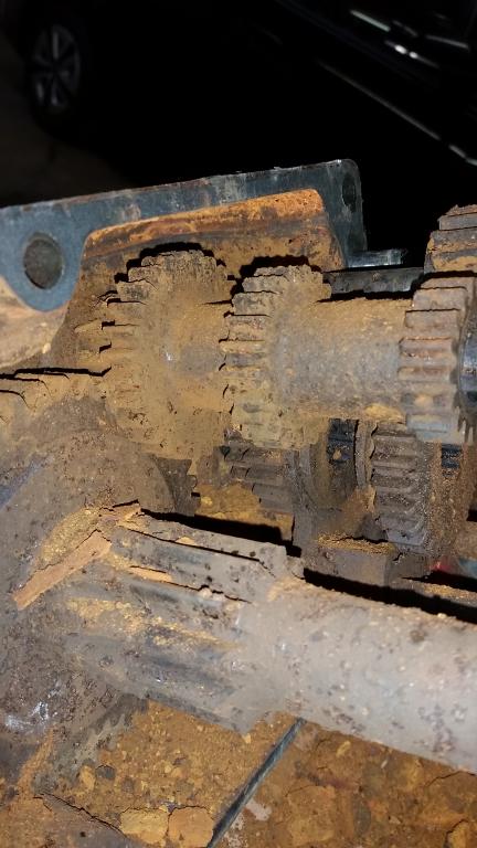

WHX?? 58,327 #48 Posted December 2, 2019 Real nice Mike ... I'll just post this here so some know what they can look like when opened. A three piece I opened awhile back and I expected to be trashed was quite nice. Opening trannies are like a box of chocolates. .....you never know what you are gonna get! 3 1 2 1 Share this post Link to post Share on other sites
oliver2-44 11,791 #49 Posted December 2, 2019 14 hours ago, WHX24 said: Opening trannies are like a box of chocolates. .....you never know what you are gonna get! Great chocolate comparison. Boy, I sure have opened some chocolate ones 1 Share this post Link to post Share on other sites
ebinmaine 81,048 #50 Posted December 2, 2019 5 minutes ago, oliver2-44 said: Great chocolate comparison. Boy, I sure have opened some chocolate ones Now that's just mean. I'm hungry. Wait. Now I'm more hungry. Them gears really do look good enough to munch on. 2 Share this post Link to post Share on other sites
