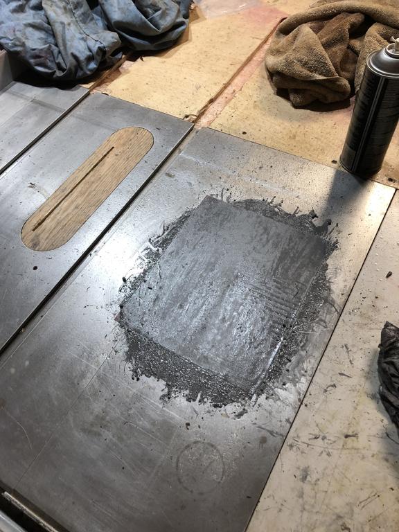

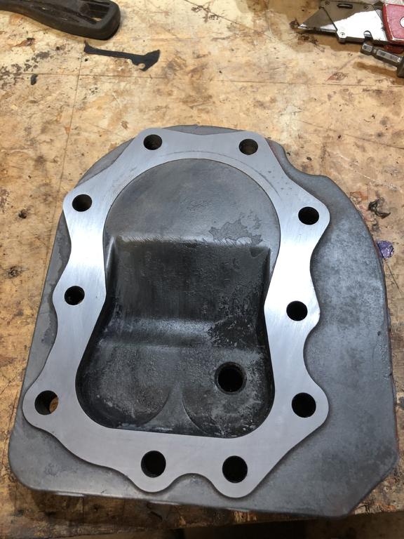

The Tuul Crib 7,354 #1 Posted November 9, 2019 Many have said to clean the head on these motors to use a glass surface. Here in the woodshop I have just found the perfect surface to do this. The cast iron on my tablesaw is perfectly flat. So I glued this sheet of 320 grit and cleaned it up! 6 2 Share this post Link to post Share on other sites

Herder 2,356 #4 Posted November 9, 2019 Nice resurface, bet your arm's a little sore. 1 Share this post Link to post Share on other sites

lynnmor 9,042 #6 Posted November 9, 2019 I use the ground surface on my DoAll vertical band saw. If one has a cheap imported saw, the table will most likely not be true enough for this job. Share this post Link to post Share on other sites
