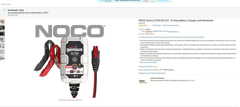

Razorback 1,370 #14 Posted November 9, 2019 (edited) I use a Battery Tender and like it very much. A few weeks ago I bought one of these: Genius G750 battery charger Genius charger manual I have used it several times and it appears to work well. Edited November 9, 2019 by Razorback Share this post Link to post Share on other sites
pfrederi 21,183 #15 Posted November 9, 2019 I have been using this Noco for 4 years and has proven it self to work well, no cooked batteries. i needed the capability for my big tractors. Share this post Link to post Share on other sites
Razorback 1,370 #16 Posted November 9, 2019 Great timing, pfrederi! Share this post Link to post Share on other sites

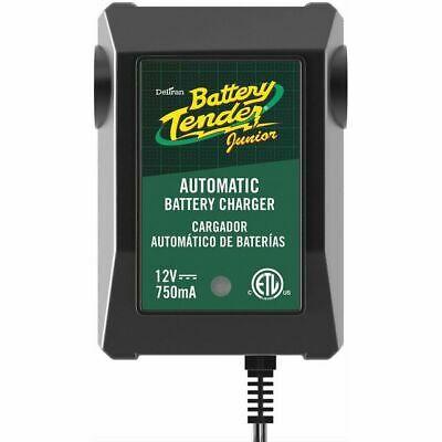

12Horse Paladin 1,038 #17 Posted November 9, 2019 Thankyou all for your input; i ordered this one, as well as a few other odds n ends off ebay. Im not sure about everything yall are mentioning about hooking it up; i was just planning on using it when i pull the battery for longer periods, but im sure ill figure it out. It sure looks awful small, compared to the shumacher's my Dad uses while the other horses are parked/stored, and i really cant tell from the ad where the indicator lights are, but figure that was just the way the ad was laid out... 1 1 Share this post Link to post Share on other sites
lynnmor 9,042 #18 Posted November 10, 2019 The Battery Tender Jr will work just fine for your intended use. It has a charge rate of 3/4 of an amp so it would take considerable time if the battery is run down. I have the standard 1.25 amp version so that it is better able to handle larger batteries. Unlike the single stage models mentioned previously, the Battery Tender chargers have a four step program for a much better result. Complete 4-step charging program (Initialization, Bulk Charge, Absorption Mode, Float Mode). Automatically switches to float / maintenance voltage after fully charging the battery. If the battery voltage drops too far under load, full charger output power resumes. 4 Share this post Link to post Share on other sites
12Horse Paladin 1,038 #19 Posted November 10, 2019 2 hours ago, lynnmor said: The Battery Tender Jr will work just fine for your intended use. It has a charge rate of 3/4 of an amp so it would take considerable time if the battery is run down. I have the standard 1.25 amp version so that it is better able to handle larger batteries. I was looking for, but couldnt find the larger version, which i wanted. But only found it in other makes. Isnt it called the 'SR'? Share this post Link to post Share on other sites
lynnmor 9,042 #20 Posted November 10, 2019 2 hours ago, 12Horse Paladin said: I was looking for, but couldnt find the larger version, which i wanted. But only found it in other makes. Isnt it called the 'SR'? It is the Battery Tender Plus! and is available online at numerous sites, also auto parts stores, motorcycle shops, battery stores and about a thousand other places. It is made in a standard version and another that is water resistant. Prices vary, so shop around. Look around on the manufacturers website: Plus 1 Share this post Link to post Share on other sites
