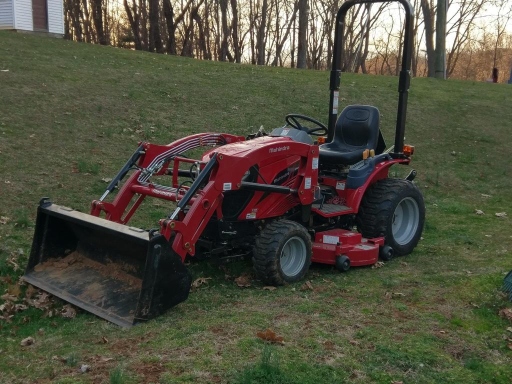

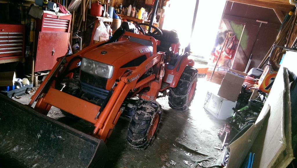

WVHillbilly520H 10,379 #7 Posted November 9, 2019 8 hours ago, CountryRock said: Ok, I'm looking to get new tires for the 416H that I've been working on. The stock rear size that came on it is 23x9.50-12 and the stock front is 16x6.50-8. I'm looking for something a little more aggressive than turf tires for it, I'm thinking Carlisle trac chief for the rear. What sizes can I get away with putting on the stock wheels? 23x10.50-12 will fit just fine but those Trac Chiefs (R4 Industrial) are not really any more traction than turf tires especially in wet grass or snow I can attest to that from my own experiences with my 2 compact 4wd tractors without chains and front axle locked in they just spin like turfs. 1 Share this post Link to post Share on other sites
