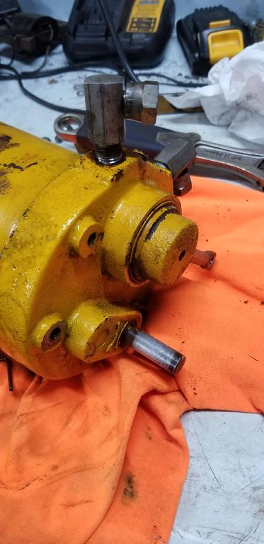

Mike'sHorseBarn 3,373 #7 Posted November 6, 2019 I'm adding a pic of the cub cadet pump. It's leaking out of the shaft in the pic big time and the hole itself around the shaft is worn. 2 Share this post Link to post Share on other sites
WHX?? 53,369 #8 Posted November 6, 2019 Well herein lies your first mistake Mike... working on CC stuff.... paint it red you'll have better luck! Seriously yah give Lowell a jingle he might be able to offer some suggestions. He fessed up once he hoards these things. Shaft size should be .500, od of seal .625 or 5/8 but some might have been .75 on the od. History loses us. Lowell says ther is enough room to stack two seals in ther? If the hole inside of the input shaft is worn enough the hole will have to be rebushed. Just like on a rear end wear a worn axle needle will make a new seal fail in short time. Over tension on the drive belt wears the shaft bore. They should have used replacable bearings and I need not welcome you of all guys Mike to old skool.... 1 Share this post Link to post Share on other sites
