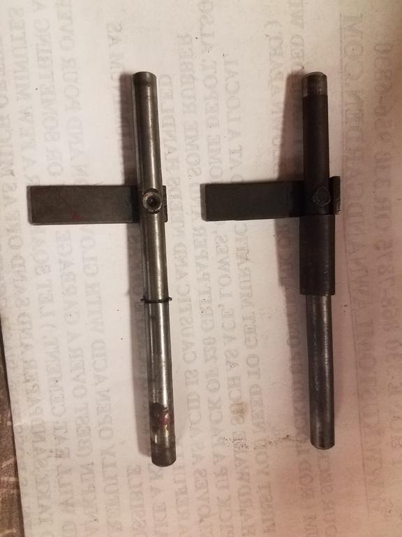

Shynon 7,543 #4 Posted November 4, 2019 I think there is a sleeve on the shaft to stop the movement, you will have to carefully remove the brass nut. I can get pictures when i get home 1 Share this post Link to post Share on other sites

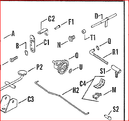

WHX?? 54,958 #5 Posted November 4, 2019 (edited) I have also saw where there is a real small clip ring on the shaft to limit movement so that is maybe what Tom is talking about. The groove is real small and the clip is just a wire and pretty dainty....easy to dislodge. Don't remember if its in front or back of the nut. Parts manual does show some kind of hooby doo ther … # T1... calling it a bushing. Edited November 4, 2019 by WHX24 1 Share this post Link to post Share on other sites

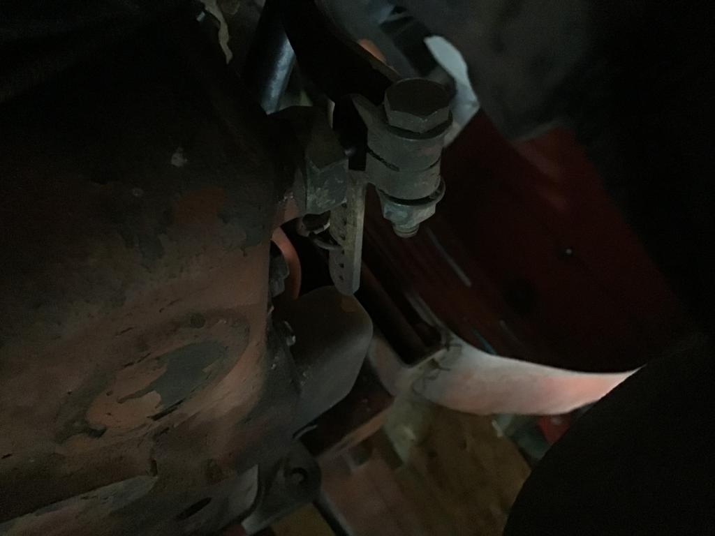

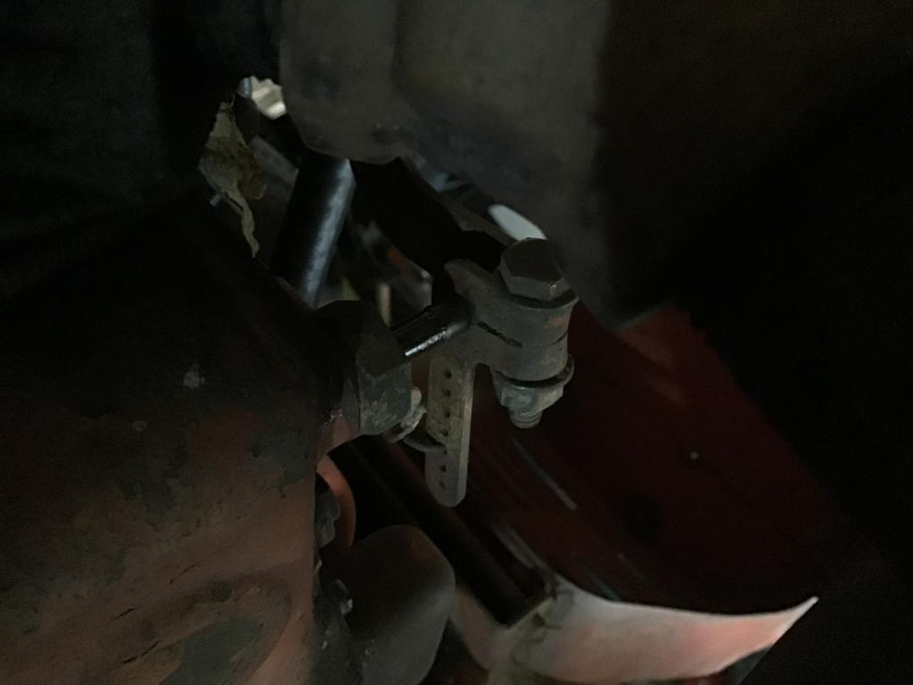

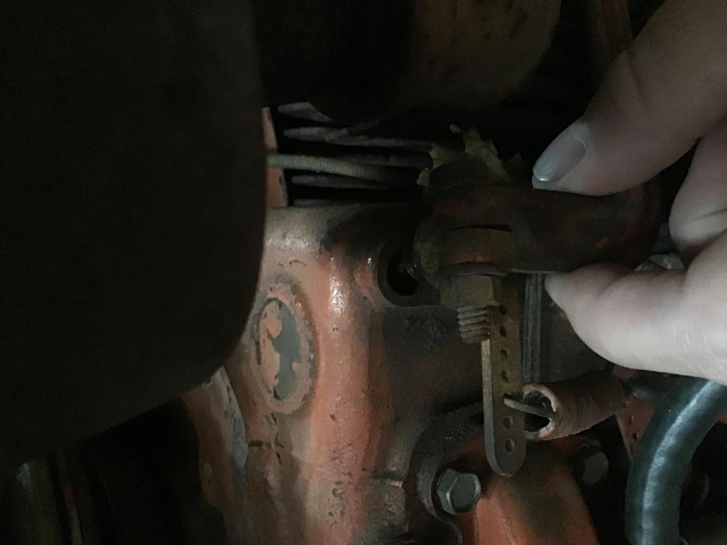

Pullstart 68,878 #8 Posted November 4, 2019 I climbed up to snap a few pics. Sorry for the poor lighting... Without the nut, there is a ton of slop... but the shaft won’t pull out. Share this post Link to post Share on other sites
WHX?? 54,958 #9 Posted November 4, 2019 1 minute ago, pullstart said: but the shaft won’t pull out. No.... shaft has to come out from the inside. You do want the arm to ride in the center of the fly gear tho. That's what the spacer does. Maybe older K's had the dainty clip??? You have to loosen the pinch bolt and slide the throttle arm off to get at the spacer/clip. Then will have to reset it but no big deal procedure is in the manual. That second pic has got way too much arm hanging out. 1 Share this post Link to post Share on other sites

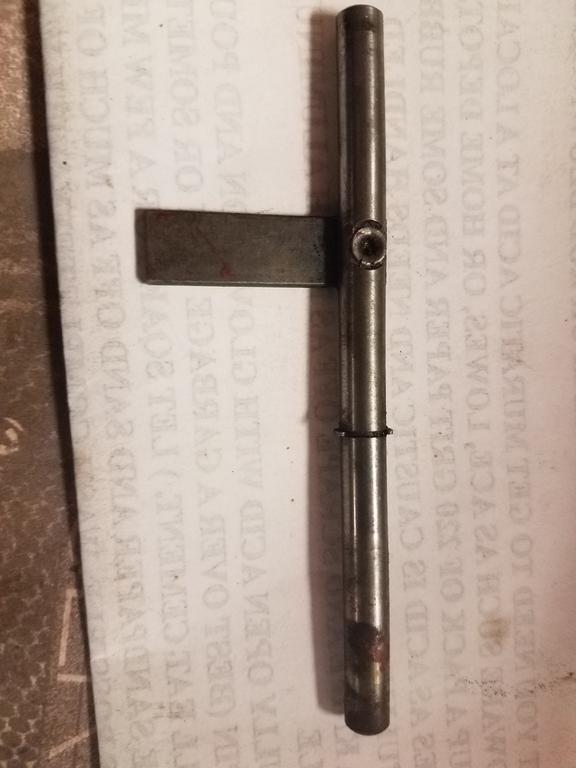

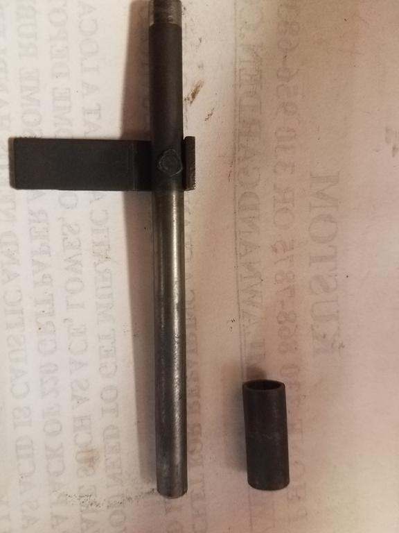

Shynon 7,543 #10 Posted November 4, 2019 2 hours ago, WHX24 said: Parts manual does show some kind of hooby doo ther … # T1... calling it a bushing. That's what's missing, pull the brass nut and put one on. Share this post Link to post Share on other sites
Pullstart 68,878 #11 Posted November 4, 2019 Does anyone have one on a shelf by chance to measure the length for me by chance? That would be awesome to be able to perform an external fix! Share this post Link to post Share on other sites
Shynon 7,543 #12 Posted November 4, 2019 If you have a small groove you have to have a clip on it, if no groove then the bushing/sleeve. 1 1 1 Share this post Link to post Share on other sites
Pullstart 68,878 #13 Posted November 4, 2019 So basically if I have 13/16” slop, make a bushing that long and give it a whirl? 1 Share this post Link to post Share on other sites
