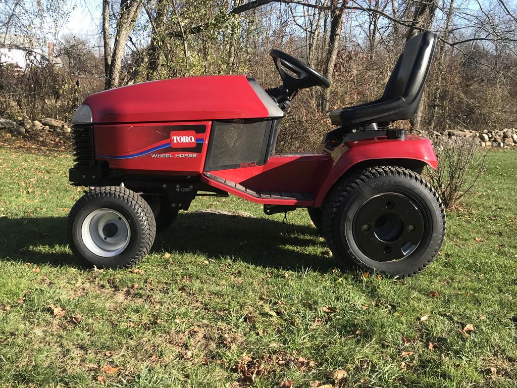

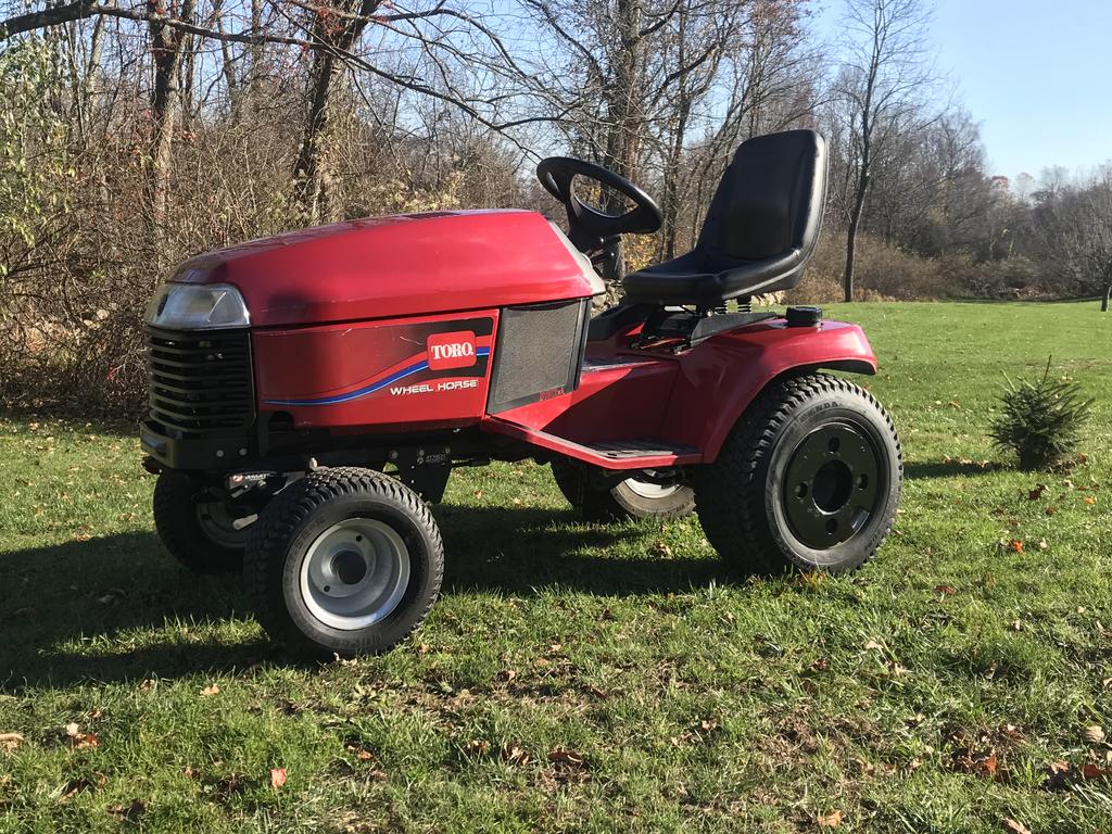

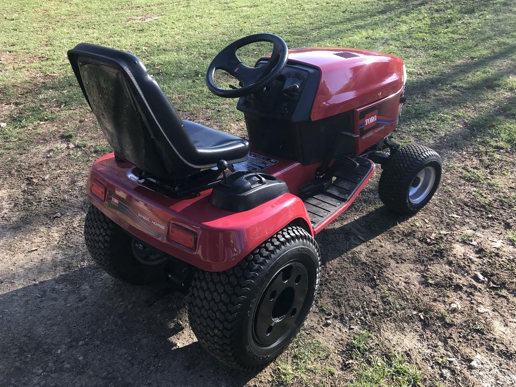

stevebo-(Moderator) 8,742 #1 Posted November 2, 2019 I recently picked up a low hour (490) 1999 520 Xi. Tranny fluid is clean. I am noticing that when going down inclines it will sort of come out of gear and freewheel but not like in neutral rather partially engaged. Anyone have this situation? Is there an adjustment on the hydro selector lever? Any advise would be appreciated. Share this post Link to post Share on other sites
