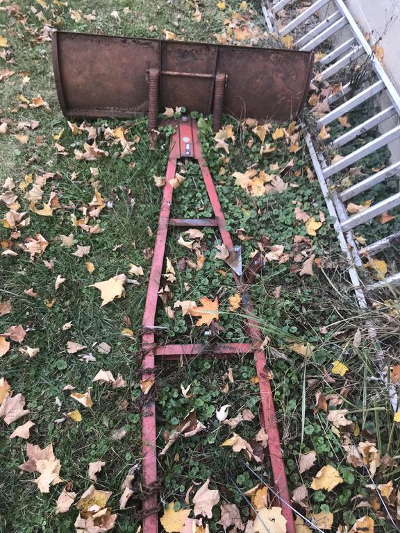

Bean701 35 #1 Posted November 2, 2019 I got a dozer blade with my 312-A. I think I’m missing some pieces. Any ideas? Share this post Link to post Share on other sites
gwest_ca-(File Mod) 12,455 #2 Posted November 2, 2019 Look at the illustrated parts list (TIPL). It shows all the parts. This is not necessarily the blade model you have but the parts should be the same. This one was sold when your tractor was new. Garry 1 Share this post Link to post Share on other sites
oliver2-44 11,694 #3 Posted November 2, 2019 There should be a few attachment bracket that bolts under your rear axle. It may be on the tractor if they came together. Looks like your also missing the handle that move the pin to angle blade side to side Share this post Link to post Share on other sites
Bean701 35 #4 Posted November 2, 2019 1 hour ago, oliver2-44 said: There should be a few attachment bracket that bolts under your rear axle. It may be on the tractor if they came together. Looks like your also missing the handle that move the pin to angle blade side to side This is all I see. I’m missing handle and linkage it looks like to turn blade. Not sure what else. Share this post Link to post Share on other sites
Burnerman 759 #5 Posted November 3, 2019 Kinda looks like you have the rear tach a matic on the axle although it’s different then mine. You’re missing the plow angle lever and linkage maybe. Hard to see in your plow photo. Share this post Link to post Share on other sites
SylvanLakeWH 32,150 #6 Posted November 3, 2019 11 hours ago, Bean701 said: This is all I see. I’m missing handle and linkage it looks like to turn blade. Not sure what else. That is the same rear axle blade attachment I have. It looks complete. Here is pic of mine to compare: Looks to me like you need the blade adjustment handle and the rod connecting that to the blade. 1 Share this post Link to post Share on other sites
