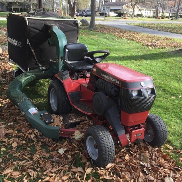

Marc Gall 0 #1 Posted October 30, 2019 Looking for some advice/help/guidance: I have a 315-8. Model # 73450 with a Kohler 15HP Engine. We’re in the process of moving to Northern Michigan. The new home has a pretty steep and long driveway, so I’m in the market for a snow blower for my Wheel Horse. I found a snow blower Model # 79262 - Serial # 5900999. Here’s my questions/concern: 1 - Will this Snow Blower fit my 315-8? 2 - Harder question, will my 315 be able to handle a steep drive. The drive is around 30°. I am planning to purchase rubber chains and wheel weights. Any advice is greatly appreciated! Share this post Link to post Share on other sites
