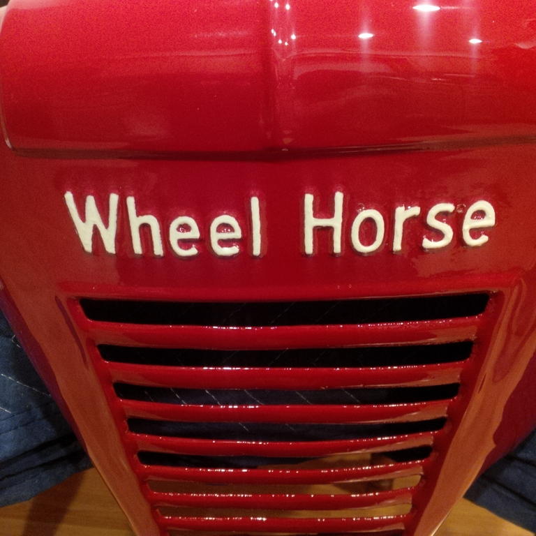

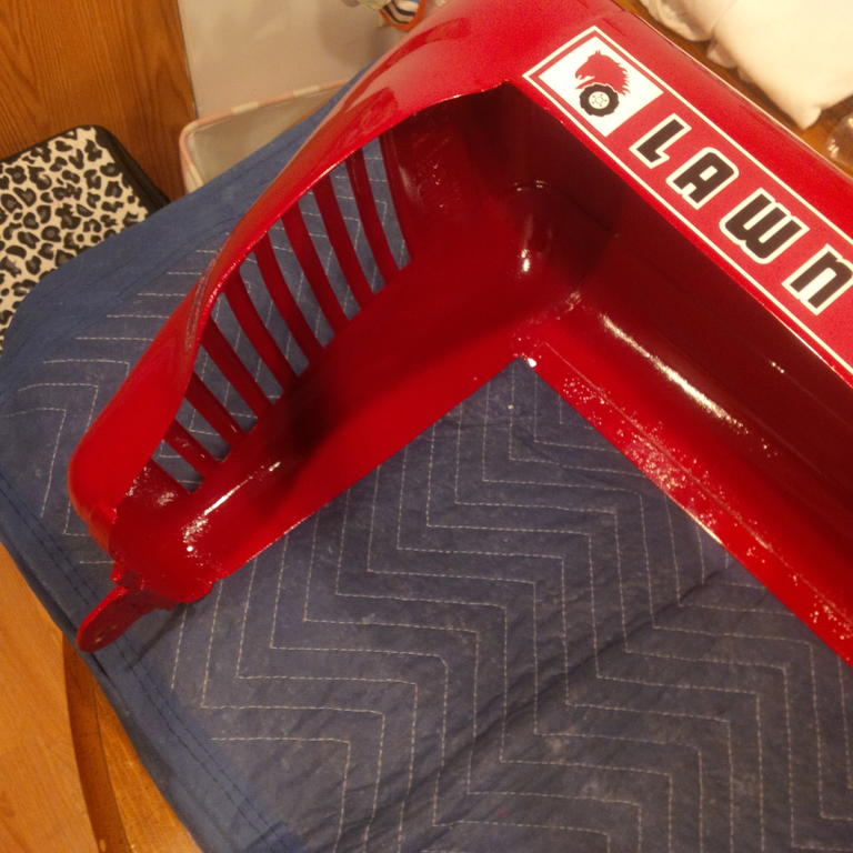

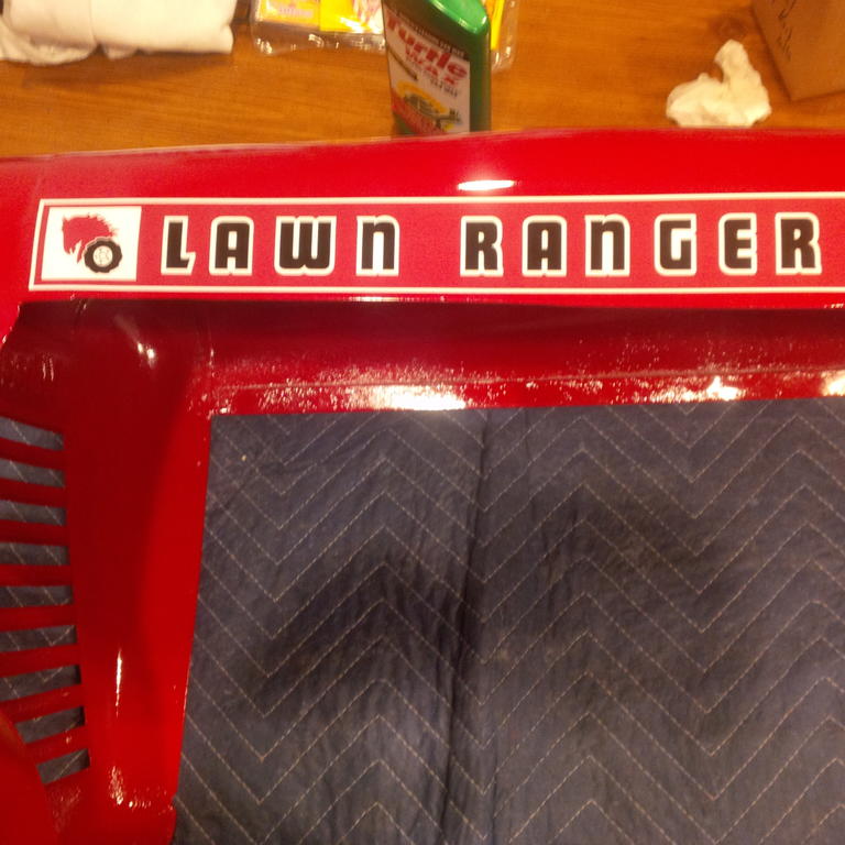

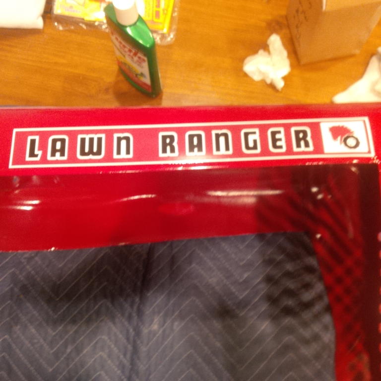

fast88pu 3,393 #27 Posted November 1, 2019 Some decals added today. Still have to paint the wheel horse on the front white. Also a photo of the flared side. 1 5 Share this post Link to post Share on other sites

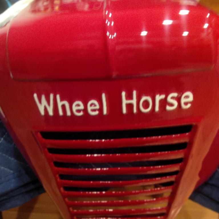

fast88pu 3,393 #29 Posted November 1, 2019 Few more coats of white paint on the wheel horse and the hood will be done. 2 1 Share this post Link to post Share on other sites

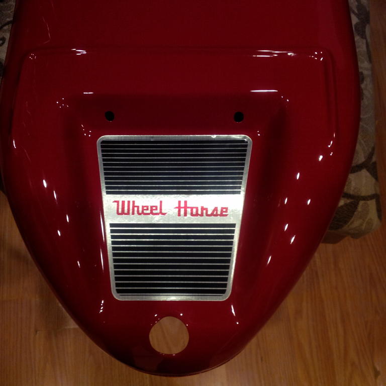

fast88pu 3,393 #30 Posted November 2, 2019 3 coats and dry time now 1 1 Share this post Link to post Share on other sites
Tractorhead 9,217 #31 Posted November 2, 2019 Very glossy surface, i like it. thing it must be fou your daughter, because no Turbo (yet) ...😂👍 1 Share this post Link to post Share on other sites
fast88pu 3,393 #32 Posted November 2, 2019 17 minutes ago, Tractorhead said: Very glossy surface, i like it. thing it must be fou your daughter, because no Turbo (yet) ...😂👍 Maybe a turbo when she's 5 lol 4 Share this post Link to post Share on other sites

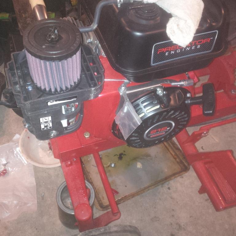

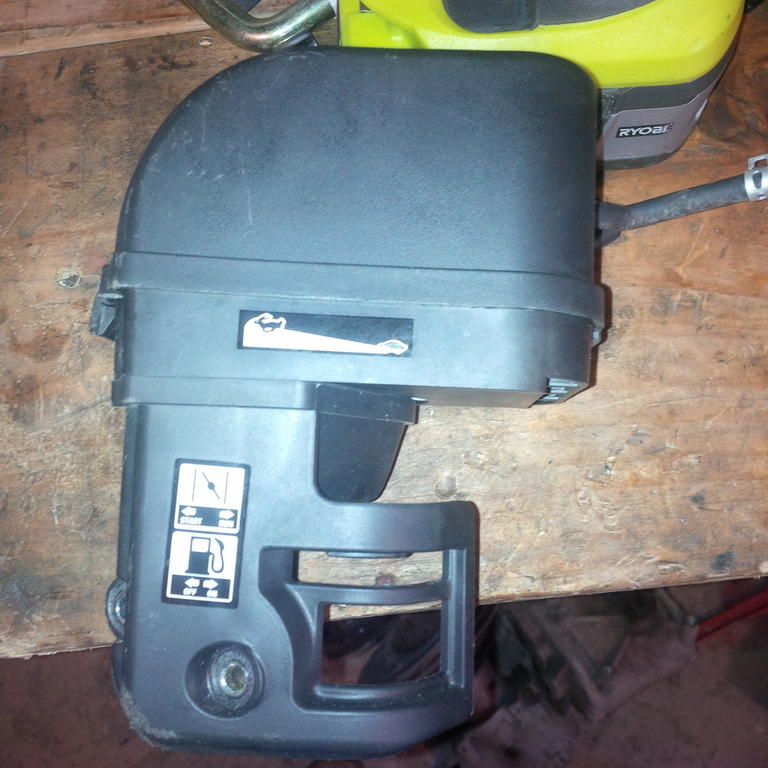

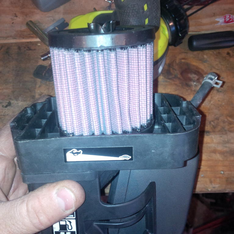

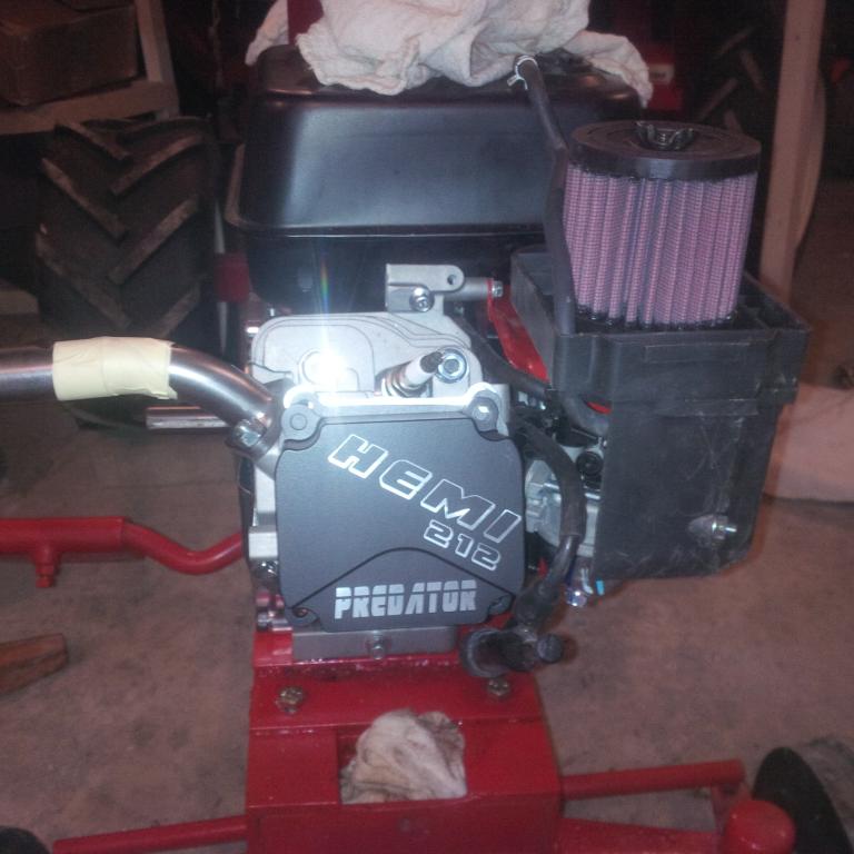

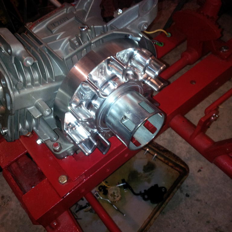

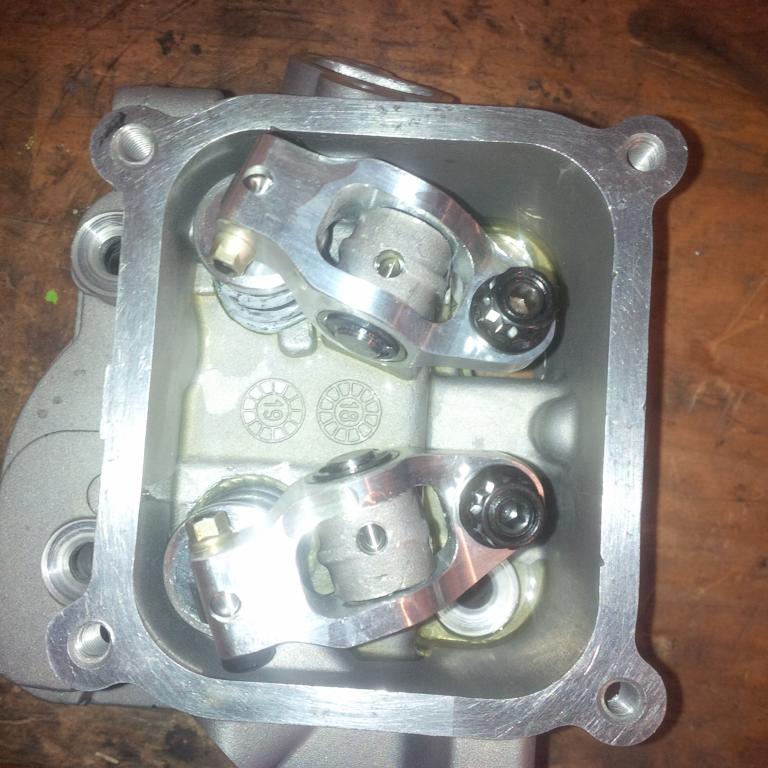

fast88pu 3,393 #35 Posted November 9, 2019 Some more engine work done today. Billet side cover on an head studs in. Also custom air filter K+n made to fit stock housing. And got my roller rockers too. 2 1 Share this post Link to post Share on other sites
19richie66 17,930 #36 Posted November 9, 2019 Amazing that your daughter is so young yet she spec’d all these parts. Blows my mind 1 5 Share this post Link to post Share on other sites

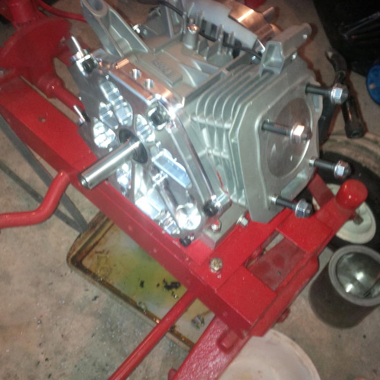

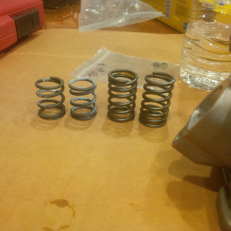

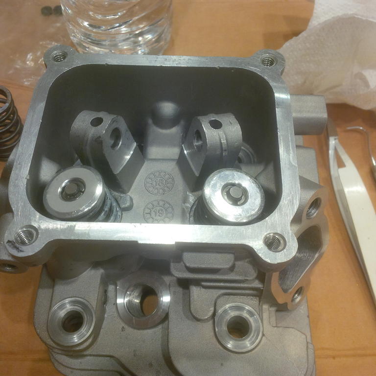

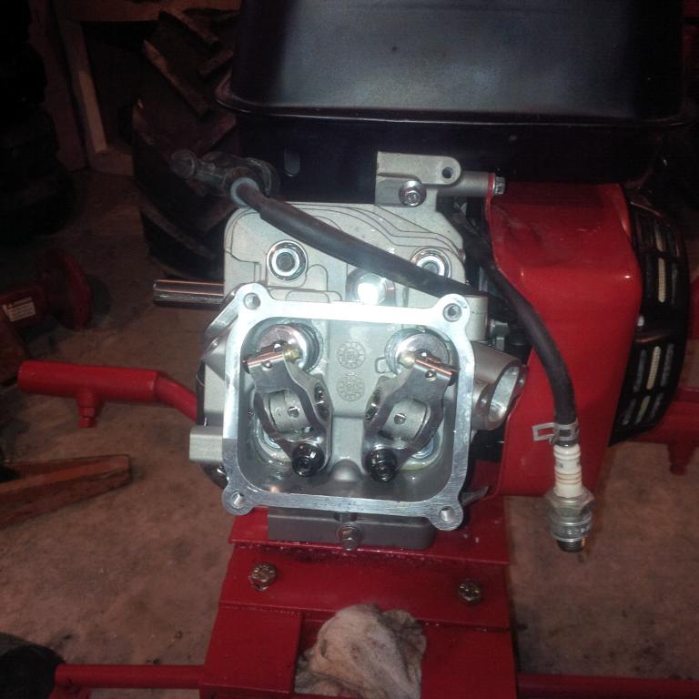

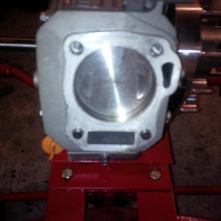

fast88pu 3,393 #39 Posted November 23, 2019 Head is milled, ported and polished now. Stainless valves installed with heavier valve springs and automotive style keepers so it won't eat a valve. Next to install the head and measure and order my pushrods 1 2 1 Share this post Link to post Share on other sites

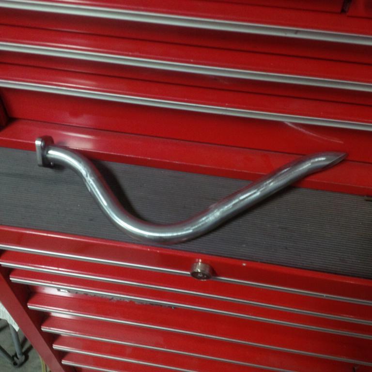

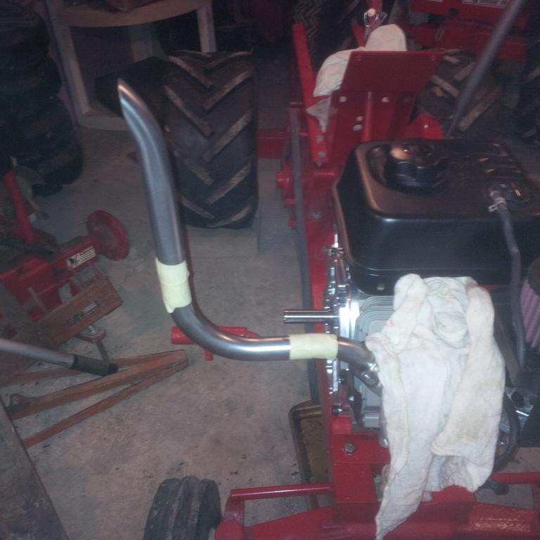

fast88pu 3,393 #41 Posted November 23, 2019 Head is all torque down. Roller rockers are in and I assembled a little more of the engine. I also did a mock up for the exhaust to be welded up. 1 Share this post Link to post Share on other sites

fast88pu 3,393 #43 Posted November 25, 2019 Exhaust is made and on and I tested the hood too 1 2 Share this post Link to post Share on other sites
WHNJ701 4,173 #44 Posted November 26, 2019 is that exhaust supported by anything or just the bolts? Share this post Link to post Share on other sites
fast88pu 3,393 #45 Posted November 26, 2019 10 minutes ago, jabelman said: is that exhaust supported by anything or just the bolts? It is not heavy at all and the studs support it Share this post Link to post Share on other sites
WHNJ701 4,173 #46 Posted November 26, 2019 20 minutes ago, fast88pu said: It is not heavy at all and the studs support it gotcha just getting ideas for mine Share this post Link to post Share on other sites
fast88pu 3,393 #47 Posted November 26, 2019 29 minutes ago, jabelman said: gotcha just getting ideas for mine It's 3/4" thin wall Share this post Link to post Share on other sites
