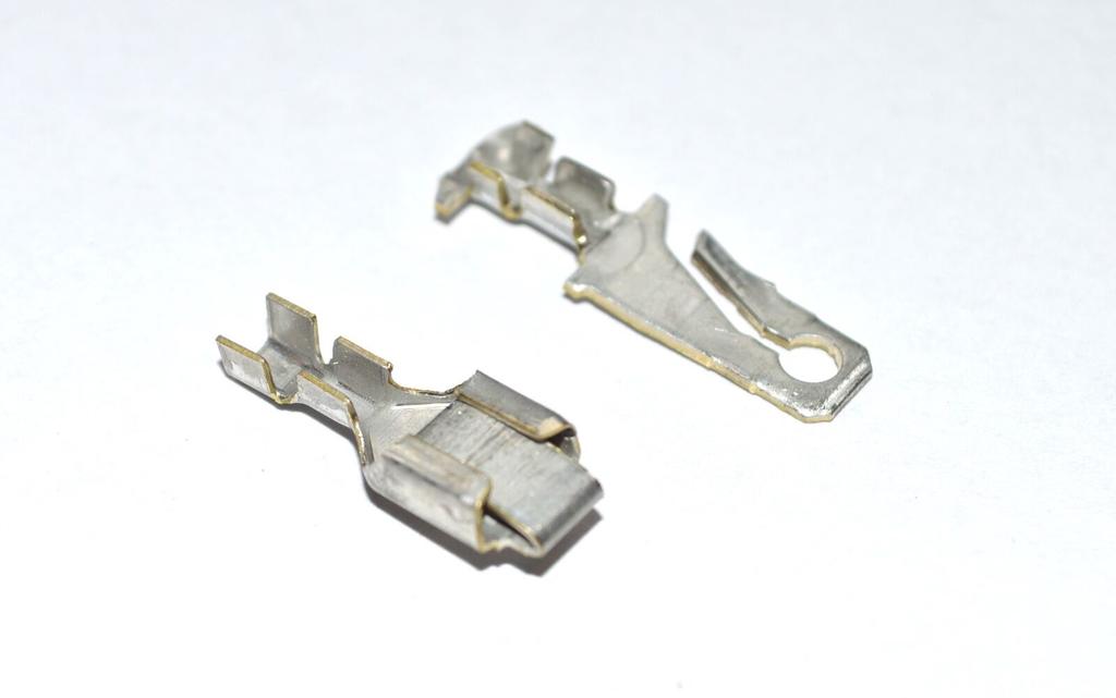

953 nut 68,162 #9 Posted October 28, 2019 If some of your wires have already emitted magic smoke and there are corroded connections you may want to consider doing a complete rewire. In the long run you will save time and aggravation. Your connections can be renewed with some Delphi Packard GM 56 male and female connectors where needed. 3 Share this post Link to post Share on other sites
