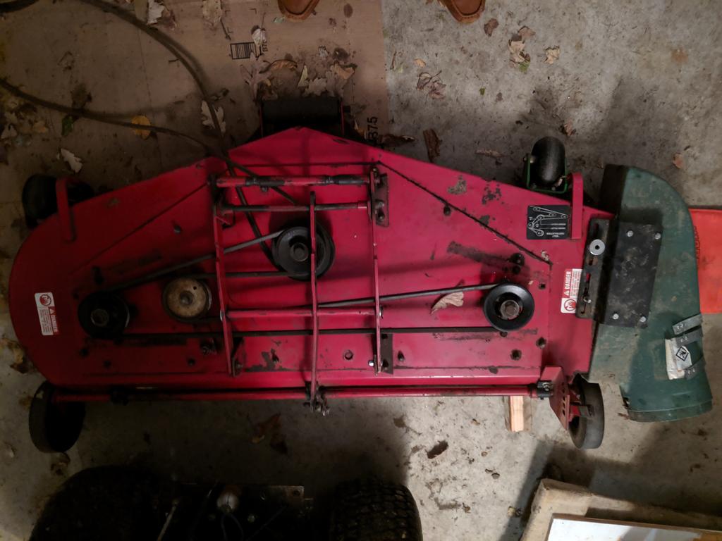

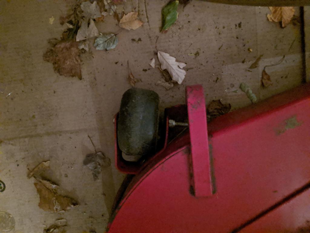

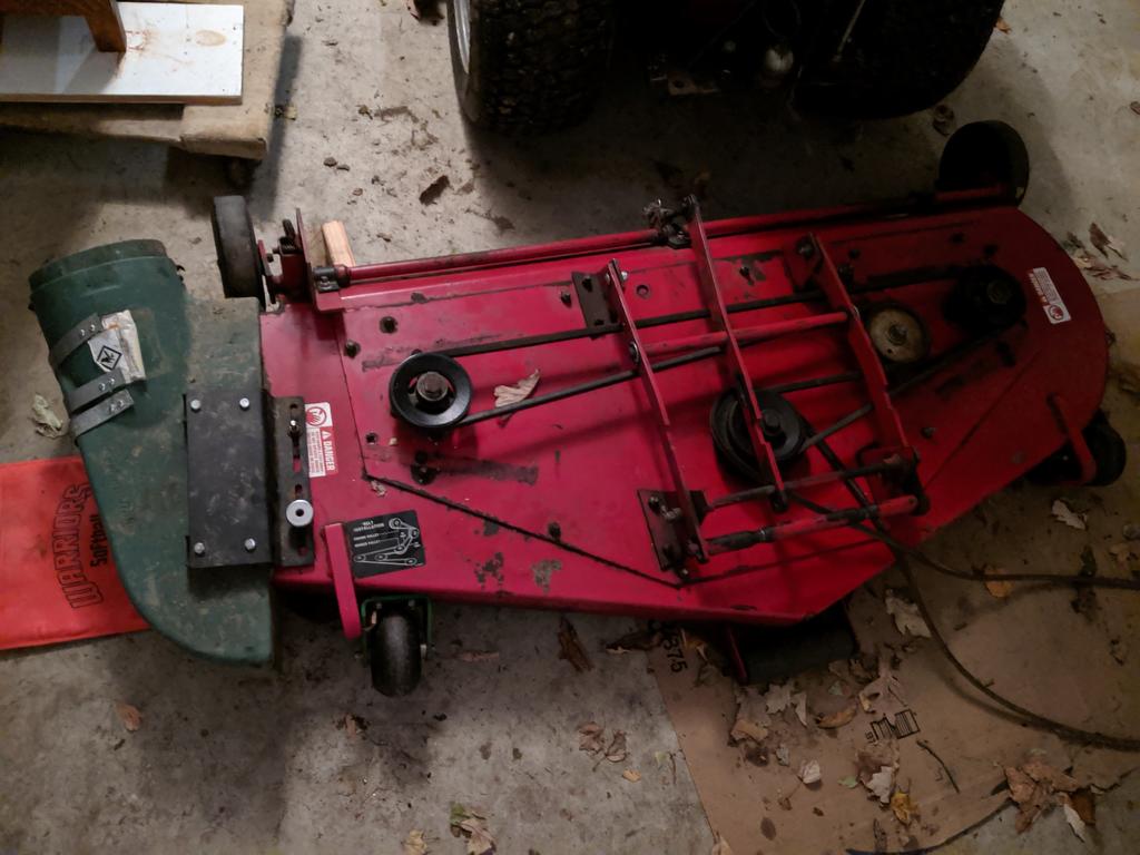

cgambino1018 28 #1 Posted October 27, 2019 After years of looking I finally got a 60 inch deck to go with my WH520. I have a 42 inch deck on it now. The deck did not come with the mule drive. I sharpened the blades, greased the 3 fittings (middle one was a real pain). What else should I do before putting it into service? -Do I need a different mule drive? Also, just pushing the deck on the driveway I noticed it pulls a bit to the one side. the front wheels look like they are facing the direction its pulling toward. Is that something to worry about? All advice is welcome. Share this post Link to post Share on other sites
ZXT 2,402 #2 Posted October 28, 2019 (edited) 1 hour ago, cgambino1018 said: After years of looking I finally got a 60 inch deck to go with my WH520. I have a 42 inch deck on it now. The deck did not come with the mule drive. I sharpened the blades, greased the 3 fittings (middle one was a real pain). What else should I do before putting it into service? -Do I need a different mule drive? Also, just pushing the deck on the driveway I noticed it pulls a bit to the one side. the front wheels look like they are facing the direction its pulling toward. Is that something to worry about? All advice is welcome. Mule drive will be the same, but you will likely have to use the belt that came with the 60" deck. I could be wrong though. Are the front wheels tight on the shaft without a lot of slop? If they're tight, then the wheels were probably just ran into something while mowing. You might have to straighten the brackets. If they're loose they're probably worn out. Beyond that, you should be good to go! Edited October 28, 2019 by ZXT Share this post Link to post Share on other sites
tom2p 2,394 #3 Posted October 28, 2019 3 hours ago, cgambino1018 said: After years of looking I finally got a 60 inch deck to go with my WH520. I have a 42 inch deck on it now. The deck did not come with the mule drive. I sharpened the blades, greased the 3 fittings (middle one was a real pain). What else should I do before putting it into service? -Do I need a different mule drive? Also, just pushing the deck on the driveway I noticed it pulls a bit to the one side. the front wheels look like they are facing the direction its pulling toward. Is that something to worry about? All advice is welcome. do all rollers spin easily ? both deck wheels roll easily ? if not the case - this could also cause deck to pull when pushed Share this post Link to post Share on other sites
tom2p 2,394 #4 Posted October 28, 2019 I don't see grease fittings on the spindles my sight not the greatest - maybe I just can't sell them ? check the obvious before you put the deck into service - including : spin blades and check bearings check belt (deck / spindle - 'rotary' belt) idler bar and bushings (if it has them) idler pulley (check for bearing / bushing play) ensure all pulleys are in good shape (pulley grooves are smooth and free of burrs, etc.) rollers (should spin easily) wheels and attaching bolts (shoulder bolts) - check for play Share this post Link to post Share on other sites
lynnmor 8,831 #5 Posted October 28, 2019 (edited) The mule drive is different for the 60" deck, it has a spring loaded pulley. The early decks didn't have the anti-scalp wheels on the front, only the wear bars that loop around. You have the bars and the wheels were added by a previous owner that didn't care to do it right. The rear wheels are extremely expensive and I could never find cheaper replacements that were nearly as good. I would replace the bearings and keep them well greased to extend the life. Edited October 28, 2019 by lynnmor 1 Share this post Link to post Share on other sites

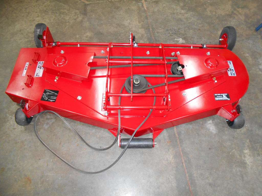

gwest_ca-(File Mod) 12,259 #6 Posted October 28, 2019 Instructions for adding the front rollers Garry Share this post Link to post Share on other sites
ZXT 2,402 #7 Posted October 28, 2019 13 hours ago, lynnmor said: The mule drive is different for the 60" deck, it has a spring loaded pulley. The early decks didn't have the anti-scalp wheels on the front, only the wear bars that loop around. You have the bars and the wheels were added by a previous owner that didn't care to do it right. The rear wheels are extremely expensive and I could never find cheaper replacements that were nearly as good. I would replace the bearings and keep them well greased to extend the life. There I go giving bad info again. Can it be used with a regular mule drive? Share this post Link to post Share on other sites
lynnmor 8,831 #8 Posted October 29, 2019 3 hours ago, ZXT said: There I go giving bad info again. Can it be used with a regular mule drive? I have read reports of that being done, but can't confirm that it will work well. The 60" has the belt on the bottom pulley unlike all the others. 1 Share this post Link to post Share on other sites

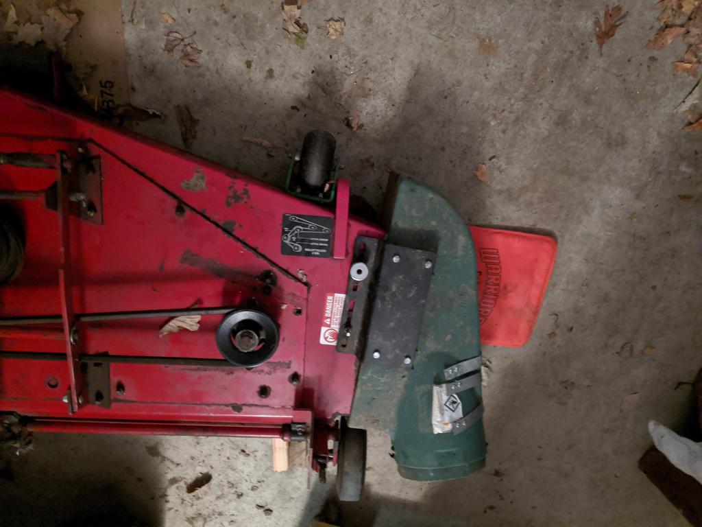

cgambino1018 28 #12 Posted October 31, 2019 Thanks for the feedback. Based on this pic can you tell me if the belt on the desk is properly routed Share this post Link to post Share on other sites
cleat 8,985 #13 Posted October 31, 2019 Looks right. Does belt feel nice and tight ? Here is a pic of mine. Guards are on but you can get the idea. 1 Share this post Link to post Share on other sites

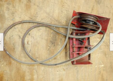

cgambino1018 28 #16 Posted November 22, 2019 have completed about 3 cuts of 18000 sq feet of lawn over the last 4 weeks. not a lot of cutting , mostly leaf pick up. Seems to be working well. Just saw a mule drive for a 60in deck on ebay for $150. a) do I really need a specific mule drive for a 60in desk. Off hand i would say the angles of pulleys are differnt. ; b) does 150 seem reasonable; c: how does this one look? Share this post Link to post Share on other sites
lynnmor 8,831 #17 Posted November 23, 2019 1 hour ago, cgambino1018 said: have completed about 3 cuts of 18000 sq feet of lawn over the last 4 weeks. not a lot of cutting , mostly leaf pick up. Seems to be working well. Just saw a mule drive for a 60in deck on ebay for $150. a) do I really need a specific mule drive for a 60in desk. Off hand i would say the angles of pulleys are differnt. ; b) does 150 seem reasonable; c: how does this one look? Looks like the correct one. The price seems rather high especially when you are buying it without being able to feel for problems. There is a grease fitting on the shaft that apparently was neglected. Be sure that have the option to return it if there is a problem. Note that the pulleys are not in line and one rotates a bit. Totally different that the other models. Share this post Link to post Share on other sites
tom2p 2,394 #18 Posted November 23, 2019 Pulleys appear to have rust on the inside surfaces light rust can be removed fairly quickly and should not be an issue - but heavier rust might be an issue pulleys with rust and other issues / imperfections can destroy good belts fairly quickly Share this post Link to post Share on other sites
cleat 8,985 #19 Posted November 23, 2019 The 60" deck uses cast iron pulleys. Mine were a bit rusty but after bead blasting and painting they look like new. Share this post Link to post Share on other sites
lynnmor 8,831 #20 Posted November 23, 2019 2 hours ago, cleat said: The 60" deck uses cast iron pulleys. Mine were a bit rusty but after bead blasting and painting they look like new. On the deck spindles they are iron, but the mule drive has stamped steel pulleys. Share this post Link to post Share on other sites

cgambino1018 28 #22 Posted November 28, 2019 Got the Mule drive for the 60inch deck for $115, took a wire brush to it to take the surface rust off. Not much there. I also gave the grease fitting a few shots also. Put the Mule drive and the belt that came with it (a little wider) and it seems to run a bit smoother. Take a look at the the video off the link. Next, in the spring to thin the dead grass out I hook a dethatcher to the front of the tractor. I connect it to the mule drive (I know this is a bad idea). With the thatcher on the front and lawn Vac on the back, spring clean up is done in 2 hours. Been doing it for years without issue (knock on wood). Any concerns? See pic of of thatcher adapter that stays on the tractor all year. Also have a few pics of how the thatcher bent the front of the mule drive All comments and advice is welcome. https://1drv.ms/u/s!ArLtdu2CWhLBm5Z8Yu085FYEszwR8g?e=hiAth0 Share this post Link to post Share on other sites
