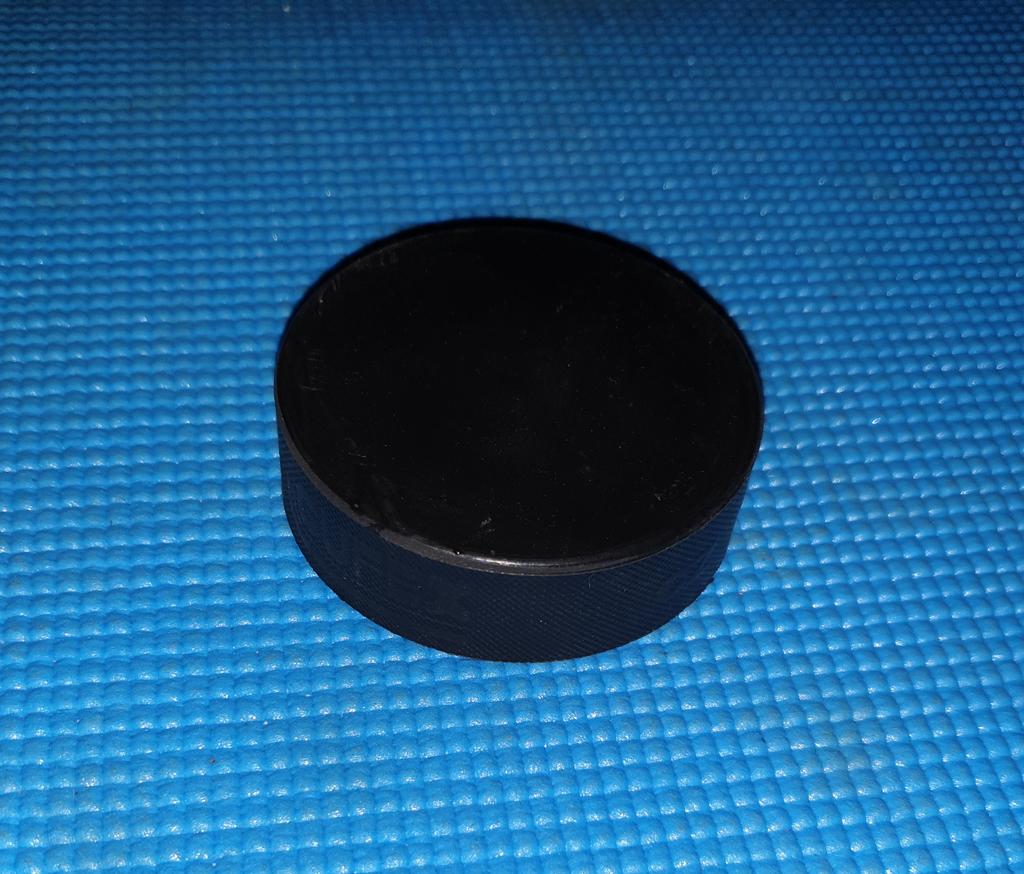

Mickwhitt 5,259 #1 Posted October 25, 2019 What is this mystery object, it's something I intend to transform into a part for my Eaton gear box. Share this post Link to post Share on other sites
RetroMower 350 #2 Posted October 25, 2019 Looks like a hockey puck. Seen a lot of those replacing body mounts in 80s chevy trucks lol 1 Share this post Link to post Share on other sites
The Tuul Crib 7,354 #3 Posted October 25, 2019 Seen a lot of those coming at me at the predators game ! l give up! Share this post Link to post Share on other sites
857 horse 2,588 #4 Posted October 25, 2019 WHEEL WEIGHTS BEFORE THE CENTER WAS MILLED OUT,,,,,,,,,,,,,,,,,,,, NEXT !!!!!!!!!!!!!!!!!!!!!!!!!!! 2 Share this post Link to post Share on other sites

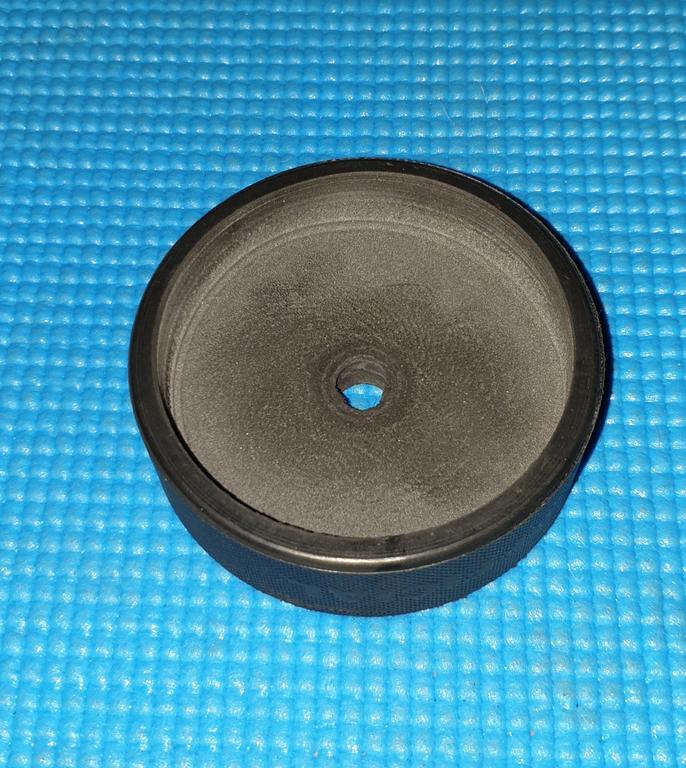

Mickwhitt 5,259 #6 Posted October 25, 2019 It is a hockey puck. Never seen them but was told they are useful for all kinds of things. Solid rubber and it is machinable in the lathe. So I drilled and hollowed one out to make a gear lever gaiter. Hopefully should let water drip clear of the ball joint. 4 3 Share this post Link to post Share on other sites

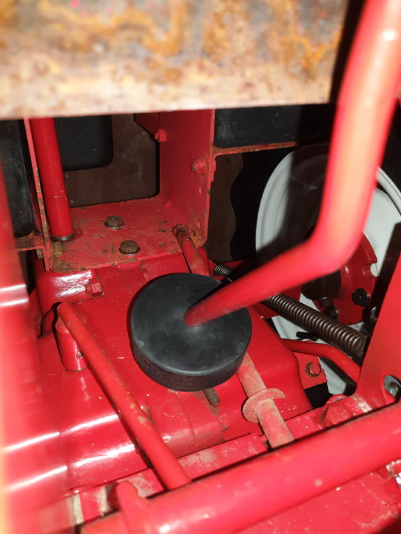

Mickwhitt 5,259 #10 Posted October 26, 2019 I fitted the hockey puck over the gear lever and it looks like it will work. 4 Share this post Link to post Share on other sites
Stormin 9,988 #11 Posted October 26, 2019 Looks like it belongs there. What happens when you move the gear lever? Is it flexible enough? Share this post Link to post Share on other sites
Mickwhitt 5,259 #12 Posted October 27, 2019 Because it's quite stiff it just sits in place like a kind of umbrella, it's not fixed to the top of the gear casing. It clears everything when the gear lever is moved through the gears so there are no problems with shifting. It's just a work on progress but I think it will do the job. Mick 1 Share this post Link to post Share on other sites
WHX?? 57,501 #13 Posted October 27, 2019 Now that is using the noggin for something other than a hat rack Mick. Wish I could think outside the box like that. Would a bit of silicone around the shifter help seal it to the shaft? 1 Share this post Link to post Share on other sites
Mickwhitt 5,259 #14 Posted October 27, 2019 Thanks 24, I bought the pucks months ago wondering what on earth I would use them for lol. I drilled the hole undersized so it grips the shift lever tightly. If it moves I will use silicone to seal it in place. Only drawback is I got loads of black stringy turnings all over my lathe lol 1 Share this post Link to post Share on other sites
