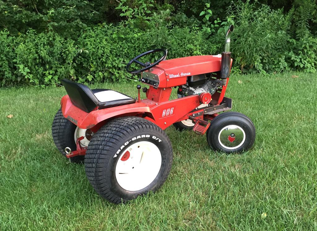

cschannuth 3,819 #8 Posted October 23, 2019 I upsized the engine pulley from 2.5” to 3.5” if I remember correctly. I put a Predator my dad bought for a project he never used on a 606 roller I bought cheap. Since I could move the engine around a bit I didn’t need to modify the belt guard much. It increased the top speed to about 8 mph. I use it to push snow in the winter and as a neighborhood cruiser the rest of the year. Other than the Lawn Ranger I got from Denny Clarke this is my favorite. 1 Share this post Link to post Share on other sites
