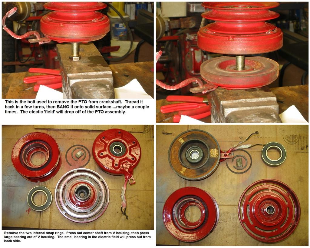

pfrederi 21,183 #2 Posted October 21, 2019 Check out my thread on Electric PTOs. You do not need a press. however getting it separated requires some serious slamming...There are some TSBs in the thread that you should look at. After you get yours open I can help you find bearings.. There were some changes over time. 1 Share this post Link to post Share on other sites

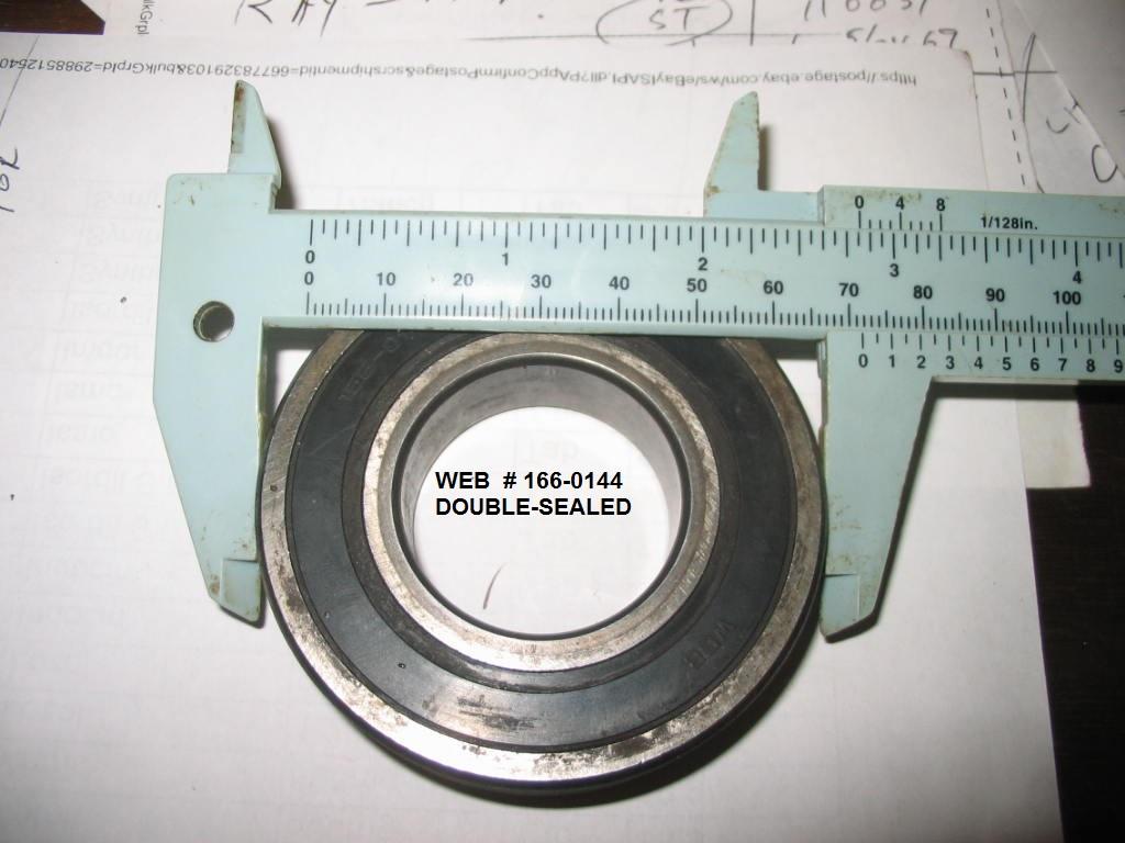

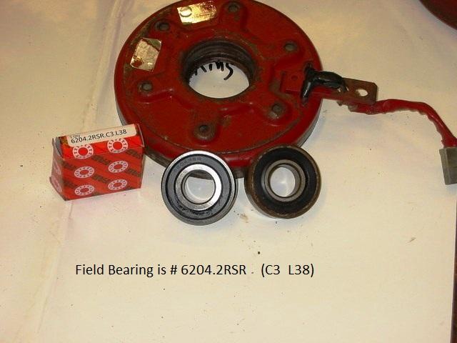

daveoman1966 3,884 #7 Posted October 22, 2019 (edited) 3 hours ago, Ch_Indy said: I have a pto like the one in this post. Is there a post that has the way of disassembling this clutch? I took off the snap rings hoping it would move with some firm hits, but it doesn't. I have access to a press, but again how to hold it up on the pulley is the trick. It could easily trash trash the coil and or the pulleys if it's not held evenly and firmly. I've successfully put bearings in the newer style clutches, but this one is stuck. It really needs new bearings. Thanks in advance. BTY my tractor is a mutt or perhaps a high bred in the horse world. C111 with a 12 hp Kohler. She is a great machine. I mainly blow snow with it and during the warm months I have a blade on it for moving dirt or stone. Thought I recognized that picture...it is from my archives. Here is another pic from my 'stash' that may help in taking the E-PTO apart to replace the bearings. The smaller Field Bearing is #6204-2RSR. I have a good used larger bearing # 166-0144 shown here. That 166-0144 bearing new is about $75 bux.... I can send you my good used bearing for $50...shipped. It has no drag and no wobble...wouldn't know it from new. Edited October 22, 2019 by daveoman1966 1 1 Share this post Link to post Share on other sites

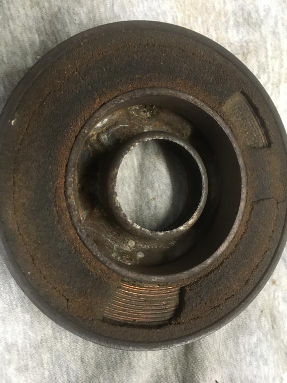

Ch_Indy 0 #8 Posted October 22, 2019 I took it apart tonight. It went pretty well. The larger bearing is an odd size. I did find this part number is a match. Nachi 6207X40Mm 2Rs. My PTO is pretty old, but it works good. In the picture you can see the protective material on the winding is coming apart. That didn't happen from pounding on it though. It was that way already. I was thinking about g some epoxy on it to seal it up. Anyone had any experience with this? Share this post Link to post Share on other sites
Ch_Indy 0 #9 Posted October 22, 2019 Okay the picture ate my text. I'll repeat what is missing. The cracks and missing material was already there before pounding on it. Also I was thinking of putting some epoxy on it to seal it. Anyone had any experience with this? Share this post Link to post Share on other sites
daveoman1966 3,884 #10 Posted October 23, 2019 (edited) I've used red silicone (or black) from a squeeze tube in preference to epoxy. Just pick away the loose sand-like material and smooth over with the silicone sealer. Silicone stays a little soft, unlike epoxy that gets hard. Let the sicicone dry a few hours before use. Edited October 23, 2019 by daveoman1966 1 Share this post Link to post Share on other sites

Ch_Indy 0 #12 Posted October 23, 2019 19 hours ago, daveoman1966 said: I've used red silicone (or black) from a squeeze tube in preference to epoxy. Just pick away the loose sand-like material and smooth over with the silicone sealer. Silicone stays a little soft, unlike epoxy that gets hard. Let the sicicone dry a few hours before use. Using silicone had crossed my mind. I'll go that route. One concern was interfering with the magnet strength, but silicone shouldn't affect that. Thanks again your help is greatly appreciated. There is a person on ebay that has several of the larger bearings for about $35 with shipping. So far I haven't seen a better price. https://www.ebay.com/itm/Nachi-6207X40Mm-2Rs-Deep-Groove-Ball-Bearing-2-Rubber-Seals-40Mm-Bore/133113121733?ssPageName=STRK%3AMEBIDX%3AIT&_trksid=p2060353.m1438.l2649 Share this post Link to post Share on other sites
