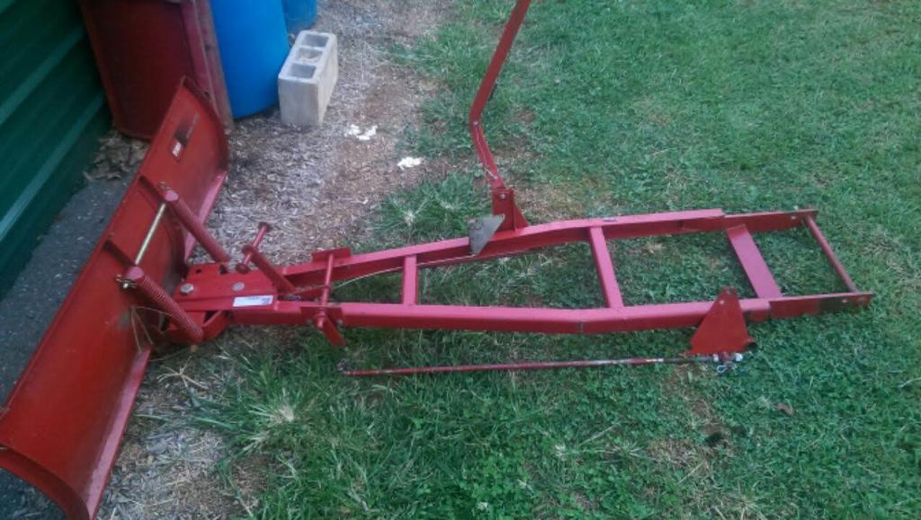

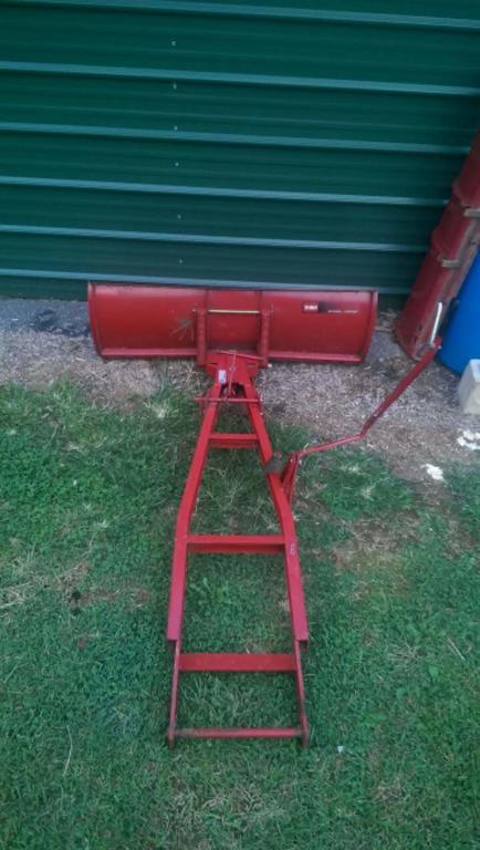

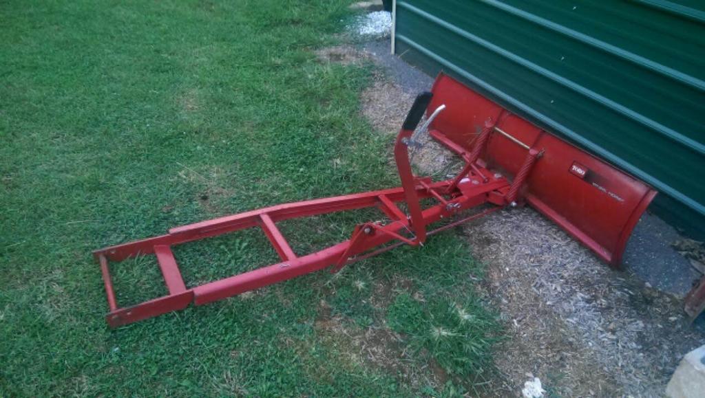

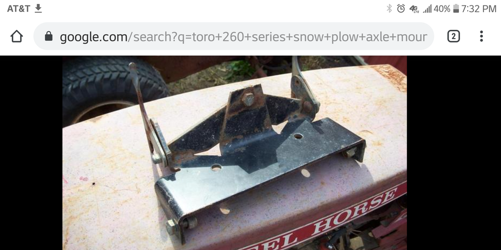

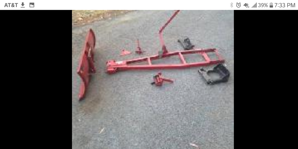

WVHillbilly520H 10,379 #2 Posted October 20, 2019 14 minutes ago, scotty said: My brother bought a 270H wheel horse and we were wondering what kind of plow would fit on it. Is it a standard blade? No the frame lift linkage angle from seat and rear axle bracket all different... They are rare as another member has been looking for one for his 269H ... I just can't recall the model number off the top off my head... Share this post Link to post Share on other sites

Stepney 2,356 #5 Posted October 21, 2019 They are different, yes. However the length and mounting is the same. I have a 269h plow on a Charger 9. I dont see why you couldn't adapt a standard blade to fit. Nothing more then adding a bend in the angle lever, and a T shaped rod/pipe up front. Share this post Link to post Share on other sites
