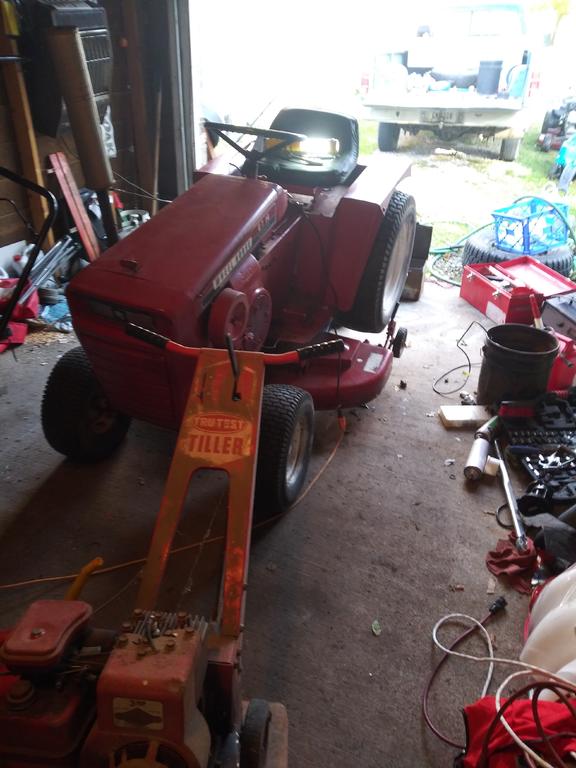

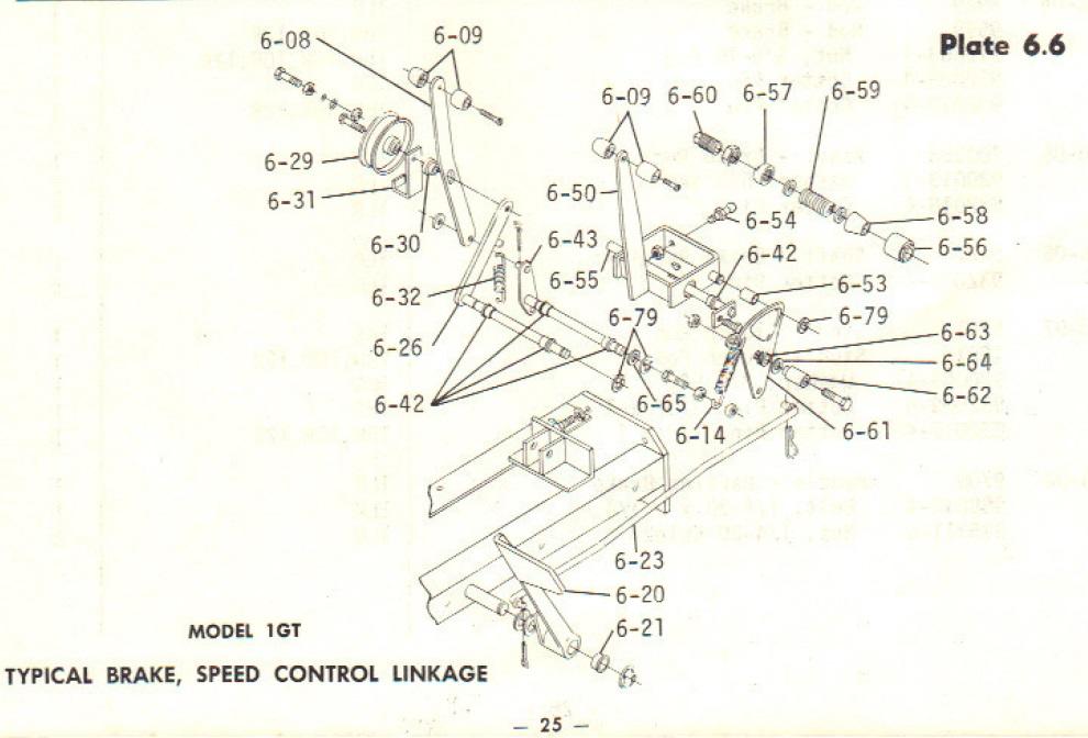

Owen1983 19 #1 Posted October 20, 2019 So i got the electrical figured out as well as the hydraulic lift. Now trying to figure out the brakes. The previous owner had a throttle cable hooked to the brake pedal for foot feed throttle. Would anyone have any diagrams that show the brake linkage and how it hooks up? 1 Share this post Link to post Share on other sites
gwest_ca-(File Mod) 12,535 #2 Posted October 20, 2019 Does this illustration from a 1971 parts list help Garry 2 Share this post Link to post Share on other sites
Owen1983 19 #3 Posted October 20, 2019 Yes it does! Thank you! Looks like i am missing a bolt and nut and a bushing. Probably have all of the parts in another box 3 Share this post Link to post Share on other sites
ZXT 2,402 #4 Posted October 20, 2019 1 minute ago, Owen1983 said: Yes it does! Thank you! Looks like i am missing a bolt and nut and a bushing. Probably have all of the parts in another box Keep in mind that these don't have a physical brake - only a parking brake when you have the hydro disengaged. All the brake pedal does is pull the transmission control lever back to neutral. 1 Share this post Link to post Share on other sites
Owen1983 19 #5 Posted October 20, 2019 That is what was throwing me off. I believe i am missing more than I thought. I gave up and went back to trying to figure out why the tires eat the deck when you lift the dexk. The tires seem to be original. Thought the front deck brackets were backwards but doesn't make sense on the right side 1 Share this post Link to post Share on other sites
