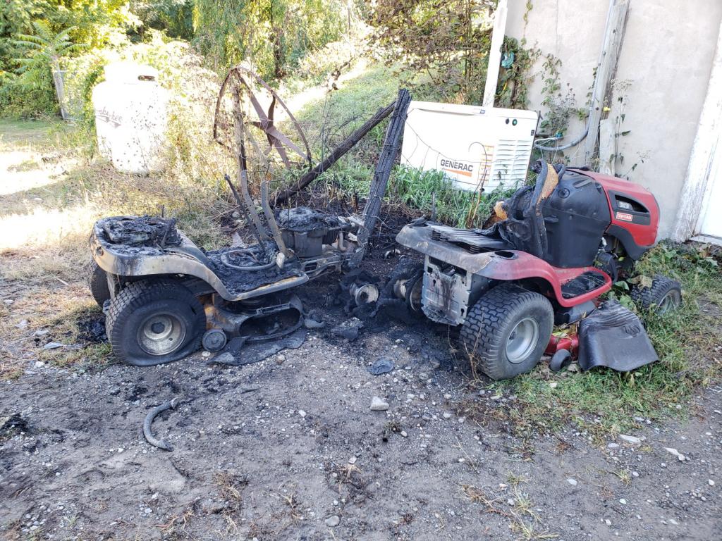

Burnerman 759 #27 Posted November 24, 2019 22 minutes ago, ebinmaine said: 11 hours ago, Burnerman said: Dude mine's only 23 horse. Yours has bigger horses though!!😁 The story behind the engine: A few months ago a friend calls and asks if I can fix her mower. It was a loaner from another friend of hers. Cub Cadet with a timed deck. Someone installed the wrong blades on it and it had jumped time and destroyed the blades. When I go to pick it up it’s parked behind her big Sears tractor. She said she just put a new battery in it but it wouldn’t start. ( it sat outside all winter). She borrowed the cub indefinitely f to mow with so she wasn’t worried about getting the Sears fixed. I told her I could take a look at it for her but never got time to with all my projects. Fast forward to Sept and she sends me this picture asking if I thought I could fix it. She had finished mowing with the cub and parked it right behind the Sears like always, started to walk to the house to get the weedwacker. She heard a noise and turned around to see the mower in flames. I figured that’s the end of the story. Then my son buys the V7 from the junkyard last week and the 7hp runs like crap, knocks and has no parts support. We decide to repower it and I remember the Sears. Lol I thought it would be long gone but her father just moved them down into the dump area on the farm. Luckily the engine and brand new battery survived the whole order unscathed. We ran the tractor carcass to the junkyard for her and brought the engine home. It’s going to be a tricky fit. The steering shaft runs super close to the crank and pulley on these things. Gotta bolt it in and go over the engine and see why it wouldn’t start. If it has major issues we may abort this project but it looks promising so far. 1 2 Share this post Link to post Share on other sites

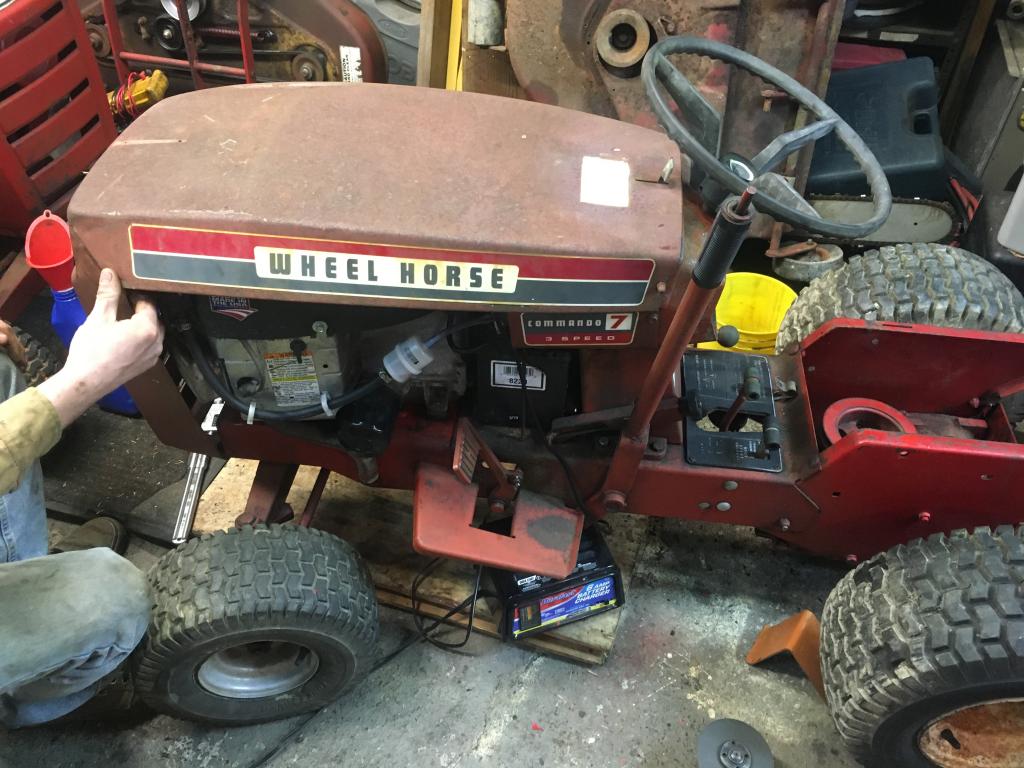

Burnerman 759 #28 Posted November 24, 2019 It’s alive. Muuhaahaa. We used the old 3 pole switch for now. We’re going to put a switch in where the choke cable was to energize the anti backfire solenoid. Gotta get a longer throttle cable but we may do a foot throttle after hearing it. Lol Gunna have to wire in a voltage regulator to the charging circuit. Jumps up to 18v when you rev it. IMG_6490.MOV Hood modifications are currently underway. 😂😂 2 1 Share this post Link to post Share on other sites
Burnerman 759 #29 Posted November 24, 2019 Got the hood to close. 1 1 Share this post Link to post Share on other sites
