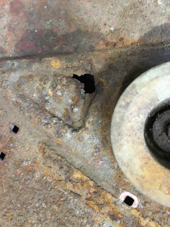

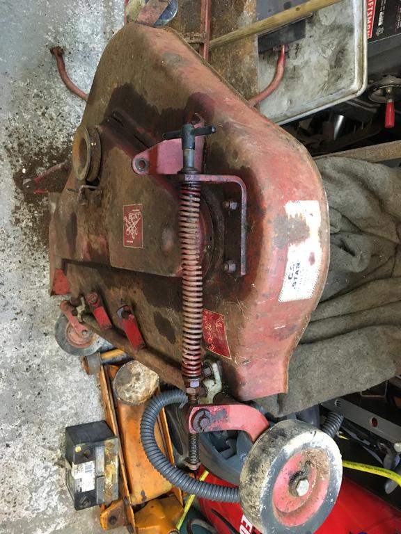

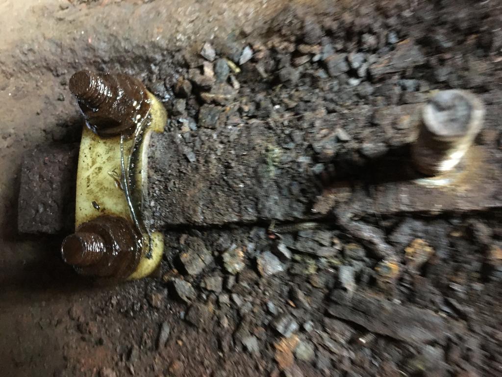

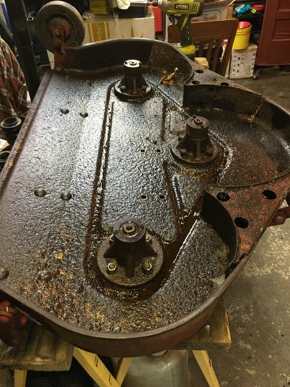

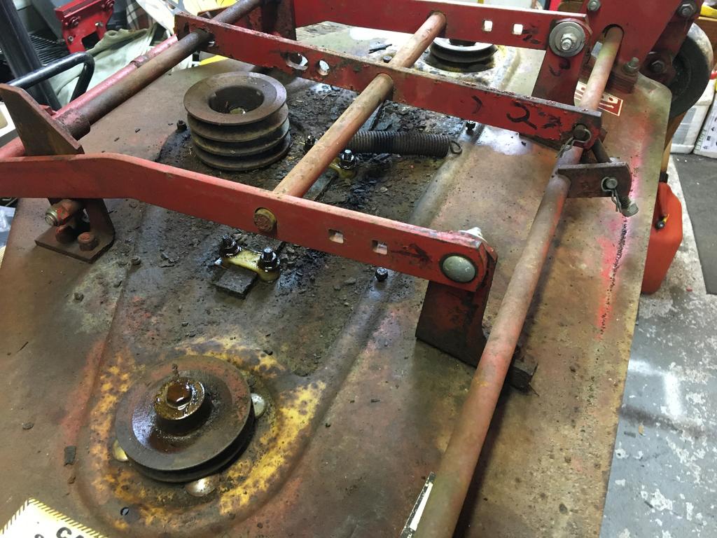

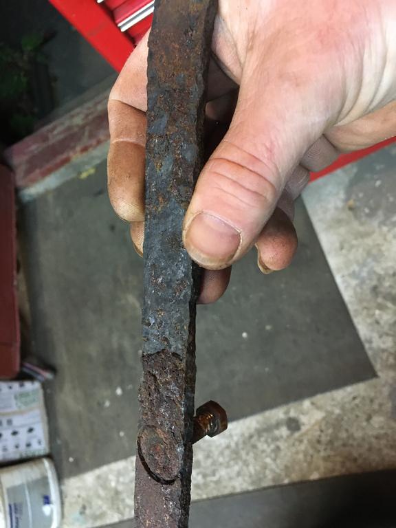

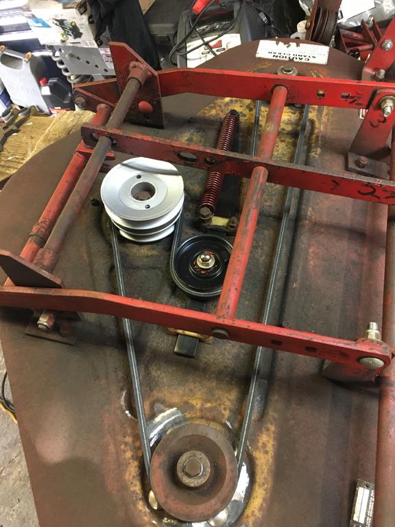

Burnerman 759 #1 Posted October 19, 2019 Tore into the 36” deck that was on the 72 Commando I picked up earlier this week. I got the tractor running and initial assessment looks like it maybe a keeper if I can use it to mow. The deck top is very rusty. The deck shell is also the thick steel and looks to be structurally sound. The idler bar is shot but the plastic slides are useable. 1 spindle is perfect. The center spindle has noisy bearings and the double pulley is wallowed out a bit. I found the PO had wedged a feeler Gaige in to take up the slop. The other spindle has bad bearings also. I’m giving the deck shell an oil bath before needle scaling. What’s left of the idler bar. The good is there’s 3 brand new blades on the deck. Probably installed when the new spindle was installed. Any opinions on which direction to go? I can get nos parts to rebuild it to original for prolly $250. Is there a more economical course of rebuild with parts that aren’t discontinued? Share this post Link to post Share on other sites

Burnerman 759 #4 Posted October 26, 2019 Got all my parts and put it together today. 1 1 Share this post Link to post Share on other sites

Lee1977 7,750 #7 Posted November 16, 2019 The nylon slides can be turned around once as the are only worn on one side if they have never been turned. The belt will hold it to that side. 1 Share this post Link to post Share on other sites
Burnerman 759 #8 Posted November 17, 2019 22 hours ago, Tach-a-matic said: very helpful post i have the same deck and problems I got 3 replacement spindle shafts with bearings on eBay for around $40 iirc. I used my shop press to press out the old and press in the new. I reused my plastic slides but got a set of spares from a member here along with a good slide bar. A new center pulley, idler pulley and spring rounded out the parts. there were a bunch of cracks around the one side spindle that we welded up. It works very good now. Share this post Link to post Share on other sites

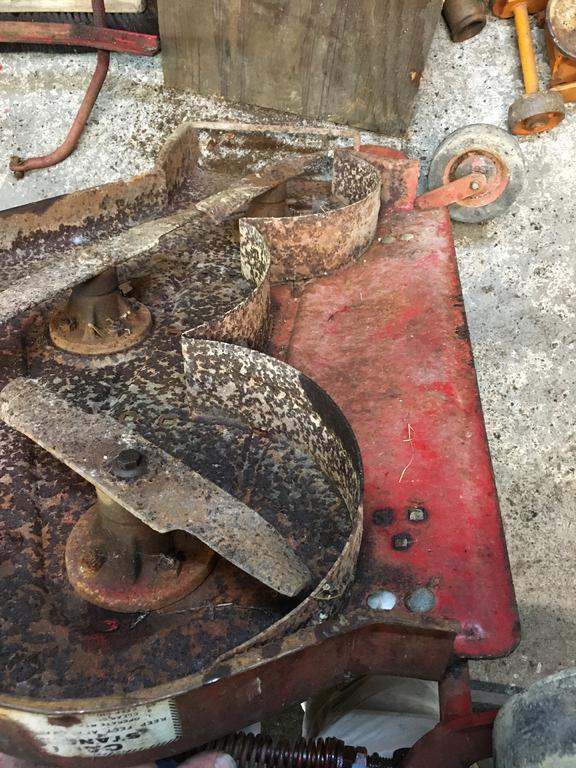

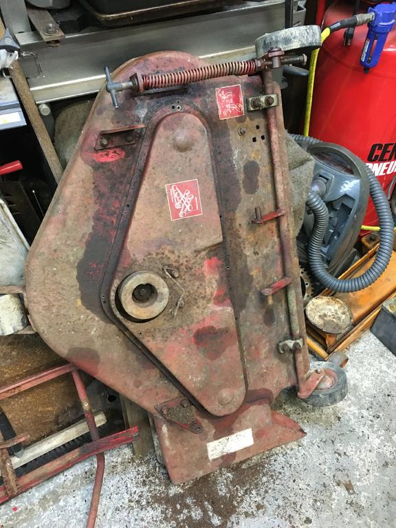

Burnerman 759 #9 Posted November 17, 2019 My sons V7 Commando has this 36” deck. It’s the exact same deck stamping, blades, belt tensioner and spindles as mine but the rest is all different. The height adjustment, the center pulley is much taller and it’s a side discharge. The back of the stamping is the same they just added a baffle underneath. There are rust holes but if the steel is the same gauge as mine it can prolly be patched. If not I have a spare set of blades! Share this post Link to post Share on other sites

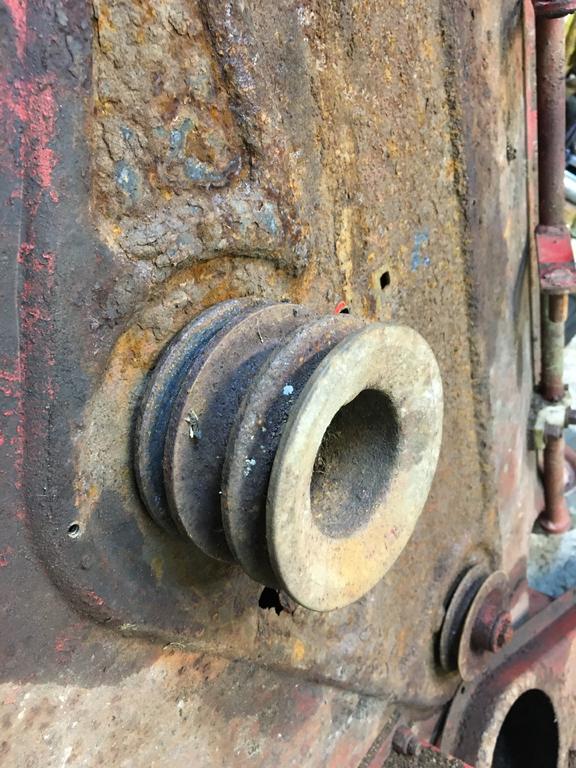

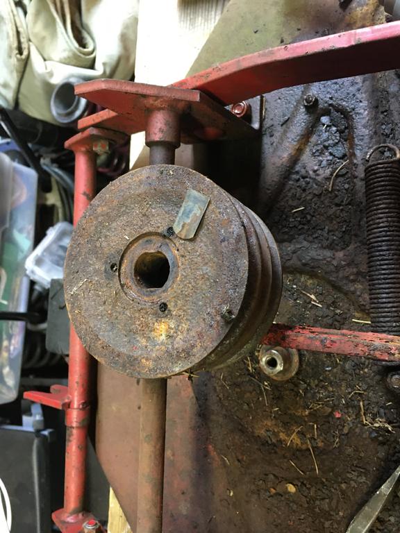

Tach-a-matic 357 #10 Posted November 18, 2019 (edited) I tried removing the outer pulleys today on mine and they fell apart in my hands because they were so rusty. I blame this on the belt cover which traps in grass/moisture. And of course someone who never bothered to take it off and clean the area out from time to time. Or take it off and leave it off. So I need bearings for all three spindles, a belt, three blades and now two pulleys as well. This is going to be expensive. Maybe too expensive Edited November 18, 2019 by Tach-a-matic Share this post Link to post Share on other sites
tom2p 2,396 #11 Posted November 18, 2019 13 minutes ago, Tach-a-matic said: I tried removing the outer pulleys today on mine and they fell apart in my hands because they were so rusty. I blame this on the belt cover which traps in grass/moisture. And of course someone who never bothered to take it off and clean the area out from time to time. Or take it off and leave it off. So I need bearings for all three spindles, a belt, three blades and now two pulleys as well. This is going to be expensive. Maybe too expensive also possible the deck sat outside Share this post Link to post Share on other sites
Burnerman 759 #12 Posted November 18, 2019 The belt cover definitely traps moisture and grass clippings. Parts for these decks are getting hard to find. I’ve seen posts where folks have converted to the newer spindles but either way it can get pricey. Share this post Link to post Share on other sites
gwest_ca-(File Mod) 12,452 #13 Posted November 18, 2019 The blades on the Commando V7 deck should be different because it has a left side discharge. Spindles turn counter-clockwise when viewed from the top. Garry Share this post Link to post Share on other sites
