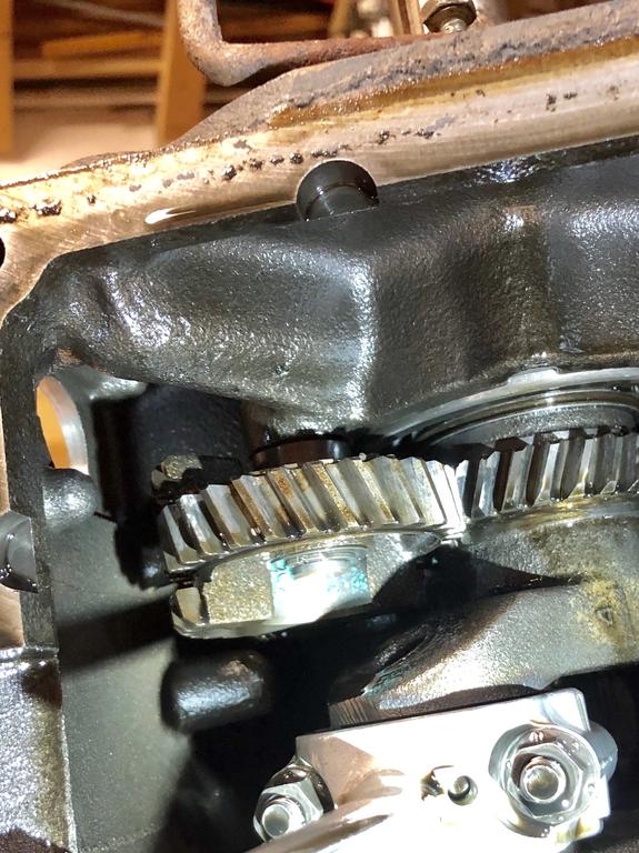

Cetan08 311 #1 Posted October 18, 2019 Yesterday I tore into an old K-321 to rebuild. Had no compression. Top ring was fair. Second ring was sticking at times. Oil ring completely worn out and stuck in the Piston. Cylinder is in great shape and the Piston has .003 stamped on the top so I assume it is standard. Pulled the pan and perfectly clean inside but one of the balance gears is wiped out. By this I mean that all the teeth are gone. It wobbles on the shaft. I have another gear but what would cause this? Thanks Share this post Link to post Share on other sites
ZXT 2,402 #2 Posted October 18, 2019 (edited) Personally, I’d remove the gears altogether. Looks like you caught it in time. You’re lucky they didn’t decide to exit the block. They don’t help vibration hardly at all, and by removing them you’d be removing the weakest link inside the engine. Edited October 18, 2019 by ZXT 5 1 1 Share this post Link to post Share on other sites
richmondred01 2,383 #3 Posted October 18, 2019 Pull them out. When they go it’s like a grenade thrown into a tank. I remove them on all my rebuilds. After 40 years I never had anyone said that the engine vibrated any more or less. 2 2 Share this post Link to post Share on other sites
The Tuul Crib 7,354 #4 Posted October 18, 2019 (edited) I just put up a thread about this the other day. Mine are coming out of my motor as well. Although mine is all intact I will be leaving them out when I put the motor back together. They are calling them grenade gears ! Edited October 18, 2019 by The Tool Crib 1 Share this post Link to post Share on other sites
953 nut 67,723 #5 Posted October 18, 2019 3 hours ago, Cetan08 said: It wobbles on the shaft. You tore that engine down just in time! That gear was about ready to ruin your engine block. Toss out the entire balance gear assembly. 2 Share this post Link to post Share on other sites

Cetan08 311 #11 Posted October 18, 2019 6 hours ago, AMC RULES said: If the gear was wiped... how was the pan perfectly clean? Looks like someone has flushed the engine because there wasn't a drop of anything inside just clean metal. No other damage anywhere. 1 Share this post Link to post Share on other sites
squonk 47,485 #12 Posted October 19, 2019 I bet that cylinder is out of round. I would have a machine shop check it at least. 2 Share this post Link to post Share on other sites
richmondred01 2,383 #13 Posted October 19, 2019 While it’s torn down check the crank too. 95% of all my rebuilds the cranks are out of round and typically off by several thousands. its cheap insurance of 75.00 to get it turned. Then you are done for another 30 years of service. Like squonk said the cylinder is likely out of round and needs to be bored. Get it done right once. 2 Share this post Link to post Share on other sites
clueless 3,430 #14 Posted October 19, 2019 50 minutes ago, squonk said: I bet that cylinder is out of round. I would have a machine shop check it at least. If you don't have the capability to measure the cylinder accurately then have a machine shop do it, money well spent. As far as the gears, take them out, nothing wrong with a little Kohler vibration, it's " Good Vibrations" . Share this post Link to post Share on other sites
