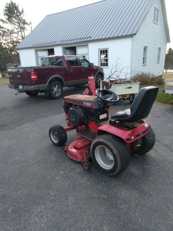

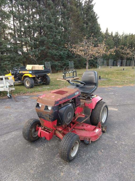

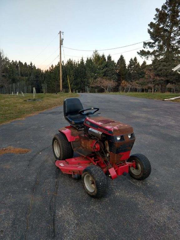

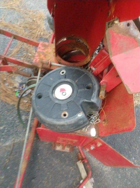

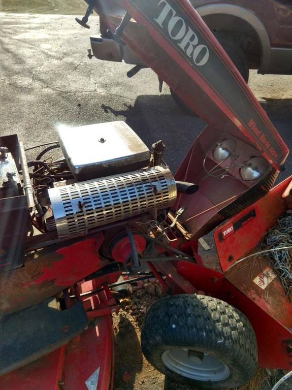

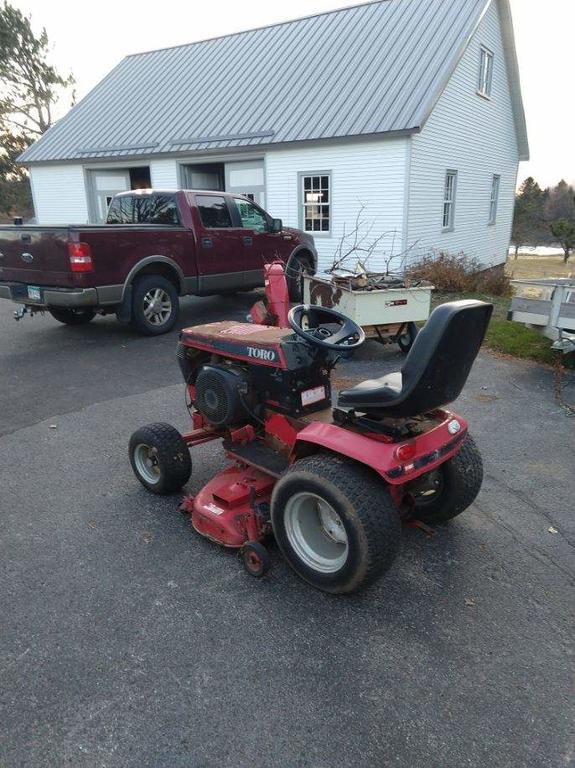

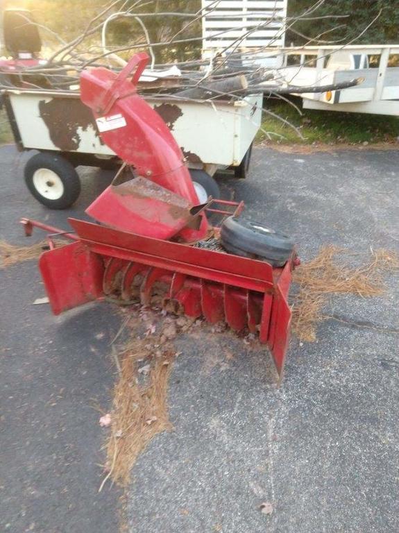

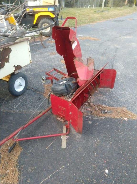

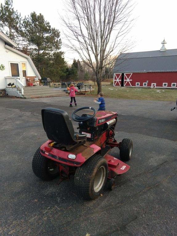

wheelwhores 107 #80 Posted November 6, 2019 ***UPDATE*** on my search of a redrocket So i think i may have found a nice project machine, it's a few hours away but here is what i know. Ask is $500. 520H, 434 hours. comes with wheel weights, chains, snow blower and mower deck. Good runner, but sheet metal is rusty.pulley on mower deck keeps jumping off and snow blower main gear teeth are worn down enough to make it inoperable, so that might be a good negotiation point. 2 Share this post Link to post Share on other sites

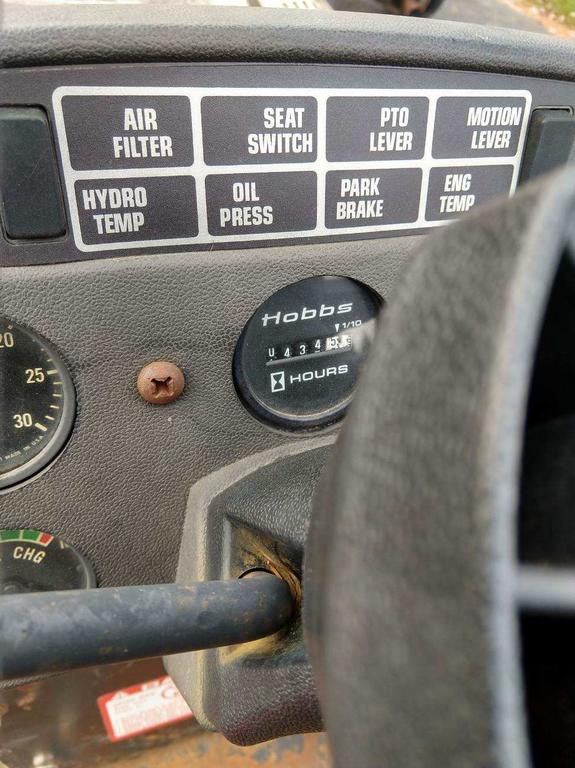

wheelwhores 107 #81 Posted November 6, 2019 Not sure what you guys can glean from these photos but i would love the input! Share this post Link to post Share on other sites
peter lena 10,109 #82 Posted November 6, 2019 wheelwhores , my initial impression was a pretty good deal, that you might even improve on given the shape and neglect of what i am seeing. hours on tractor are good , its lack of care make it look like a train wreck. you will have to thoroughly baseline the service on the tractor to verify what you have. the finish is rough , but if its a good runner , paint prep will make it new. the blower has to be rebuilt, those worn gears , reflect no lubrication during use. the mower deck is probably totally neglected also . what you manage to recover from the deal , is up to you. keep us informed , pete Share this post Link to post Share on other sites
ZXT 2,402 #83 Posted November 7, 2019 1 hour ago, wheelwhores said: Not sure what you guys can glean from these photos but i would love the input! Looks rough but with that low of hours... Dang! Have you verified that the hour meter works? I'd check that for sure. Could be broken and have 2400 hours on it. I'd negotiate a bit but I don't see how you could get hurt. Might be rough but it'll make a great work tractor. Share this post Link to post Share on other sites
wheelwhores 107 #84 Posted November 7, 2019 2 hours ago, peter lena said: wheelwhores , my initial impression was a pretty good deal, that you might even improve on given the shape and neglect of what i am seeing. hours on tractor are good , its lack of care make it look like a train wreck. you will have to thoroughly baseline the service on the tractor to verify what you have. the finish is rough , but if its a good runner , paint prep will make it new. the blower has to be rebuilt, those worn gears , reflect no lubrication during use. the mower deck is probably totally neglected also . what you manage to recover from the deal , is up to you. keep us informed , pete Also aside from good sheet metal and freely spinning spindles what should I check for on the deck? 2 hours ago, peter lena said: How difficult and costly is a rebuild on the blower? Mechanically I'd imagine their pretty simple assembly so not too worried about level of dificulty/effort. Am I correct in that it's the more desirable tall chute version? Not sure if it's 1 or 2 stage. 2 hours ago, peter lena said: Pete when you say baseline what do you mean?...remember I'm a quick study but a rookie. Do you mean do all the required service back a ways to make sure it's all good to go from that standpoint? 1 Share this post Link to post Share on other sites
wheelwhores 107 #85 Posted November 7, 2019 1 hour ago, ZXT said: Looks rough but with that low of hours... Dang! Have you verified that the hour meter works? I'd check that for sure. Could be broken and have 2400 hours on it. I'd negotiate a bit but I don't see how you could get hurt. Might be rough but it'll make a great work tractor. How do you verify the meter works...just run it for a while and watch? I'm hoping for somewhere in the 3-400 range. I figure even as a parts machine it's worth that. 2 Share this post Link to post Share on other sites
PeacemakerJack 11,080 #86 Posted November 7, 2019 I saw this one and was mildly interested but it is about 5 hours away for me...one way. If it was closer, I would’ve pursued it for sure. That said...if it has a functional battery on it and you turn the key to the run position, and wait a little bit, you will hear the hourmeter click and make some noise indicating that it is running. With that kind of rust on the sheet metal, look over the wiring and any parts that need to move and make sure that you have a good idea of what condition it is in. Sometimes when they look like that, they are severely neglected in every way. Sometimes, they have just been stored outside but yet the maintenance has been kept up...check the oil, rear end fluid, look for fresh grease at the spindles and pivot points. That said, anything can be fixed but you have to decide how much you want to put into something. I think that you can try to deal on it as the others have mentioned but if it runs decent and functions, it would make a nice worker... 2 Share this post Link to post Share on other sites
wheelwhores 107 #87 Posted November 7, 2019 11 minutes ago, PeacemakerJack said: I saw this one and was mildly interested but it is about 5 hours away for me...one way. If it was closer, I would’ve pursued it for sure. That said...if it has a functional battery on it and you turn the key to the run position, and wait a little bit, you will hear the hourmeter click and make some noise indicating that it is running. With that kind of rust on the sheet metal, look over the wiring and any parts that need to move and make sure that you have a good idea of what condition it is in. Sometimes when they look like that, they are severely neglected in every way. Sometimes, they have just been stored outside but yet the maintenance has been kept up...check the oil, rear end fluid, look for fresh grease at the spindles and pivot points. That said, anything can be fixed but you have to decide how much you want to put into something. I think that you can try to deal on it as the others have mentioned but if it runs decent and functions, it would make a nice worker... Only about 2 for me still a trek though Share this post Link to post Share on other sites

oliver2-44 11,820 #89 Posted November 7, 2019 On the mower deck look for: Any holes are sever rust on deck shell, especially under pulleys where wet grass piles up. What condition the semi circle baffels under the deck around the blades are in What condition the rollers are in What condition the blade spindle housings are in. if they are aluminum they get corroded away by wet grass What condition the mule drive pulleys bearings are in. Share this post Link to post Share on other sites

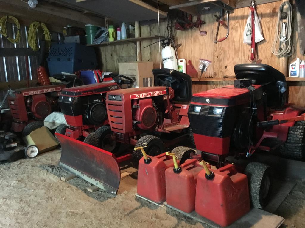

Lost.soul.collecter 76 #90 Posted November 7, 2019 hope you love your first wheel horse I started with one the 520-8 and fell in love with them now I own 5 and I'm about to go and buy 2 more this weekend it's like a addiction lol 2 2 Share this post Link to post Share on other sites

WVHillbilly520H 10,379 #92 Posted November 7, 2019 (edited) Yes that is the more desirable SINGLE stage tall chute thrower as long as the auger sprocket isn't worn off all the other pieces are easy fixes... I bought a '95 520 with 236 actual hours and it looked nearly as bad as that if they used it to throw salted snow that could explain the rust anyways it's worth what you are willing to pay and happy with in the end. Edited November 7, 2019 by WVHillbilly520H 1 Share this post Link to post Share on other sites
Pullstart 71,520 #93 Posted November 7, 2019 @wheelwhores I’m not very interested in later model tractors, but I’ll let you in on a little saying that’s spoken here once in a while. RUN, DON’T WALK! That probably won’t last long at that price... there is a lot of value in the tractor as just parts, if that is the case. 1 Share this post Link to post Share on other sites
wheelwhores 107 #94 Posted November 7, 2019 3 minutes ago, WVHillbilly520H said: Yes that is the more desirable SINGLE stage tall chute thrower as long as the auger sprocket isn't worn off all the other pieces are easy fixes... I bought a '95 520 with 236 actual hours and it looked nearly as bad as that if they used it to throw salted snow that could explain the rust anyways it's worth what you are willing to pay and happy with in the end. It sounds like it was primarily a snow mover...which would explain maybe why the blow gear is gone, near canada do heavy snow fall up that way. It's a family machine that was passed from one cousin to another and then down to the son, so third own (I'd be 4th). Share this post Link to post Share on other sites
WVHillbilly520H 10,379 #95 Posted November 7, 2019 BTW I have cut off the auger sprocket and machined/welded a new to the auger. Share this post Link to post Share on other sites

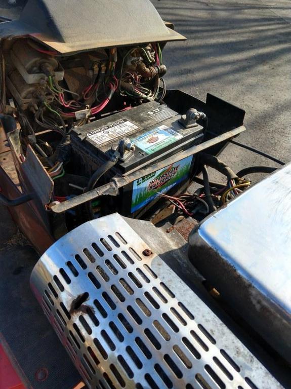

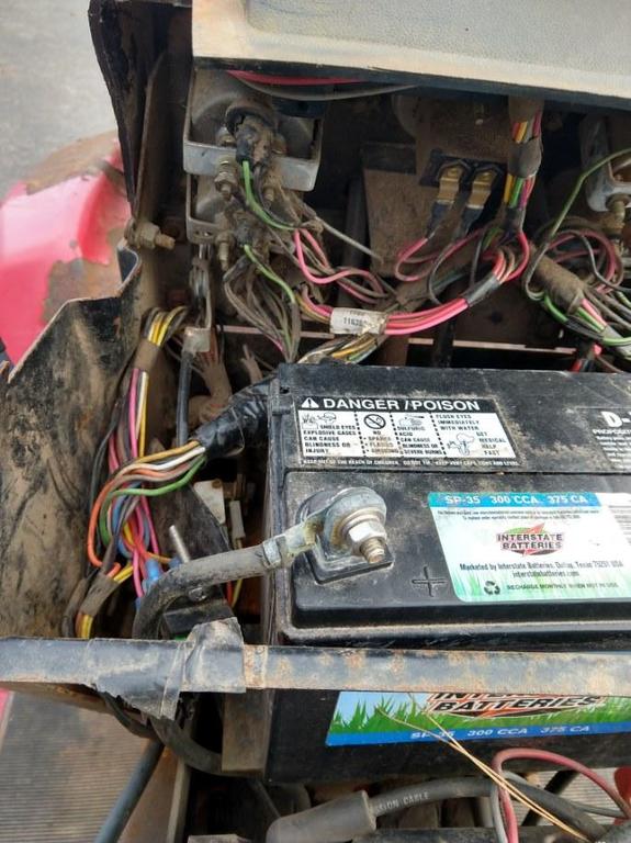

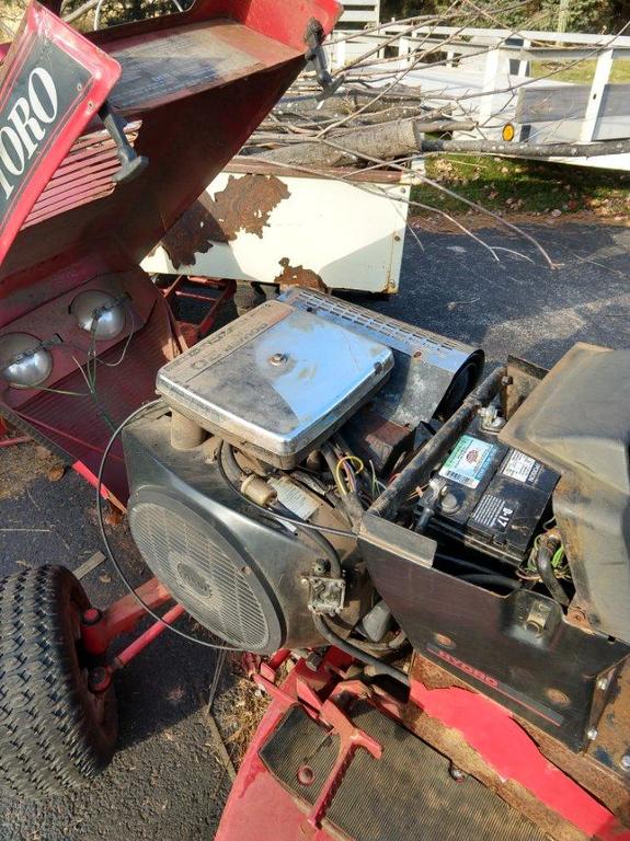

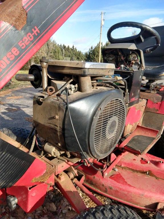

wheelwhores 107 #96 Posted November 7, 2019 More pictures of the guts of the machine for your review :). Sounds like the hour meter is working, he ran it for about a half hour and that is what ticked off on the meter. 1 Share this post Link to post Share on other sites
wheelwhores 107 #97 Posted November 7, 2019 18 hours ago, peter lena said: wheelwhores , my initial impression was a pretty good deal, that you might even improve on given the shape and neglect of what i am seeing. hours on tractor are good , its lack of care make it look like a train wreck. you will have to thoroughly baseline the service on the tractor to verify what you have. the finish is rough , but if its a good runner , paint prep will make it new. the blower has to be rebuilt, those worn gears , reflect no lubrication during use. the mower deck is probably totally neglected also . what you manage to recover from the deal , is up to you. keep us informed , pete Also aside from good sheet metal and freely spinning spindles what should I check for on the deck? 18 hours ago, peter lena said: How difficult and costly is a rebuild on the blower? Mechanically I'd imagine their pretty simple assembly so not too worried about level of dificulty/effort. Am I correct in that it's the more desirable tall chute version? Not sure if it's 1 or 2 stage. 18 hours ago, peter lena said: Pete when you say baseline what do you mean?...remember I'm a quick study but a rookie. Do you mean do all the required service back a ways to make sure it's all good to go from that standpoint? Share this post Link to post Share on other sites
Pullstart 71,520 #98 Posted November 7, 2019 Good Lord that’s a lot of wires! I still maintain the Run, Don’t Walk attitude... If you can poke and prod the deck for rusted through spots, or run it while listening for quiet or noisy spindles, that should be enough inspection... however if the deck was total junk, it would still be a good deal. All still coming from a guy who’d much rather stick with the 50’s-70’s models. 1 1 Share this post Link to post Share on other sites
Darb1964 1,176 #99 Posted November 7, 2019 I would buy that tractor, gem 💎in the rough!! 1 Share this post Link to post Share on other sites
peter lena 10,109 #100 Posted November 7, 2019 baseline maintenance is verifying that all lubrication is new and fresh, greasing included , jack up front end so the lower end of axle bend gets grease, next up your electrical set up probably has some corroded connections , i would pull every slide on and lightly sand the slide on point, then lightly dielectric grease each point to insure the connection. i would change the trans oil and filter, that mower deck is probably packed with rotted grass and wiped out blades. if its solid and no rust or rot, you can plan on rebuilding the spindles and belt set up, the blower chain driven gearing for the main auger can be replaced along with the pto driven pulleys and belt. i would go after getting it into a solid running state, much later if you want to do a paint and clean up . you have a lot to do, that tall chute blower favors dry powdery snow , short chute for wetter snow. i can,t go into detail here on all of it , go after the worst or predominate areas first, let us know how you are doing , many of us have done similar recoveries , good luck , pete Share this post Link to post Share on other sites
