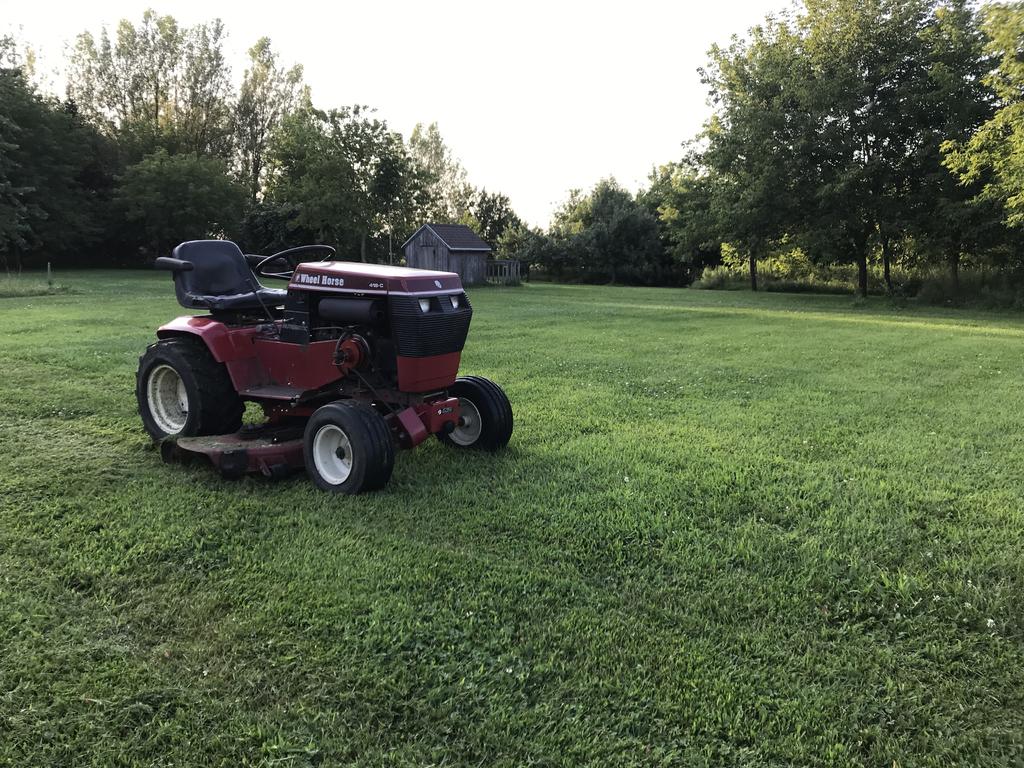

PeacemakerJack 11,080 #9 Posted October 16, 2019 to THE forum. As stated, lots of options there...first you have to decide if you are partial to gear drive or hydro tranny. For what you listed, mowing and blowing, I personally would recommend a hydro for speed control and ease of use. The C series are easy to maintain and work on, many different engine sizes and options available. However, my recommendation would be a 300, 400, or 500 series hydro like my sons 418... Share this post Link to post Share on other sites

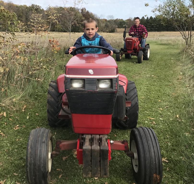

PeacemakerJack 11,080 #19 Posted October 16, 2019 (edited) Hydrostatic trannys offer basically seamless transition from forward to reverse by moving the speed control lever back and forth. You don’t have to clutch, and then select a gear. this is my youngest (5yrs old) driving his big brothers hydro with ease. Can’t reach the clutch pedal yet but simple for him to push/pull the hydro control lever handle! From a dead stop to the top speed of the machine, you have infinite range. If your lawn and driveway are situated where you need to change directions or speeds a lot, hydro is the way to go. I love gear drives for ground engaging implements like tillers , sod plows, cultivators, etc... Gear drives are simpler to maintain, but the Sundstrand and Eaton Hydros put in the WH GT’s are stout and last a LONG Time... Edited October 16, 2019 by PeacemakerJack 3 Share this post Link to post Share on other sites
