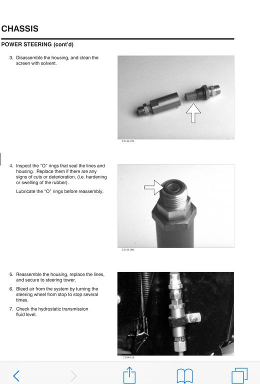

Redisbest 22 #1 Posted October 16, 2019 Does anyone know where the power steering filter is...I have a parts manual and I can't find that or section for adjusting hydostatic foot sensitivity.....if anyone could enlighten me I'd appreciate it. Share this post Link to post Share on other sites
gwest_ca-(File Mod) 12,535 #2 Posted October 16, 2019 Do you have the service manual for the 5xi? Item #13 is a screen for $152.82. Looks like an inline filter. https://www.partstree.com/models/73561-522-xi-toro-garden-tractor-sn-220000001-220999999-2002/steering-tower-fuel-tank-supports-assembly-35/ Garry 2 Share this post Link to post Share on other sites

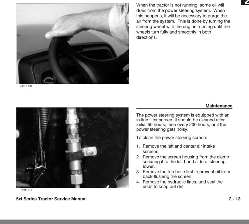

Redisbest 22 #4 Posted October 23, 2019 Thank you so very much.... I was looking at that very item...I thought it was a check valve.... in my ultimate wisdom ....thanks..it will get cleaned with new o rings if still available...or fit a size....thanks a ton...I would like a manual....for valve & or hydostatic adj....but for the price I will just keep service to a common sense nature. Share this post Link to post Share on other sites
Redisbest 22 #5 Posted October 23, 2019 Gary... I don't know how I missed this in the manual section.....thanks again as always...you have helped me a lot... Share this post Link to post Share on other sites
