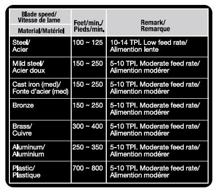

gwest_ca-(File Mod) 12,519 #3 Posted October 14, 2019 I use bi-metal blades and no lubricant. The secret is a very slow blade speed so if this is a traditional wood bandsaw it needs to be modified. The specs are in blade feet per minute so you can practise your math skills. The included chart is from the manual of an 18" wood/metal saw. Picture yourself using a hacksaw. That is the pressure and speed you need. Garry 2 1 Share this post Link to post Share on other sites

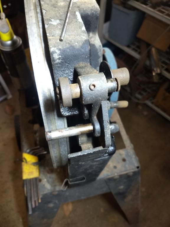

ebinmaine 81,035 #15 Posted December 22, 2019 On 11/13/2019 at 8:59 PM, Lee1977 said: pictures of the saw Well I finally took a few hours and got this saw up and running. When we got it from @wallfish it had a spent 1/4" wide blade. In order to install the new 1/2" blade I took ALL the points of adjustment apart to remove corrosion and lube things up. I need to make some kind of adjustable down pressure to keep the belt tighter. Other than that it works great! THANKS again John!!!!!! 1 Share this post Link to post Share on other sites

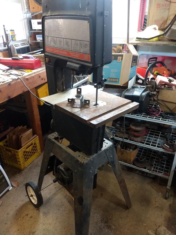

Mickwhitt 5,259 #19 Posted December 22, 2019 Hi Eric, I would steer clear of cutting any metal with your new saw, it looks like a light weight wood saw, a completely different beast to a metal cutting bandsaw. No matter what kind of blade you buy this machine will be way too fast to cut metal. Unless you can step it down with pulleys or some kind of inverter I would stick with cutting wood or plastics. I bought a plasma cutter in preference to a bandsaw recently. Takes up much less room and is more versatile. The bandsaw is ok for some tasks but not much. A horizontal bandsaw is much more use in a home shop for cutting up stock. Just my back yard engineers opinion. Mick 1 1 Share this post Link to post Share on other sites

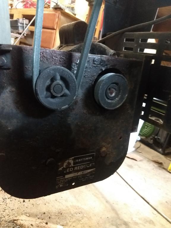

ebinmaine 81,035 #20 Posted December 22, 2019 2 minutes ago, Mickwhitt said: this machine will be way too fast to cut metal Not a commercial saw. Definitely a metal cutting type. Gear reduction... Left pulley is slow speed for metal. Share this post Link to post Share on other sites
MikMacMike 494 #21 Posted December 22, 2019 7 minutes ago, Mickwhitt said: Hi Eric, I would steer clear of cutting any metal with your new saw, it looks like a light weight wood saw, a completely different beast to a metal cutting bandsaw. No matter what kind of blade you buy this machine will be way too fast to cut metal. Unless you can step it down with pulleys or some kind of inverter I would stick with cutting wood or plastics. I bought a plasma cutter in preference to a bandsaw recently. Takes up much less room and is more versatile. The bandsaw is ok for some tasks but not much. A horizontal bandsaw is much more use in a home shop for cutting up stock. Just my back yard engineers opinion. Mick Absolutely right Mickwhitt, I have a heavier 12" throat band saw and Id never touch metal to it. As I use it for fine cabinet making and re-sawing lumber. Depending on the plasma cutter most light weight ones we have for 110 volts I personally wouldnt go over 14" thick metal or max 3/8"....the cut becomes a little ragged. We use a 220 volt Lincon plasma over at my brothers shop and it cuts excellent up to 5/8" I just havnt tried anything heavier. For most things I love to use grinders, 4", 6" and a 8" with cutting wheels that are I think the thinest 1/16"...no thicker, i see some guys cutting with 1/8" wheels.....seriouse time, metal, and wheel waster. There is another way too that I was thinking of trying and that is getting a porta band.....Im a Milwaki or Ridgid tool kind of guy and there the only ones that last especially in heavy duty pipe fitting....eg..6 foot dia piping all the way down to spagetti pipe. Really though for versatility you cant beat a hand grinder. There are also good used chop saws out there you can use fiber blades with or preferable a metal blade that are great for cutting metal stock also. I was thinking of getting a porta band so I can use it by hand or there are adapters too that will turn it into a stationary band saw for metal stock also. I have seen some wild and quite destructive blow outs though, not funny at the time when someone gets hurt but afterwards you sure could make some wicked funny moments on glue tube lmao. Mike Share this post Link to post Share on other sites
ebinmaine 81,035 #22 Posted December 22, 2019 @Mickwhitt and @MikMacMike Just to clarify the operation here ... When I use this saw I'm going EXTREMELY SLOW..... As stated above this is a metal usable saw but not super heavy duty. It's better than a hacksaw, jigsaw, or sawzall... Which are my previous metal cutting options... Nice square clean cuts with little to no burrs or roughness. And faster than anything else I have. Best way ? Certainly not. Best way I currently have? Absolutely. Share this post Link to post Share on other sites

wallfish 20,718 #25 Posted December 23, 2019 That saw will work perfectly fine for what Eric's using it for. With that type of belt on there, you may need to add weight to the motor carriage or a spring for tension. Using a raw edge and or cogged belt will help with grip to those small diameter pulleys 1 Share this post Link to post Share on other sites
