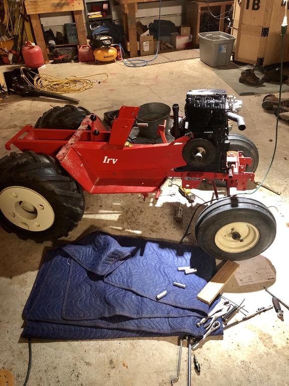

The Tuul Crib 7,340 #1 Posted October 13, 2019 Since l picked up the 8 horse no name ive used a few parts to up date IRV. Now i'm using a few more parts again. Im replacing the center tower so that l can put the larger gas tank and the newer pto set up. I am also replacing the 14 horse motor that is on it because of the crank bearings are making some noises. I'm transplanting the 12 horse from my old 312-8 for now until I rebuild the 14 hp . 10 4 Share this post Link to post Share on other sites

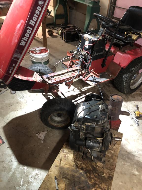

The Tuul Crib 7,340 #3 Posted October 13, 2019 OK here's my next step in the process taking the 12 horse off my old 100 dollar turd! This motor is in great shape with only 650 hours on it. Houston we have separation! 1 Share this post Link to post Share on other sites

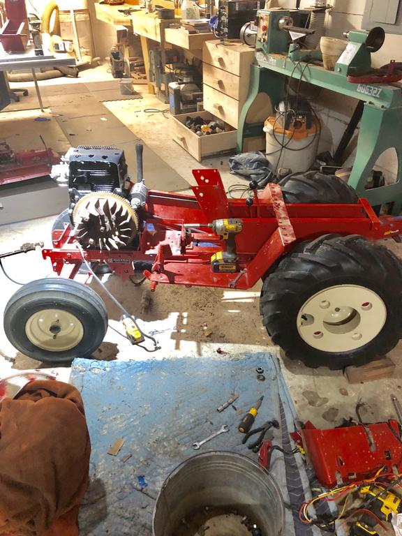

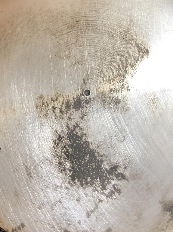

The Tuul Crib 7,340 #4 Posted October 28, 2019 (edited) I have started rebuilding a 12 horse to put on Irv because the 14 was smoking too much now I like bugs but this is a bit more smoke than I like. The 12 horse is coming along good but I just picked up these two 16. Horse motors and pulled the head off of the wheel horse motor. Found out it was 20 over which is OK. Looks like the cylinder still has hatch marks on it . Im hoping !So now I have changed my directions and I'm going to set the 16 horse on lRV. @pullstart hey Kevin this could be the start of the Trojan Horse!! Edited October 28, 2019 by The Tool Crib 2 1 Share this post Link to post Share on other sites

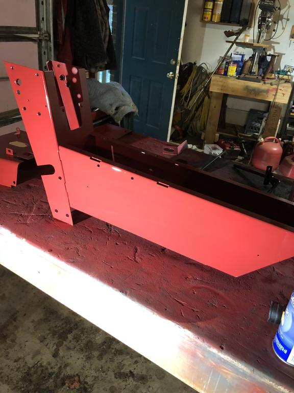

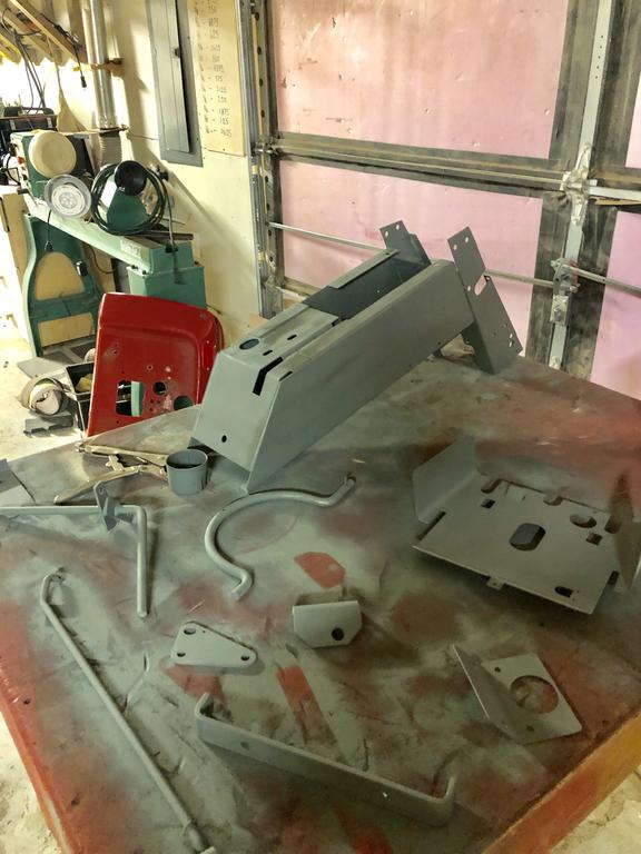

The Tuul Crib 7,340 #5 Posted November 9, 2019 So I pulled Irv into the shop this morning and started to dismantle. I'm upgrading the tower to except a new volt meter and a larger amp regulator. Plus I am putting the newer style PTO on it. Some of the parts left over from the eight horse no-name that I parted out . I also dropped on one of the 16 horse that I picked up after I went through the motor cleaned it up and honed the cylinder. The piston was a 20 over in it so this motor should have plenty of power. 1 1 Share this post Link to post Share on other sites
