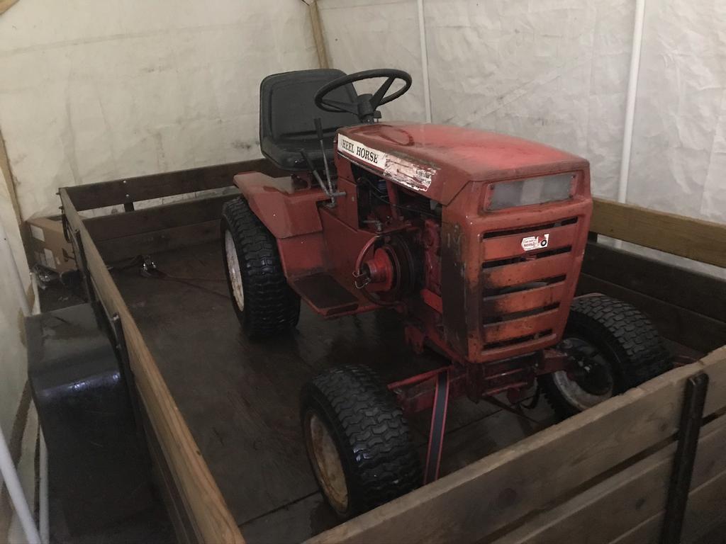

FAST 87 #1 Posted October 11, 2019 Is this a good tractor? Supposedly everything works on it. Thanks for any helpful advice. Share this post Link to post Share on other sites
ebinmaine 75,588 #2 Posted October 11, 2019 Absolutely. The C160 and C161 are among the most desirable in fact. 2 Share this post Link to post Share on other sites
FAST 87 #3 Posted October 11, 2019 Do they take the same attachments as a c141?or are they different? 1 Share this post Link to post Share on other sites
ebinmaine 75,588 #4 Posted October 11, 2019 Should be all the same. Same basic tractor. Different horsepower. 1 Share this post Link to post Share on other sites

FAST 87 #14 Posted October 13, 2019 I got it off the trailer today and looked it over briefly. It runs at idol really well but is idols up and down erratically when you throttle up and it wants to stall. So I have to figure that out. Needs a spring or something done with the brake lever. The back hitch thing was missing the spacers and the clips to hold it in place but I can fix that pretty easy. I messed my knee up somehow yesterday and had to spend the day with it elevated and use ice otherwise i would have messed with it more. Share this post Link to post Share on other sites
ebinmaine 75,588 #15 Posted October 13, 2019 Likely just needs a carb rebuild. New fuel lines. Simple stuff. Keep us posted. 2 Share this post Link to post Share on other sites
Guest 88vic #16 Posted October 13, 2019 There should be adjustments on the carb, you could make it smooth out possibly. Worse case scenario the carb needs dipped and cleaned along with a new fuel filter and maybe fuel lines if they are brittle. I got a c-161 about a year ago, brought it home and tucked it away in the corner of the garage. The other 16 wheel horses have kept me busy, havent tinkered with it at all. Your post here may have made me put it on the fast track to check it out. Share this post Link to post Share on other sites
FAST 87 #17 Posted October 13, 2019 10 hours ago, WHEELHORSEFAN*16 said: There should be adjustments on the carb, you could make it smooth out possibly. Worse case scenario the carb needs dipped and cleaned along with a new fuel filter and maybe fuel lines if they are brittle. I got a c-161 about a year ago, brought it home and tucked it away in the corner of the garage. The other 16 wheel horses have kept me busy, havent tinkered with it at all. Your post here may have made me put it on the fast track to check it out. Yeah I tried to just adjust the carb and that did nothing so I’m going to have to go deeper. I want to change all the fluids and filter also. Hopefully today I can. The guy I got it from was going to redo the tractor so he started scrapping a couple of the stickers off and a couple other things so I may have to try and find those maybe. I love these older tractors and don’t mind if the paint is dull. The guy also messed with the points so I will make sure those are set right. And it seems the governor may need to be set again or something because it just bogs down going up trailer ramps instead of throttling up to keep the same speed. Thanks for the help and ideas to all. 1 Share this post Link to post Share on other sites
ebinmaine 75,588 #18 Posted October 13, 2019 8 minutes ago, FAST said: stickers @Vinylguy can help you out with that 9 minutes ago, FAST said: governor may need to be set again Be sure to do the points and rebuild the carb first. Also change ALL the fuel line. Bogging down can be a fuel issue as well. Glad to see that tractor in the hands of someone who will do right by it. 3 Share this post Link to post Share on other sites
FAST 87 #19 Posted October 14, 2019 11 hours ago, ebinmaine said: @Vinylguy can help you out with that Be sure to do the points and rebuild the carb first. Also change ALL the fuel line. Bogging down can be a fuel issue as well. Glad to see that tractor in the hands of someone who will do right by it. Thank you for the info on the decal kits. Very helpful. 1 Share this post Link to post Share on other sites
ZXT 2,401 #20 Posted October 14, 2019 12 hours ago, ebinmaine said: Be sure to do the points and rebuild the carb first. Also change ALL the fuel line. Bogging down can be a fuel issue as well. If the governor hasn't been messed with, don't. It more than likely doesn't need it. Pull the carb off and spray out all of the passages. If any of them are clogged, torch tip cleaners are extremely helpful in getting through blockages. If it isn't getting enough fuel to throttle up under 0 load, it certainly isn't going to have enough fuel at idle with a load on it. 2 Share this post Link to post Share on other sites
