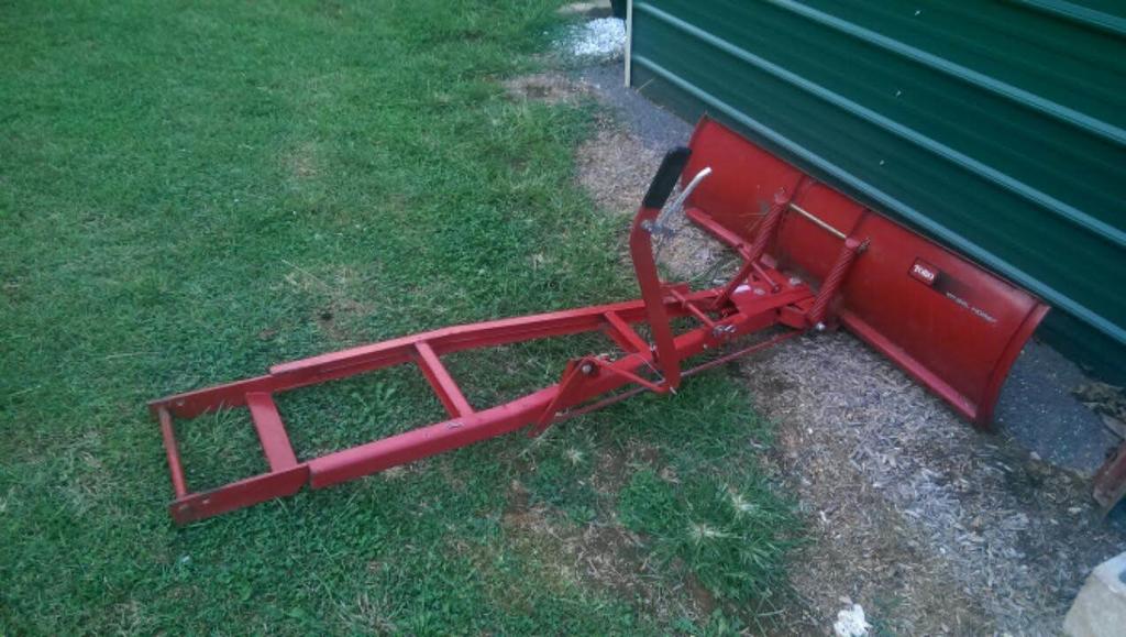

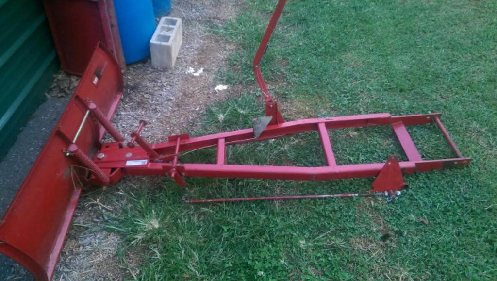

953 nut 64,940 #12 Posted October 14, 2019 Your heading is 50" Mid-Mount. Is this a picture of what you are talking about? Share this post Link to post Share on other sites
