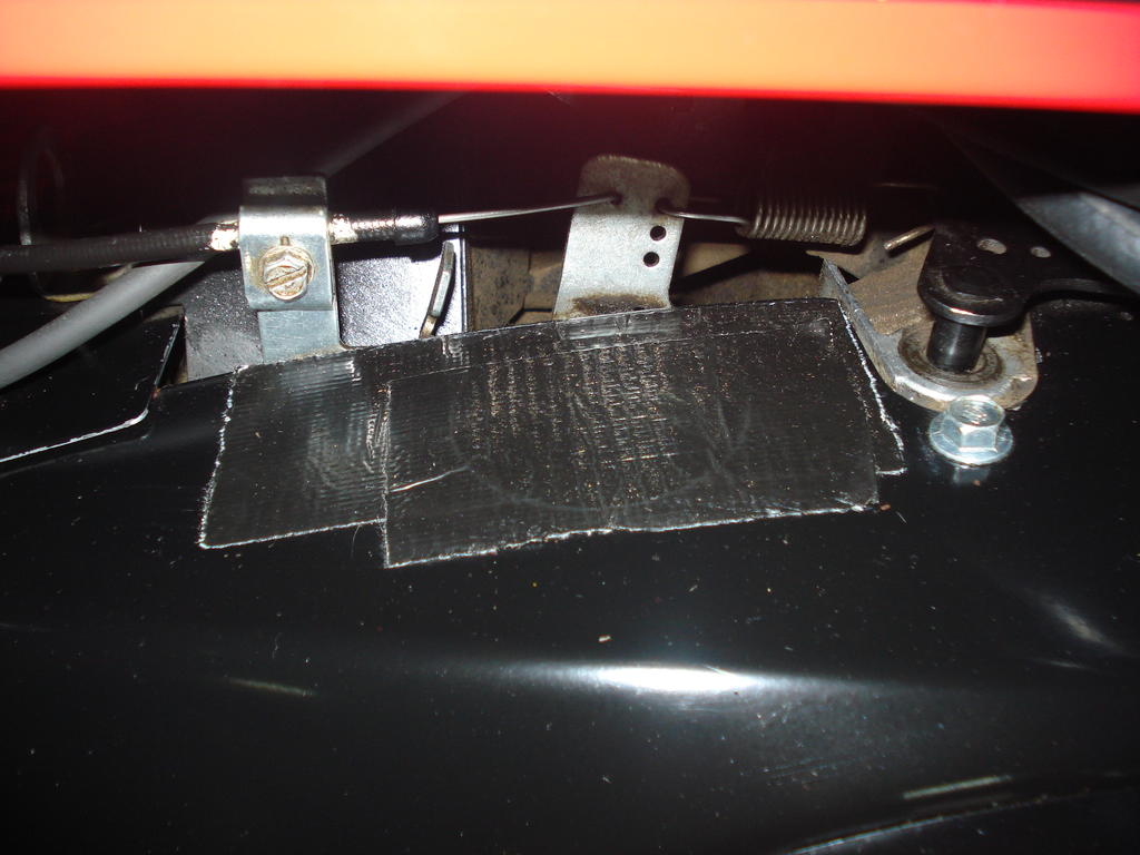

Greentored 3,220 #25 Posted December 19, 2019 Resurrecting the dead here, sorry. Brand new member here and my very first technical post yesterday was on this same exact subject, then stumbled on this thread this morning. Glad to know it can be blocked off- I want to push every bit of air across the fins as possible, maybe this will help a bit. Joe M, killer job on that shaker, it looks factory, love it!! 1 Share this post Link to post Share on other sites
