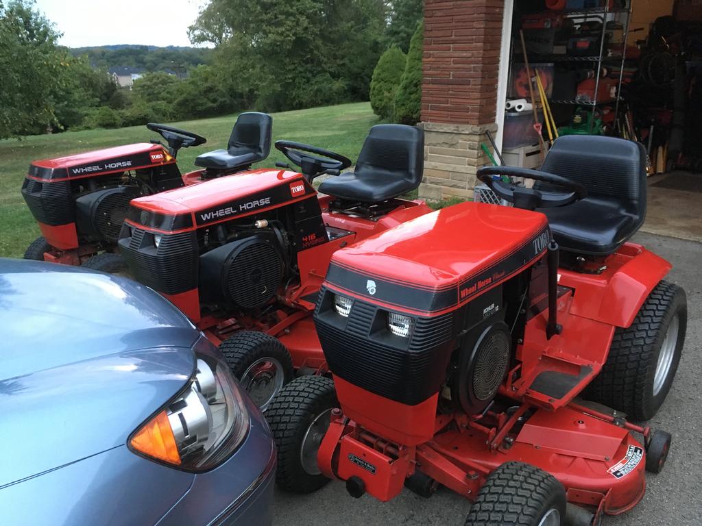

tom2p 2,396 #9 Posted October 11, 2019 (edited) The hoods on the tractors on the ends are original paint - and were not pampered. Wiped the hoods with WD-40 to remove any gunk - and then a quick application of Mother's mag wheel polish brought them back to life. Hood on the middle tractor was repainted. Looked good - but did have some orange peel. Used Mother's mag wheel polish to reduce the orange peel and improve the shine. Edited October 11, 2019 by tom2p 3 3 1 Share this post Link to post Share on other sites
troutbum70 858 #10 Posted October 11, 2019 Great looking herd Share this post Link to post Share on other sites
wfrpalm 218 #11 Posted October 11, 2019 Those are nice looking tractors. Share this post Link to post Share on other sites
