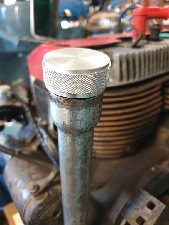

Mickwhitt 5,259 #1 Posted October 10, 2019 Hi all, I made a new oil dip stick top for my Kohler. Simple turning job but it looks good, two O ring seals and a knurled knob. 6 7 1 Share this post Link to post Share on other sites

peter lena 9,951 #5 Posted October 10, 2019 mickwhitt , nice work on that , any build details on it? thank you , pete Share this post Link to post Share on other sites
Mickwhitt 5,259 #6 Posted October 10, 2019 It was a quick lathe job, nothing special. I bonded the old stick into my new cap with JB weld rapid. 2 Share this post Link to post Share on other sites

McGrew 461 #8 Posted October 10, 2019 Beautiful Mick! I love the knurling. Mine never comes out that clean. Danny Share this post Link to post Share on other sites
Mickwhitt 5,259 #9 Posted October 10, 2019 Lots of WD 40 with aluminium, make sure all swarf washed away. Or use compressed air to blow the wheels clean. 1 Share this post Link to post Share on other sites
