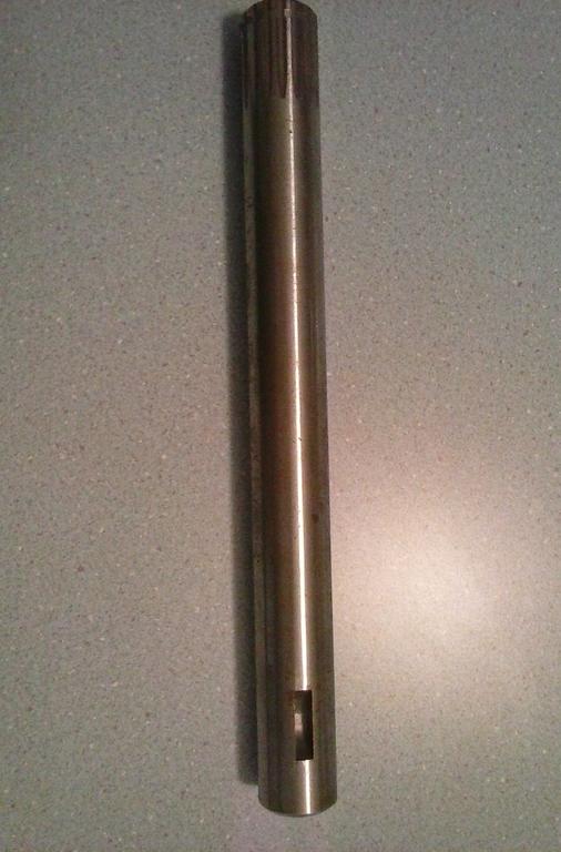

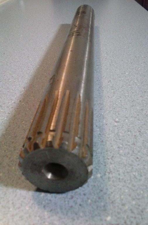

76c12091520h 3,291 #1 Posted October 10, 2019 Need help identifying the application for this axle, part # is 101511 / 121384 ? 1 1/8 dia 11 1/4" long. Thanks in advance! Share this post Link to post Share on other sites
gwest_ca-(File Mod) 10,498 #2 Posted October 10, 2019 Getting harder to determine where parts originated but found this one. Axle 7202 was also replaced by 121384 Click on each fuzzy picture and scroll down each page to see where they were used - list of tractor models at the bottom of each page. Garry Share this post Link to post Share on other sites
stevasaurus 22,230 #3 Posted October 10, 2019 That is the short axle that is used in the #5060 transmissions (10 pinion Limited Slip differentials). Share this post Link to post Share on other sites
