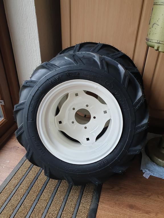

Mickwhitt 5,168 #11 Posted October 13, 2019 https://www.bigtyres.co.uk/23x8-50-12-6-ply-bkt-tr-315-tl-not-bobcat.html So a pair of these would fit the existing rims, save modifying them. Share this post Link to post Share on other sites
Mickwhitt 5,168 #12 Posted October 14, 2019 Ordered my new tyres, rims in for shot cleaning and refinishing. Going to look one smart horsey. Mick Share this post Link to post Share on other sites
Mickwhitt 5,168 #13 Posted October 19, 2019 The tyres and rims are back from powder coating so I'm really happy with them. Now need to find front wheel rims to take a tri rib tyre and fit the new hubs I'm going to fit. 4 Share this post Link to post Share on other sites

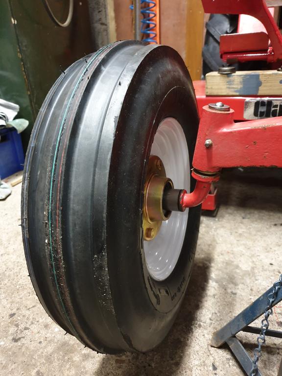

Mickwhitt 5,168 #15 Posted October 20, 2019 Hi skipper. The stub axles are 3/4 inch so I'm going to sleeve them. I think I've found wheels and tyres that will all fit just fine. As soon as they all come in I will be doing the machining and fitting. Mick Share this post Link to post Share on other sites

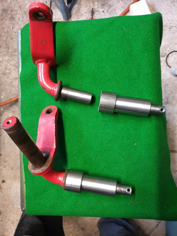

Mickwhitt 5,168 #16 Posted October 25, 2019 I bought a pair of commercially available stub axles and cut them down, boring them to 3/4 inch to take the original axle inside. I'm going to bond them on initially with bearing adhesive rather than weld them and risk softening the metal. May cross drill and pin too but that might be a bit over the top. 3 Share this post Link to post Share on other sites
Stormin 9,985 #17 Posted October 25, 2019 Look like the ones I've used on the Black Horse and C-125, Mick. I welded them and have had no adverse effect. Share this post Link to post Share on other sites

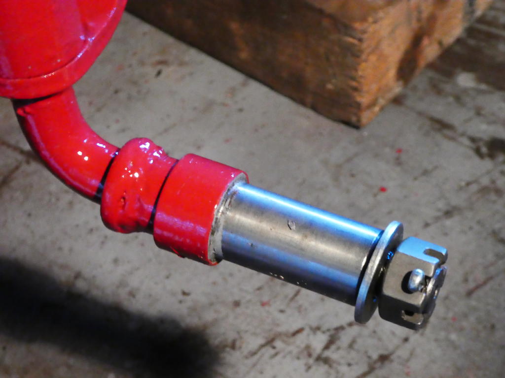

Mickwhitt 5,168 #19 Posted October 25, 2019 Both front axles done now, not a long job but repetitive with all the boring out to size. I used high strength engineering adhesive to bond the two together. Shoukd not be a problem as all the rotation force will be absorbed by the wheel bearings. Looking better than I could have wished for. 1 Share this post Link to post Share on other sites

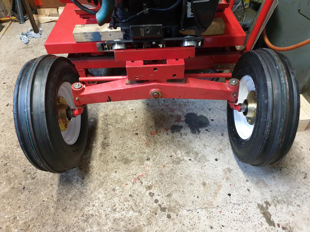

Stormin 9,985 #20 Posted October 25, 2019 Looking at the photo's, Mick, you look to have narrowed the track a bit. Just comparing your stub axles with mine. Only an inch though. Share this post Link to post Share on other sites

Mickwhitt 5,168 #22 Posted October 25, 2019 The track width was something I wasnt sure about. Obviously it had turf tyres on before which were much wider. So I wasnt sure where to measure for an idea of how long to cut the axles. I will see how it performs and I can always alter things in future if necessary. I saw your modification Lee and took inspiration from you and Stormin to get on with mine. The amount of rain we ate having here in the uk I might have to change to flotation tyres. 1 Share this post Link to post Share on other sites
