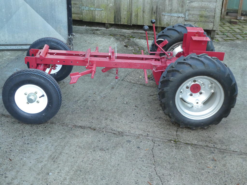

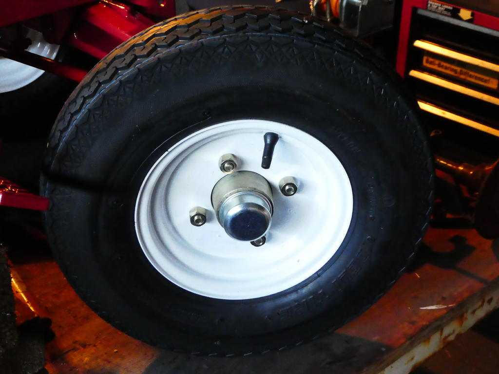

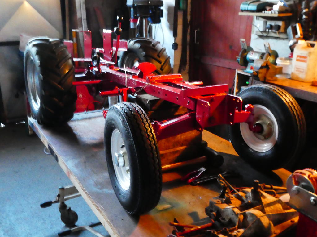

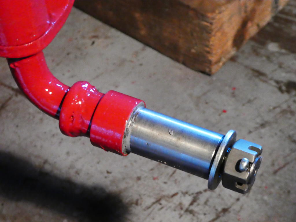

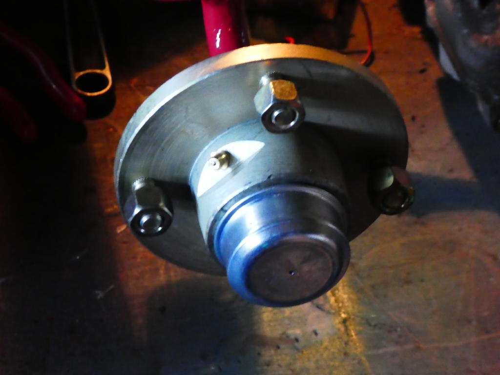

Stormin 9,988 #28 Posted November 26, 2018 Original tyres and wheel bearings were past their sell by date. So into Carlisle for replacements. Take two modified wheel spindles made a while ago. Two trailer hubs. Two trailer wheels and tyres. Looking good. Back on all fours. Only £50 more than new turf tyres and wheel bearings. 2 6 1 Share this post Link to post Share on other sites

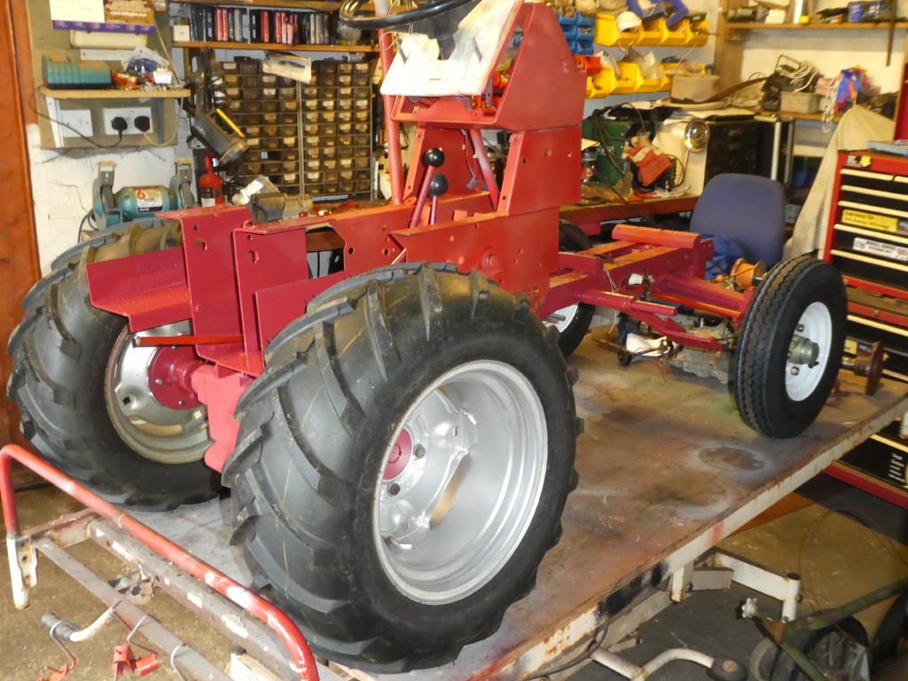

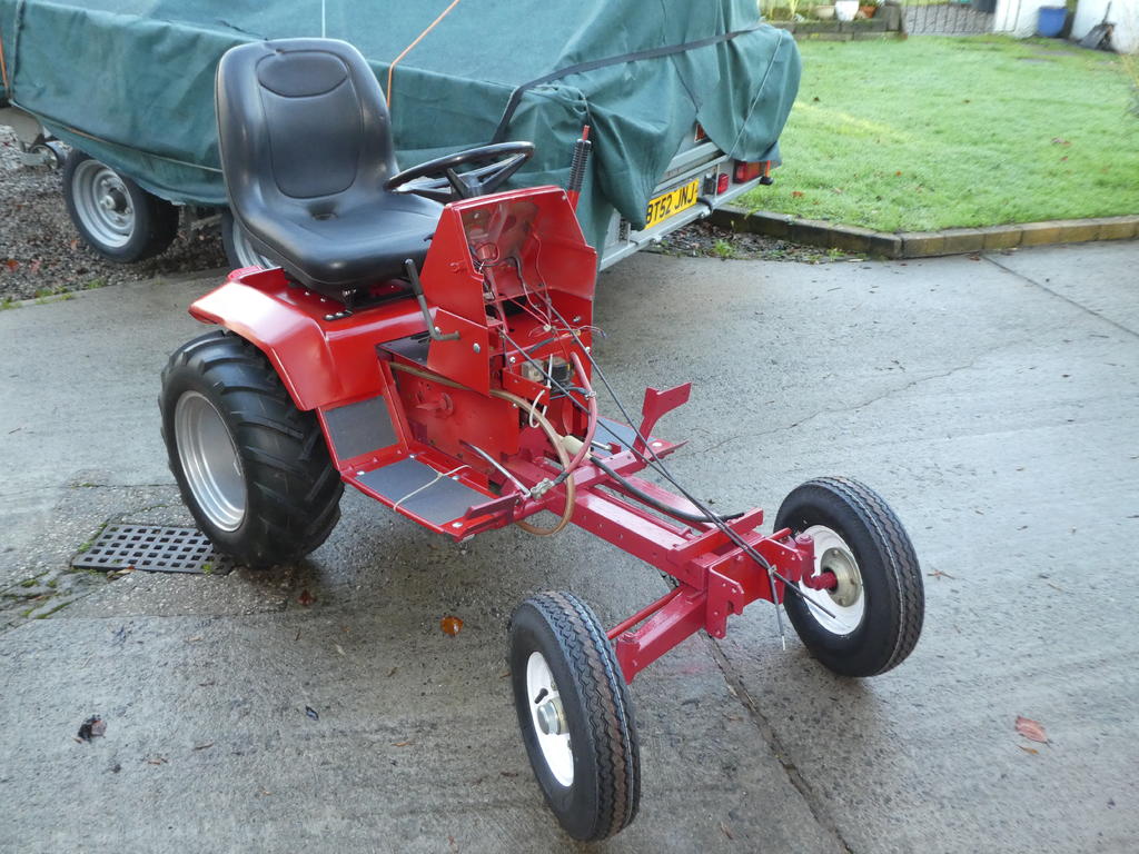

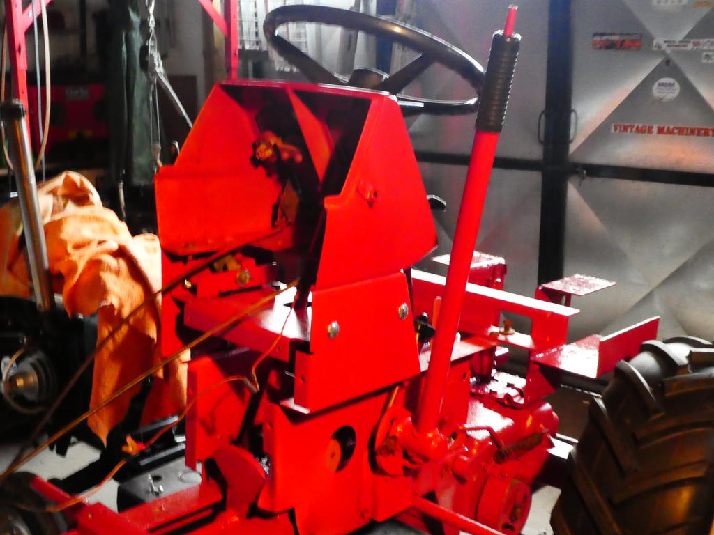

Stormin 9,988 #29 Posted November 28, 2018 Got the bottom and top of the tower painted and on today. Assembled just to see how things looked. The external panels will be sprayed again as the weather turned humid and damp. Not to say windy. Rather wild with 60-70mph gusts. Back up on the bench. Saves the old back. Assembled clutch, handbrake and lift mechanism. Back to cleaning up and prepping, ready for painting when the weather is more convivial. 2 3 Share this post Link to post Share on other sites

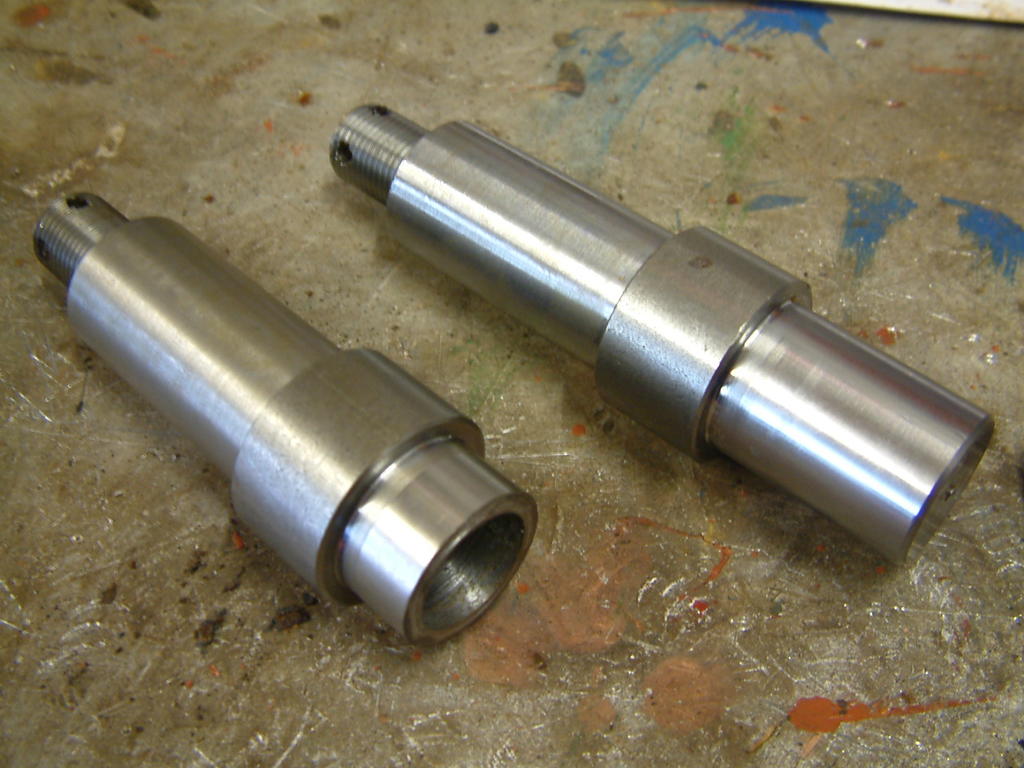

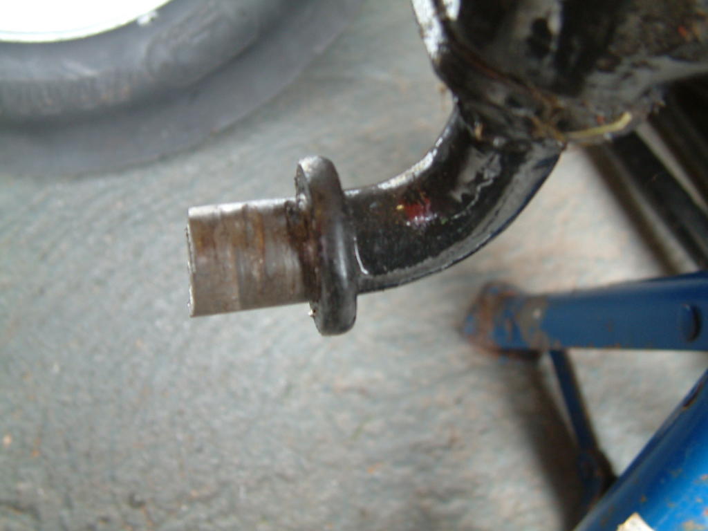

Tractorhead 9,217 #32 Posted November 28, 2018 Wich wheelspindles you're using for front axle? Looks pretty nice Share this post Link to post Share on other sites
Achto 32,795 #33 Posted November 28, 2018 1 hour ago, WHX21 said: Hey Dan @Achto can I paint your Blachhood with a brush?!? I was gonna use a broom like I normally do, but I guess I could let you give it a try with a brush. 1 3 Share this post Link to post Share on other sites
Stormin 9,988 #34 Posted November 28, 2018 (edited) 1 hour ago, Tractorhead said: Wich wheelspindles you're using for front axle? Looks pretty nice The steering arms spindles were cut down to 3/4". Then a pair of trailer wheel spindles modified as shown on the left. Cut off spindle inserted in the end and welded. Trailer spindles and hubs source from a company here in England called.....Indespension. Edited November 28, 2018 by Stormin 2 5 1 Share this post Link to post Share on other sites

Tractorhead 9,217 #36 Posted November 29, 2018 (edited) Hi Stormin, thanks for Info. Edited November 29, 2018 by Tractorhead Changed name -sorry Share this post Link to post Share on other sites
stevasaurus 23,857 #37 Posted November 29, 2018 That is looking really nice Norm. My 702 is fitted with trailer bearings, rims and tires...not quite the way yours is, but it works great. 1 Share this post Link to post Share on other sites

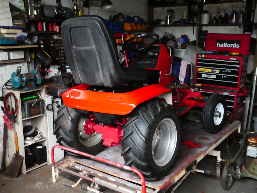

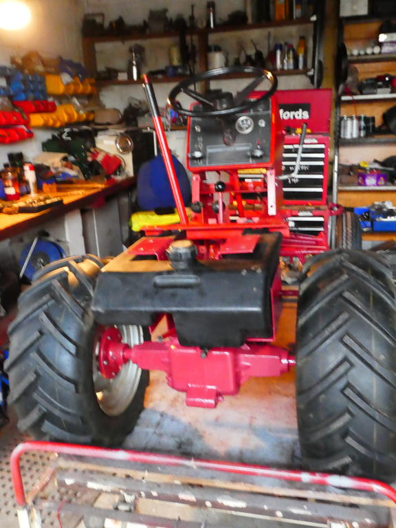

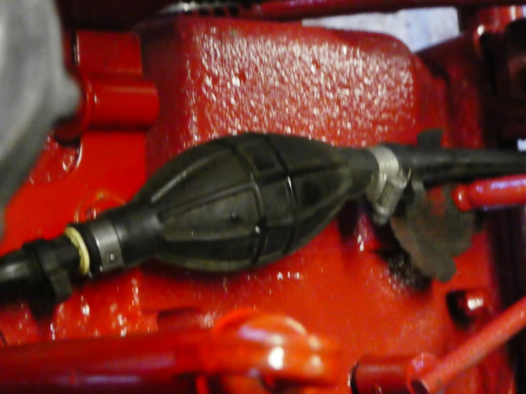

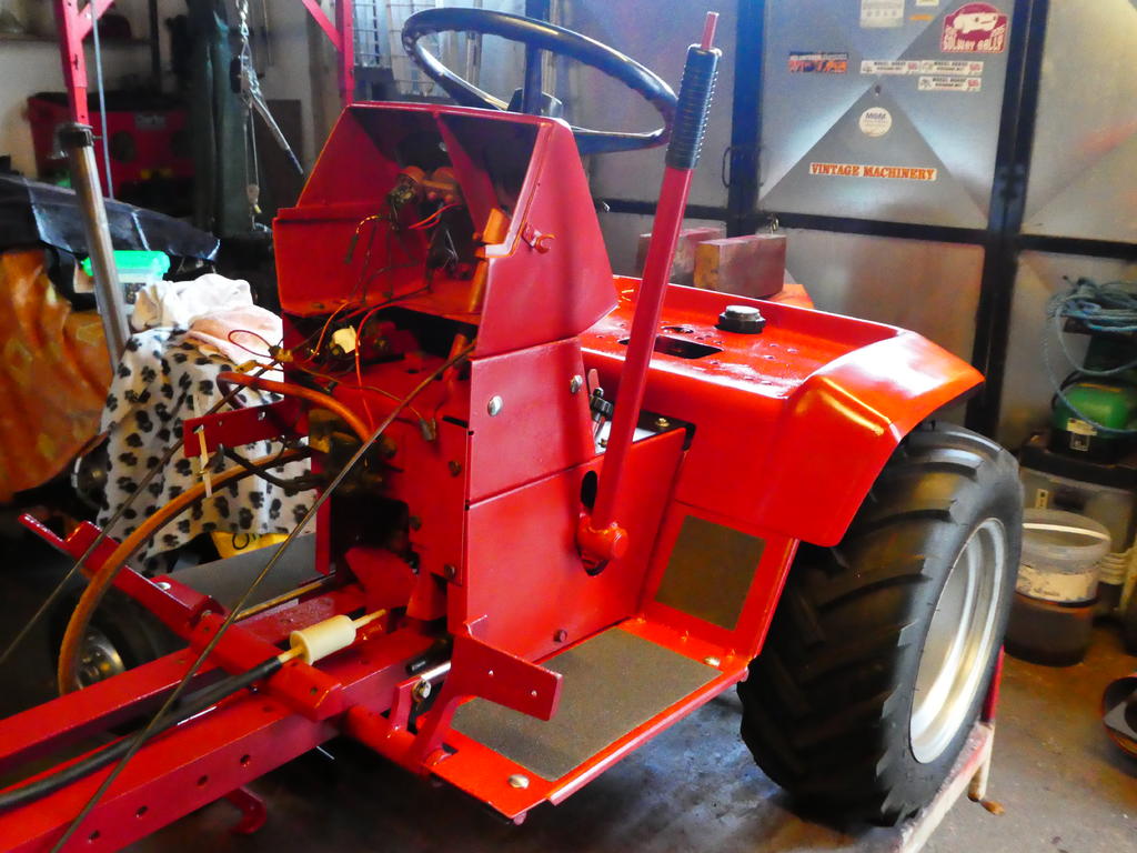

Stormin 9,988 #38 Posted November 30, 2018 Got the tower, pto lever, fuel tank and some of the smaller bits fitted today. Also got most of the remaining small parts painted. Below is a shot of the boat engine primer bulb I fitted to help starting when left idle for a while. It's accessed through a hole in the fender under the seat. And yes. I need a new gaiter for the gear lever. 8 Share this post Link to post Share on other sites

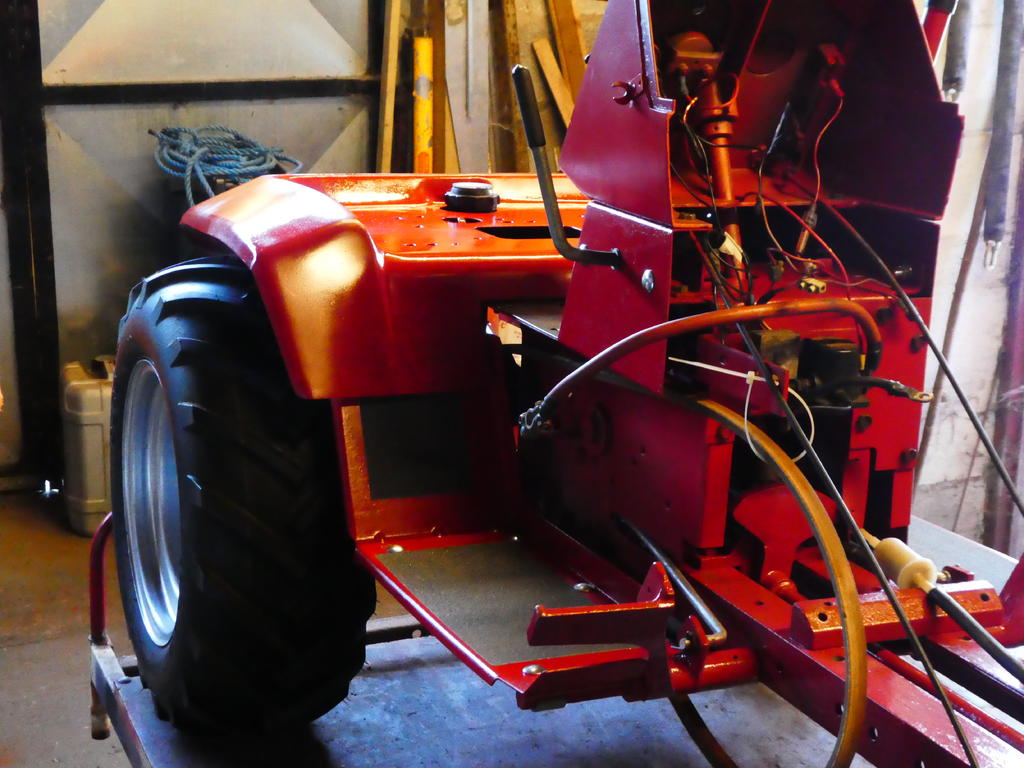

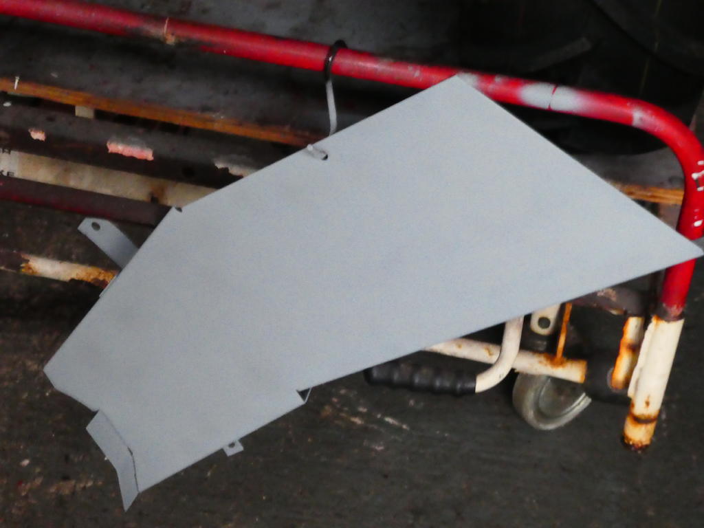

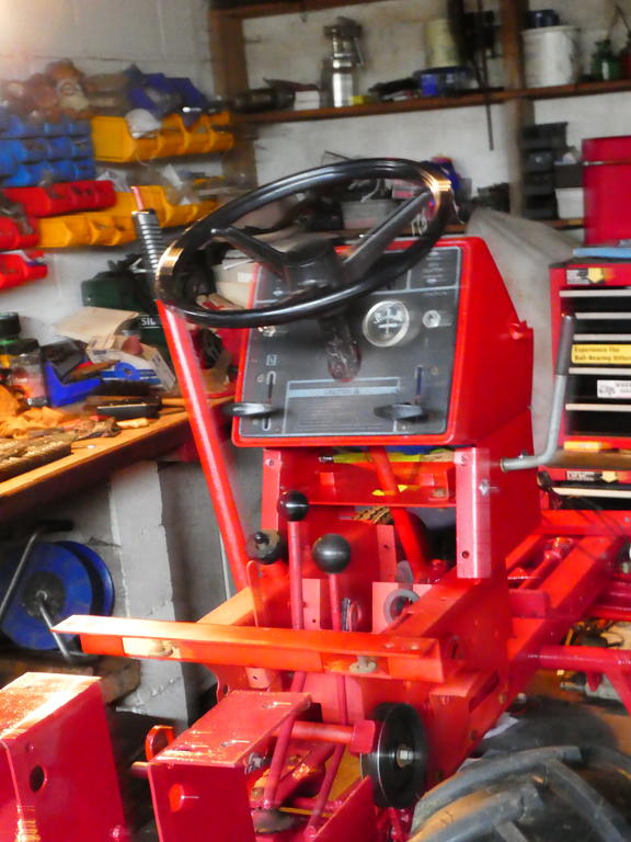

Stormin 9,988 #39 Posted December 6, 2018 Between putting up Christmas lights, I managed to get a bit more painting today. Just three coats of primer. Hopefully topcoat tomorrow. Only footplates, Drive belt guard and fender. I think the footplate on the right will be getting a touch of filler. Should have done it before. In to the kitchen to fully dry overnight. 7 1 Share this post Link to post Share on other sites

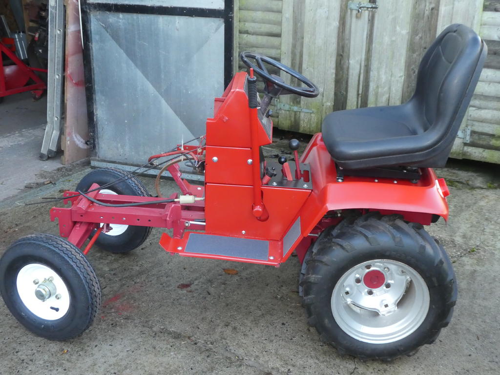

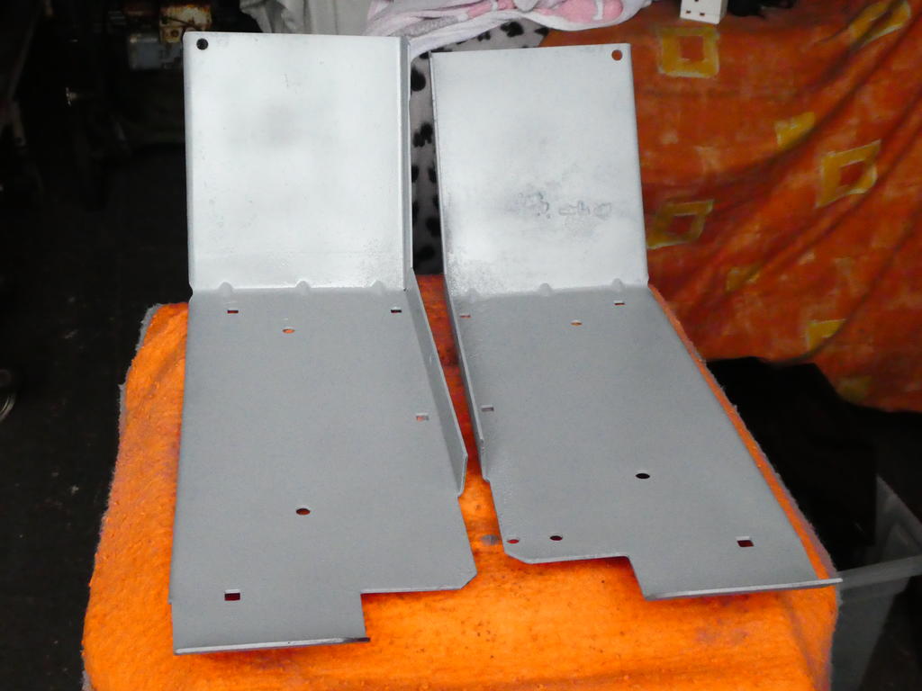

Stormin 9,988 #40 Posted December 7, 2018 Three coats of top coat to fender and footplates. Also some skate board grippy applied to the footplates. Footplates also mounted on tractor. Remembered to put the drive belt on, so I don't have to take things off to fit it. I know there's a bit of difference in paint tones, but I couldn't get spray cans in an exact match. But hey! Who cares. Two tone's good. Seat base and brackets are primed as well. Had fun with the split pins holding the spring thing's. Seized solid and snapped off and one of the springs has escaped to hide somewhere in the workshop. 5 1 1 Share this post Link to post Share on other sites

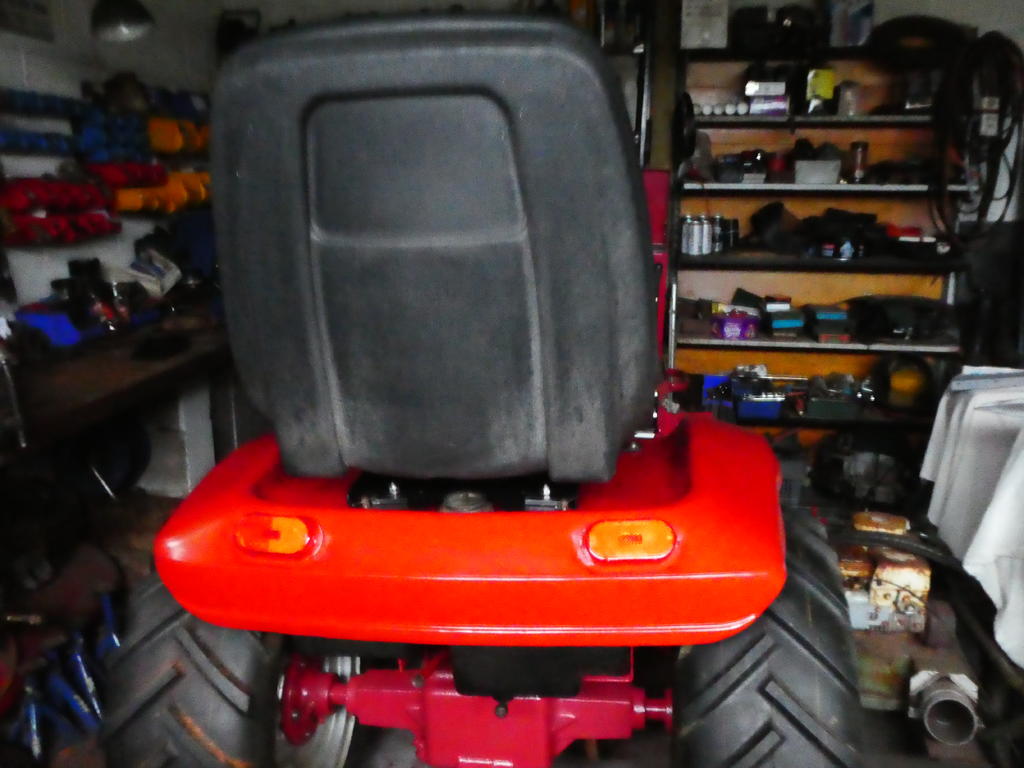

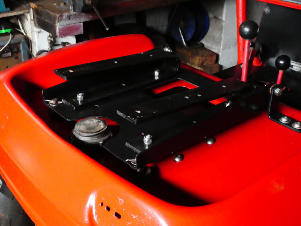

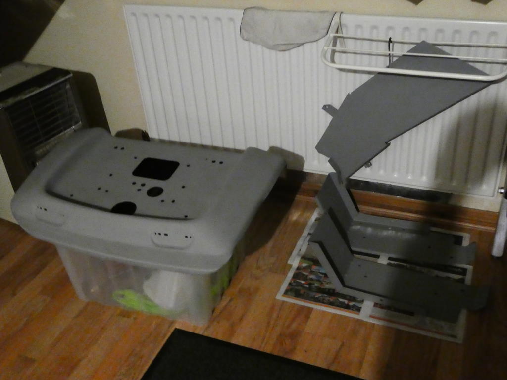

Stormin 9,988 #45 Posted December 8, 2018 (edited) Starting to look like something now. Seat base painted and fitted. High back seat that originally came on the Black Horse. Cleaned up not bad after a wipe with white spirit. After this photo was taken. Pair of rear lights that have been on the parts shelf for a few years. I'll wire them up when I do the wiring. Edited December 8, 2018 by Stormin 6 Share this post Link to post Share on other sites

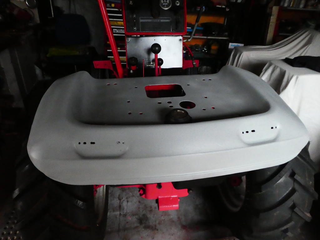

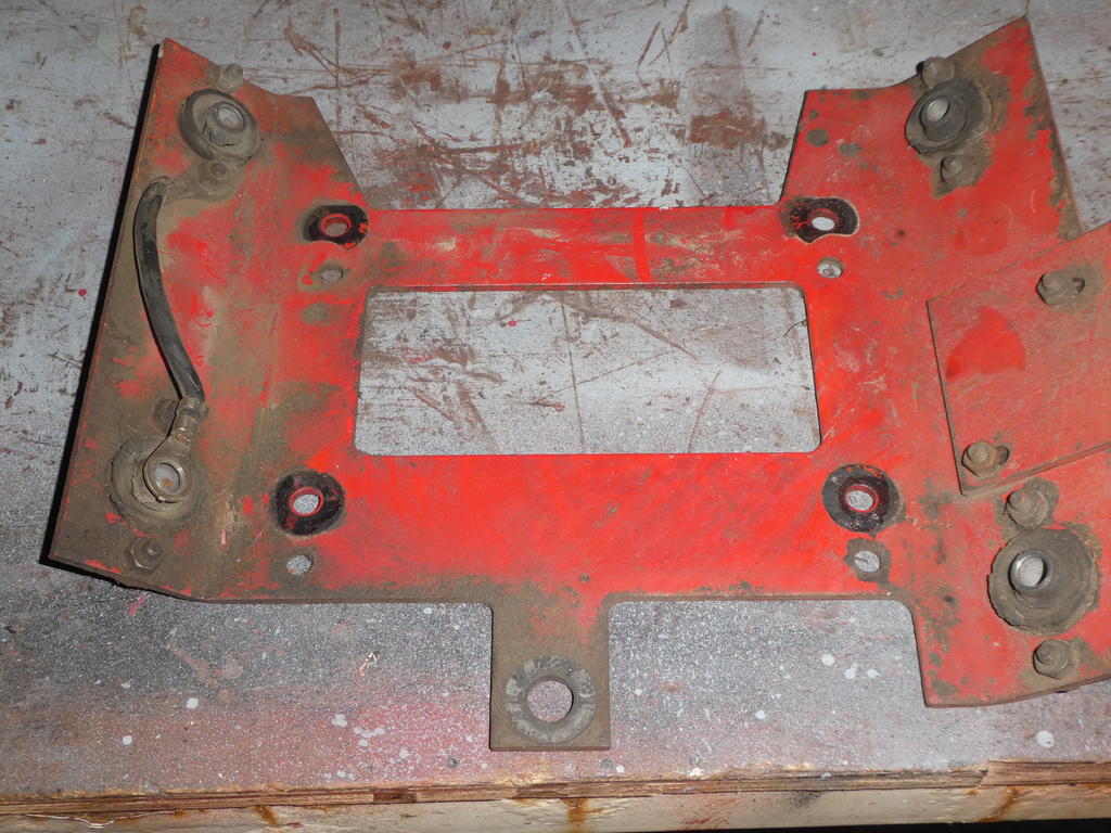

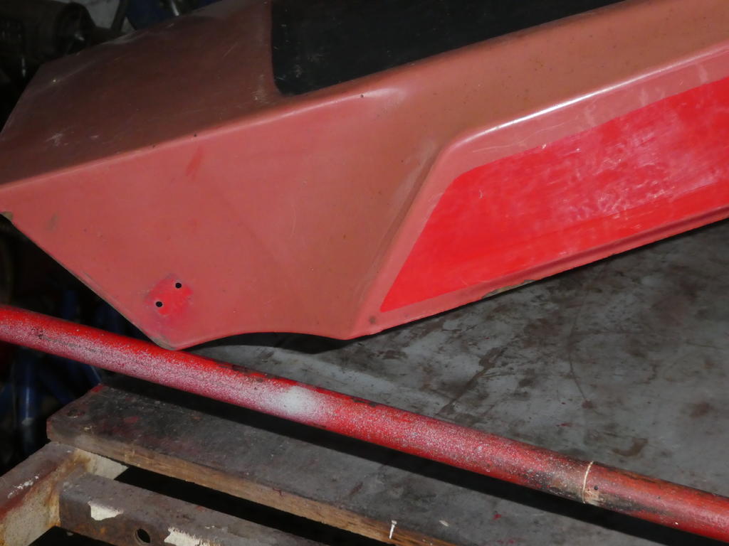

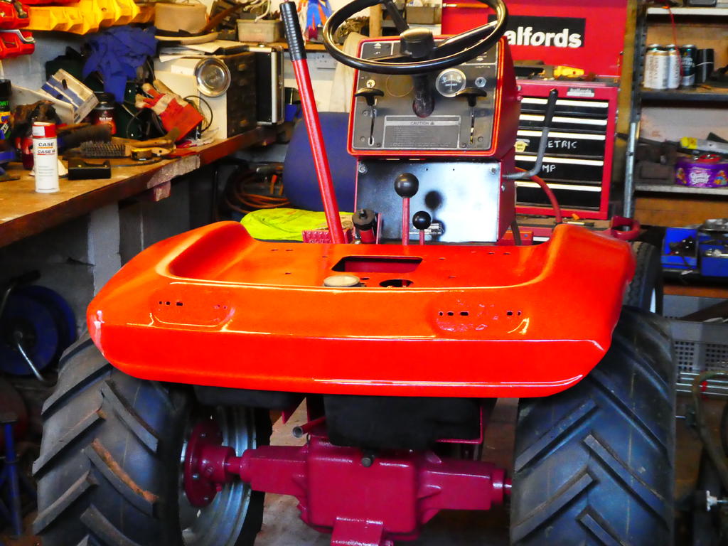

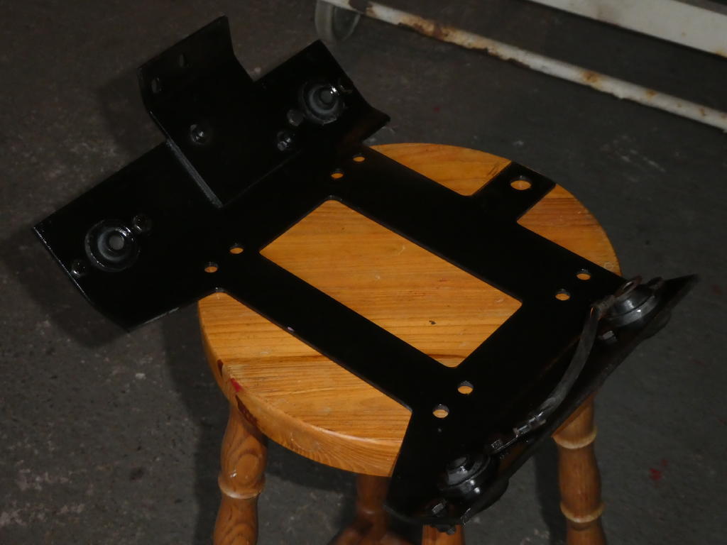

Stormin 9,988 #47 Posted December 9, 2018 (edited) Progress today. Got it off the bench and took some photo's outside. After a clean up in the workshop, (I still not found the elusive spring) I turned my attention to the antivibration engine plate. Cleaned it up and got it primed and top coated. Next the bonnet/hood got my attention. Borrowing SWMBO's hairdryer I removed the stickers from the sides. That was followed by a good going over with turpentine substitute, then a rub down with emery cloth. The photo' below shows how much the paint has faded over the last 36 years. That was all today as it was getting a bit nippy. Edited December 9, 2018 by Stormin 6 2 Share this post Link to post Share on other sites

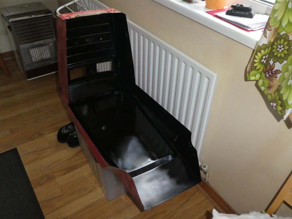

Stormin 9,988 #50 Posted December 10, 2018 Rather cold and damp today, but working between workshop and kitchen I got the underneath of the bonnet painted. Bonnet into kitchen to warm up, paint in hot water, outside to spray, into kitchen to dry. Repeat five times. 2 Share this post Link to post Share on other sites
