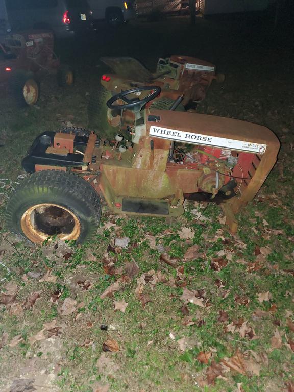

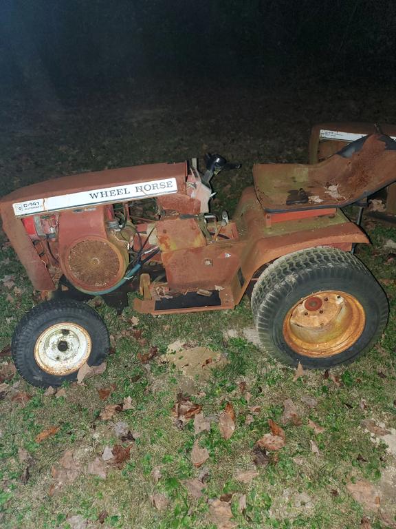

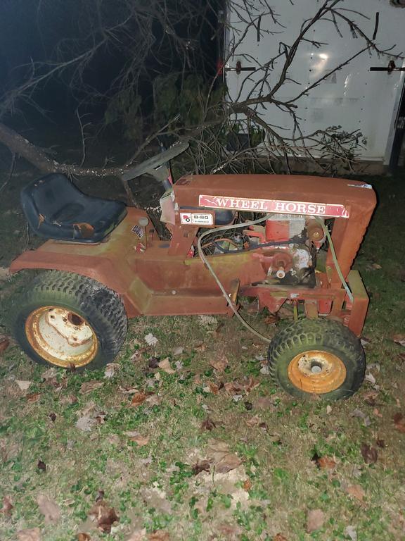

Lost.soul.collecter 76 #29 Posted October 11, 2019 22 hours ago, ZXT said: We're glad to have you! All of the tractors you've picked up are very good workers. I grew up around a C-141 and still have it. Definitely jealous of all the freebies you're finding! We'd love to see pictures of them when you get a chance.. We like them even if they're ugly! Here is the pictures of my other 3 like I said they need alot of work but the motors are not locked up and the shifters all move so will see in time 3 1 Share this post Link to post Share on other sites
ZXT 2,401 #30 Posted October 11, 2019 9 hours ago, Lost.soul.collecter said: Here is the pictures of my other 3 like I said they need alot of work but the motors are not locked up and the shifters all move so will see in time Very cool! Looks like if you found a couple seats, wheels and a seat pan you'd have three complete tractors. Looks like the B-80 is all there. If you aren't familiar with the hydro tractors, there is a valve on the C-141 that you open to allow it to freewheel so that you can push it. Pushing it with the valve closed will damage the hydro. The valve is located on the LH side of the tractor, up under the seat pan near the front of the rear wheel. 1 Share this post Link to post Share on other sites

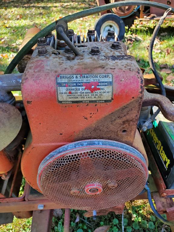

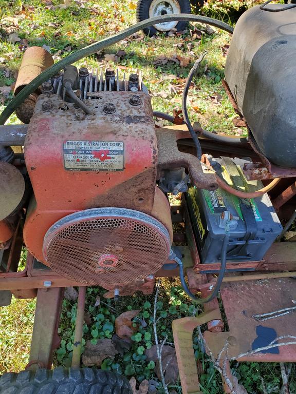

Lost.soul.collecter 76 #40 Posted October 12, 2019 15 hours ago, Lost.soul.collecter said: To be honest I'm I'm not sure a friend to me that the starter generator was missing I will see if I can get a better pick of the motor area tomorrow and post for all I know it might not be the original motor I'm new to these mowers but I want to try to do them right and put back to all original like they was so any help I can get I'm open for Here is pictures of the motor it's on the B•80 Share this post Link to post Share on other sites
Retired Wrencher 6,613 #41 Posted October 14, 2019 L L Colector I can not belive some people fabricate a part inside the engine and it would cost 3000 dollars. Glade you put some time on it to get it running. Enjoy it. Share this post Link to post Share on other sites
ZXT 2,401 #42 Posted October 14, 2019 On 10/12/2019 at 2:43 PM, Lost.soul.collecter said: Here is pictures of the motor it's on the B•80 I should've looked at the picture you posted of it the other day closer. From the factory it would've had an 8HP Kohler on it. Looks like someone swapped that Briggs on it. Yes, you will need a starter generator to get that engine up and going. 1 Share this post Link to post Share on other sites
