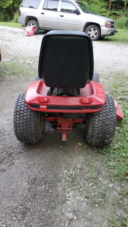

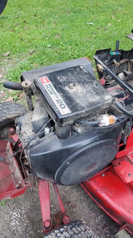

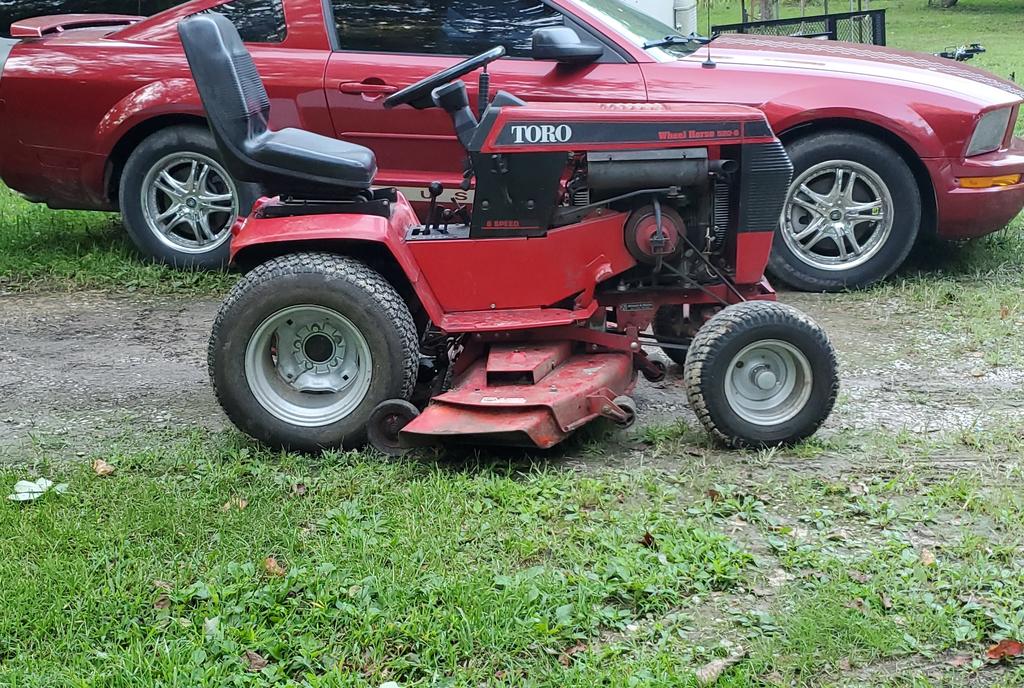

Lost.soul.collecter 76 #1 Posted October 9, 2019 (edited) I'm new to the Wheel Horses and never owned one I started to fix mower on the side and resale them to make extra money and one day I got a message from a guy that said he had a wheel horse mower if I come pick it up I can have it so I asked the story on it and they said it stopped running and they took it to a shop and they told them due to them not making them know more they would have to fabricate a part inside the engine and it would cost 3000 dollars they said know why so I ended up picking it up and the next day I went out turned the motor over by hand it had compression so I drained to 3 year old gas , replaced fuses , and cleaned all the wires up put new gas in and a new fuel filter charged the oil and filter and put a new battery in it with hopes it would maybe start I turned to key and it turned over so I turned the fuel line on and sprayed a little carburetor cleaner down the carburetor and turned the key again and it fired right up and after riding it around my year I fell in love with it I just had to share my story with everyone Edited October 9, 2019 by Lost.soul.collecter Pictures of the free wheel horse I got 9 8 Share this post Link to post Share on other sites

Pullstart 71,520 #10 Posted October 9, 2019 @Lost.soul.collecter! What a great freebie! I’m not much a fan of the “late model” tractors, but if that thing plopped in my lap I sure would be! Don’t get me wrong... that’s a super capable machine as you know, it’s just not my classic cup of tea As you may know, that rear cylinder likes to clog with debris from mowing... part of regular (yearly?) maintenance should be pulling the tins and blowing all the debris out. That’ll keep that thumper cool and happy for a long time! 2 Share this post Link to post Share on other sites

peter lena 10,109 #14 Posted October 9, 2019 welcome to the site, all of the regulars here are asking why can,t that happen to me ? you are beyond lucky, ( buy a lotto ticket ) to say the least, your quick basic service and the fact that you did it says a lot about your thinking . agree with the rear cylinder debris cleaning , i would personally put some aeration holes in the back of that guard . if you don,t care for that model , with a slight buff up you will have a great start on trading / selling on to what you want , you are one lucky dude, pete 1 1 Share this post Link to post Share on other sites
