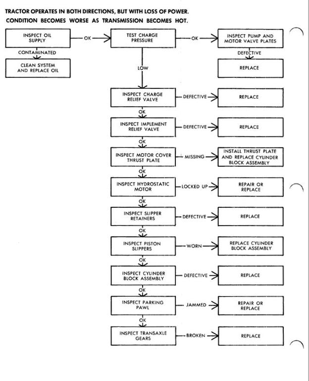

pfrederi 19,941 #2 Posted October 9, 2019 Probably internal wear... download this manual Share this post Link to post Share on other sites
daveoman1966 3,882 #3 Posted October 9, 2019 What you describe is classic symptoms of internal wear and the only resolution is to refurbish the internal parts in BOTH the hyd PUMP and the Hyd MOTOR (bolted to the transaxle). Internal brass components of each (pump & motor) are soft and get scored over the years from contaminated fluid (oil or ATF) common to both. While apart, its a good time to replace the 40+ year-old seals of the pump. Download the manual as suggested. The overhaul process isn't difficult... just be meticulous and keep parts CLEAN during reassembly using liberal amounts of engine assembly oil. I have rebuilt lots of these and can offer some help if needed. Share this post Link to post Share on other sites

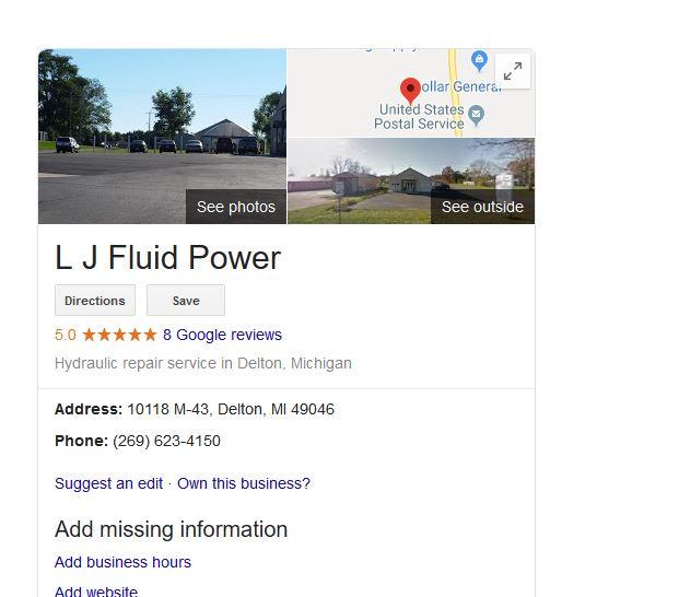

pfrederi 19,941 #5 Posted November 24, 2019 Not everything is still available but if it is these guys probably have it When WH stopped using Sunstrand they referred people to LJ Fluid Power. 1 Share this post Link to post Share on other sites
