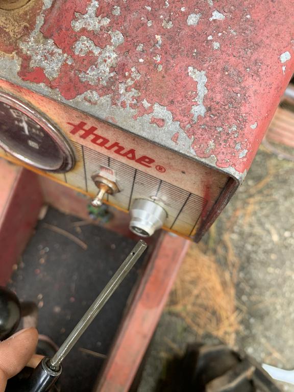

Crmaverick 91 #1 Posted October 8, 2019 I was using the 753 today and the throttle knob pulled right out (see pic) Does anyone know how to fix this or where I can buy a new cable? thanks 1 Share this post Link to post Share on other sites
stevasaurus 23,746 #2 Posted October 8, 2019 That is probably fixable if you take it apart. I think Glen Pettit sells them also. His E-Mail is around here some where. Share this post Link to post Share on other sites
WHX?? 57,399 #3 Posted October 8, 2019 Here you go buddy... http://www.psep.biz/store/toro_mower_cables.htm these are more like the smaller original style ones but not sure if they lock or not ..... https://www.kaiserwillys.com/engraved-throttle-cable-assembly-in-black-fits-46-66-cj-2a-3a-3b-5 2 1 Share this post Link to post Share on other sites
ClassicTractorProfessor 5,455 #4 Posted October 9, 2019 I bought mine as a set with both throttle and choke cables off eBay...reasonably priced and they work great. I’ll pm you the link Share this post Link to post Share on other sites
Crmaverick 91 #5 Posted October 9, 2019 I ended up ordering this before I saw the comments on here: https://rover.ebay.com/rover/0/0/0?mpre=https%3A%2F%2Fwww.ebay.com%2Fulk%2Fitm%2F291803875737 I think it should do the trick Thanks Share this post Link to post Share on other sites
WHX?? 57,399 #6 Posted October 9, 2019 Those should do just fine. If a little long you can cut the end off, pull the cable out and trim to length. Put the z bend back on with one of these. https://www.ebay.com/itm/RC-Z-bend-Pliers-Heavy-Duty-90deg-up-to-1-16/251620321694?hash=item3a95bd699e:g:pq4AAOSwpvZaA9S2 Share this post Link to post Share on other sites
